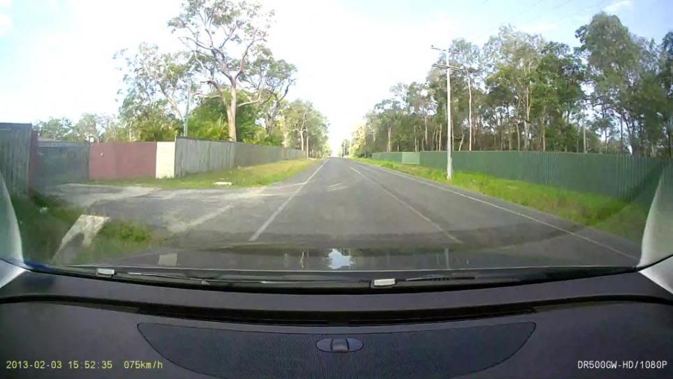

          Initial impression The lens is a much wider one than the 400 as can see bottom of A pillars in corner of image. would be at least 300mm wider on each side
          Gives slight fisheye effect as in a wide angle camera lens
          Quality is similar but the Magnifier is no where near as good as they show on the net.

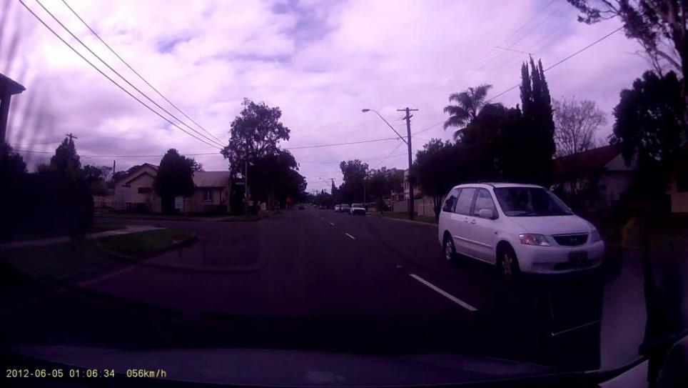

            This is the Blackvue HD 400G on a dark cloudy day still pretty good .

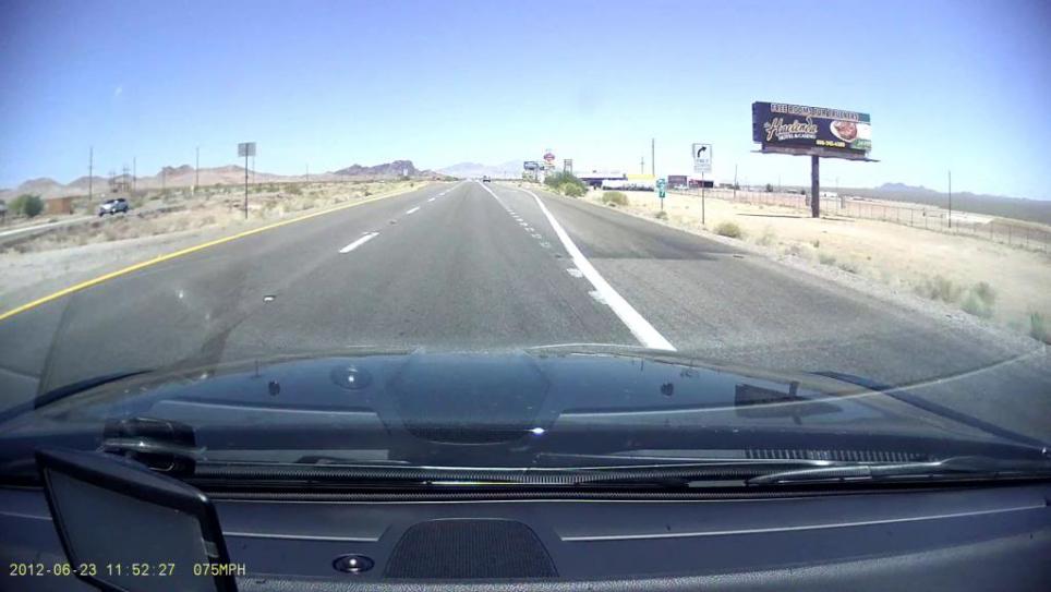

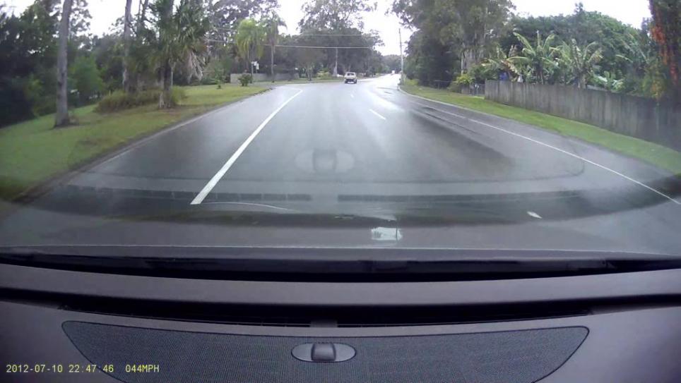

                Well dont know about that I would say your brightness needs to be set a lot higher.
                Here are two shots taken in different countries and different weather off mine
                Both on a DR400G and yes the speeds are correct I hadnt reset it when I came home
                This one in Arizona in a Chrysler 300 on a warm sunny day
                This one in Brisbane on an overcast wet day in my Passat
                This one for Transporter Done this Arvo in bright sunlight with the 500 Note the bottom ends of the A pillars in edge of pic in contrast to the narrower angle of the 400 in the above pic
