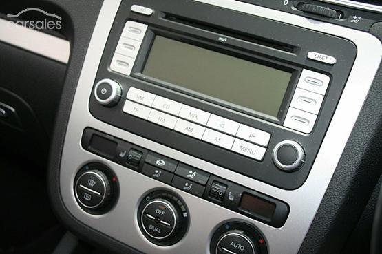

                OK, now I know you guys are good (Ryan?) what is this then?
                and can I put a RNS510 in there imstead?
                  That's an RCD-300 from a Golf 5 AFAIK. You can fit an RNS-510 but you may run into battery drain issues - all depends on what version CAN-Bus you have, take a look here:
                  TR 08 Golf GT TDI, Custom Code Phase 1, Milltek Exhaust, Whiteline RSB + ALK, APR Carbonio Intake
                    That is NOT RCD-300, that is RCD-500 6cd mp3 player
                      My mistake, didn't pay attention to the buttons. Either way, battery issues remain the same, you have to check your CAN-Bus if you want to fit an RNS-510.

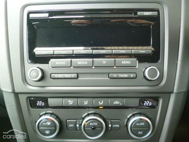

                          hey another question. Is it worth upgrading from the rcd500 to this (RCd310):
                          I'm thinking it might be a stepping stone to the rns510 as it's only $90 and I've got to save up for the rns
                            Is this the standard stereo on a mark 6 golf?
                            I would say no. A good stepping stone would be to upgrade to the rcd-510. These can be picked up for between $200 -$250. Pretty much look and function like the RNS-510, but without the sat nav and hard disk. It would also be easier to sell the rcd-510 when you are ready to upgrade to the sat nav.
