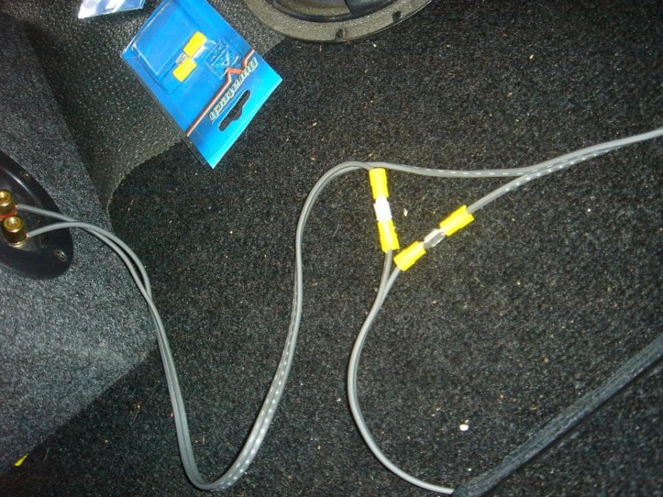

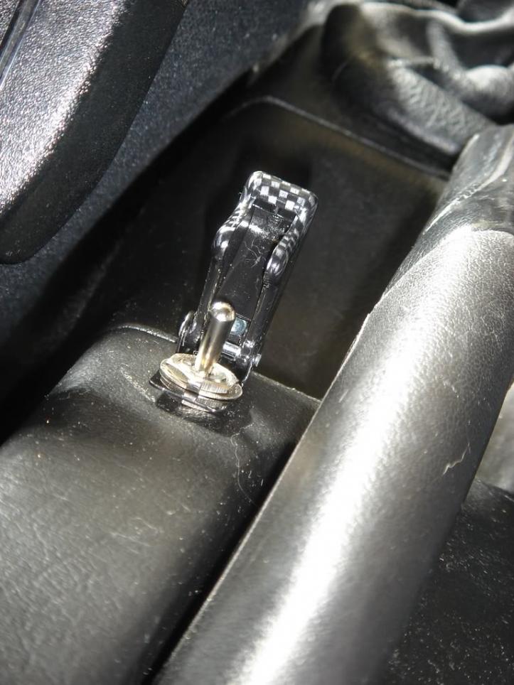

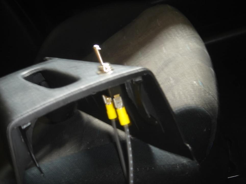

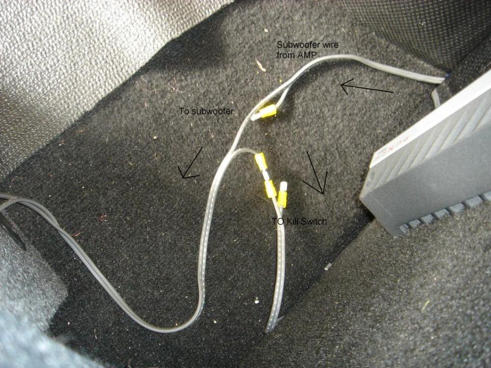

    Instructions:
    1. locate and cut +ve wire from Amp to subwoofer. (may not matter, personal preference.
    2. Insert 1 set of wire socket to cut wire and extended wire to kill switch. ( socket used for convenience, just incase kill switch dies--> plug and play again.)
    3. thread extended +ve under seat, carpet to kill switch location.
    4. drill hole, clip wire socket to kill switch, mount kill switch.
    5. put every thing back in place.

      How well is the swich coping with the current? Any noticible loss of sound quallity?

        The switch is coping well, haven't noticed any lost of quality and no delay when I flip it on ... the switch is an over kill from what I know handles 1000W and my amp only gives out 200W max. and subwoofer max at 300 W. Apart from that, what were you referrring to, you are scarring me.
