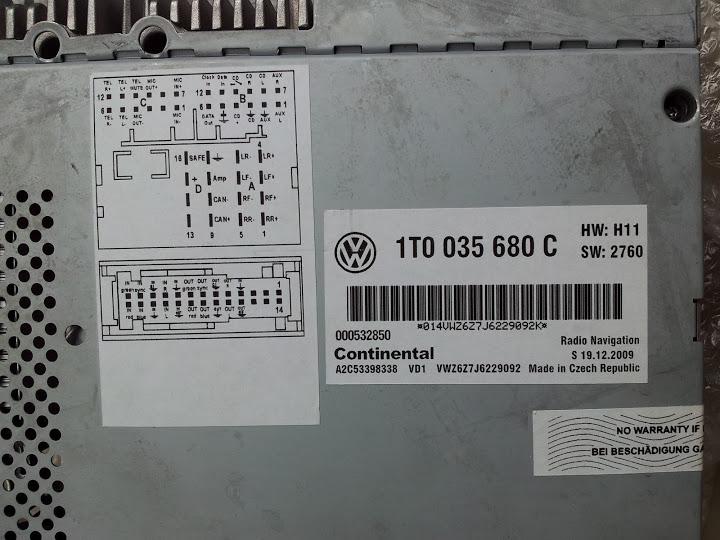

        The RNS510 is built to pass-thru the mic cable/signal which is how I have it setup in my car.
        Also see Min In/Out pin layout on the RNS:

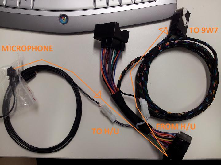

        You can purchase the plug'n'play loom here (if your current one doesn't support that - both my RNS510 and bluetooth are retrofitted).:
        Otherwise you'll be routing a new microphone cable through your roof and A pillar and you'll still need to fiddle with wiring to get it plugged into the RNS510.
