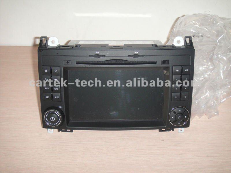

    So I bought this unit from Alibaba.com
    US$405.
    Arrived within a week, communication great, unit packaged great.
    Install was very easy, straight plug and play.....or so I thought.
    It will not power up

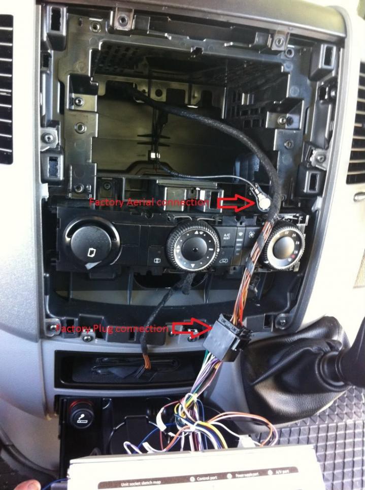

    Heres an aftermarket install into Mercedes Sprinter
    [YOUTUBE]T6i2UBb4cBY[/YOUTUBE]
    These are pretty much the only plugs you have to connect....I would have thought
    I even tried using the ANT C wire as a trigger to switched 12V but no luck

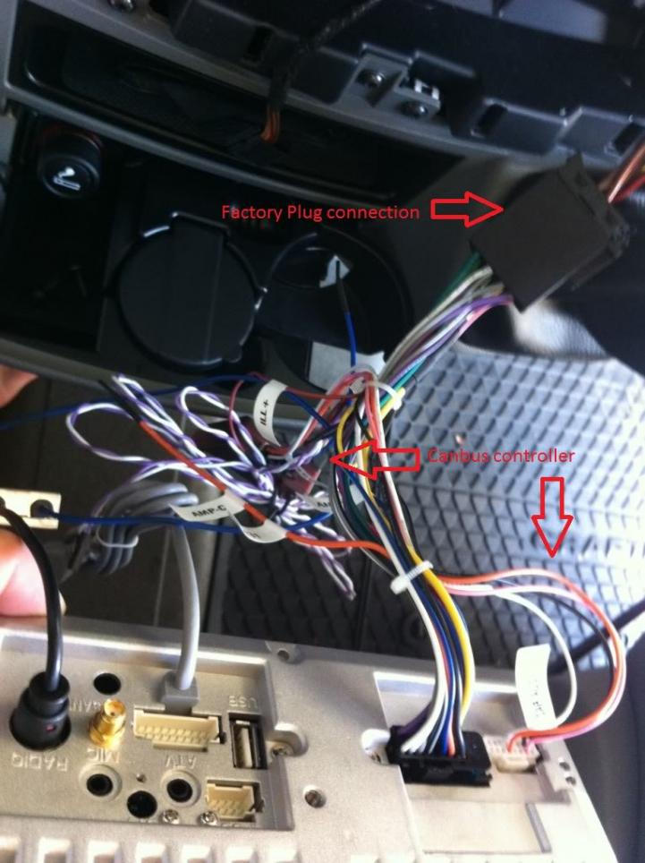

            Where does the purple and white twisted pair plug into? Looks like it is hanging loose. IIRC from my investigations (for a MkV) the twisted pair is the Can Hi/Lo signal, and that shoudl connect to the canbus controller.
            From the Ross Tech Wiki
            CAN stands for Controller Area Network. CAN is a new means of communicating with the car for diagnostics used by the latest generations of VW, Audi, SEAT, and Skoda vehicles. Unlike the older ISO9141 system which used a single K-line for diagnostic communications, the new CAN-Bus system uses a twisted pair of wires with differential signaling. CAN is considerably faster than ISO-9141 (500 kbps vs. 10.4 kbps). Both new hardware and new software are required in order to communicate with cars using CAN for diagnostics.

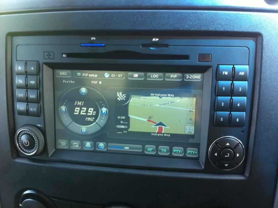

                The headunit is all in and working.
                He used the purple and white wire off the red box above to tap into ACC power and bypass the factory computer....apparently.
                Units fantastic though, great interface.
                PIP function is great, you can have the Sat Nav up with the radio controls, or DVD or whatever.
                It has a built in Hard drive to rip music to plus all the usual features, Bluetooth, reverse camera etc etc
                Plus a quality VW feel to the switches.
                Not bad for $405 US

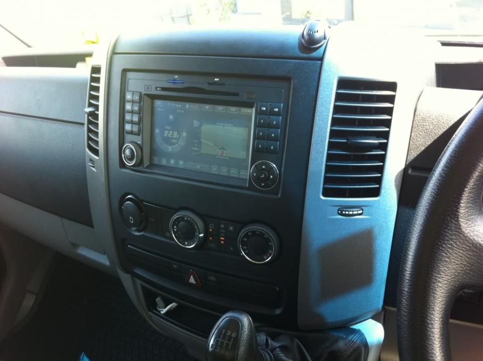

                    Can you read the screen on a sunny day?
                      Yeah no problems whatsoever.
                      No different to what it is with my RNS510 or Columbus.
                      iPhone pic may be making it look a little washed out?
