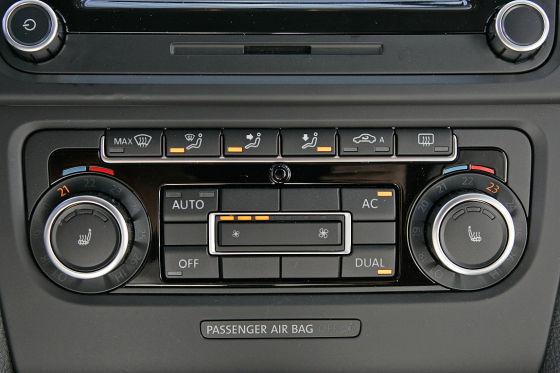

    for the Climatronic Display on the Screen I believe you have to have the Later Climatronic controls installed and Do a Wiring loop on the Climatronic Harness to trigger them to Display on the screen!
    I decided to stick with the Old Style Controls I preferred them!
    You need this new Style
