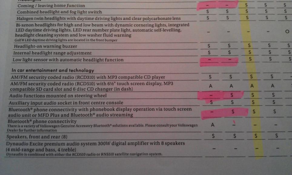

        If you look under the last of your pink highlights you'll see Bluetooth connectivity which doesn't come with the car.

              Ryan_R is on the right track. The last line you've marked is ambiguous, but the one under it is clear enough, i.e. no BT unit, which isn't shown as standard on your car, then no connectivity.

                That refers to the dealer fitted genuine accessory, whereas the line highlighted in pink refers to the factory fitted 9W7 unit. As he has a 118TSI (highlighted in yellow), if he had a MY12, bluetooth would have been standard.

                  The accesories list was clear enough. I was simply looking at the wrong year brochure.
                  The Yellow column is the 118TSI and the pink lines denote a difference between models. Had the dealer bothered to get back to me I'd be driving a 118TSI with the features included. Instead he decided I wasn't worth following up and it was easier to buy an 18 month old model for 10K less. My heart bleeds for all the dealers doing it tough.

                    Yeah I assumed you had the correct year brochure but it was apparent you didn't when I had a closer look at the pictures (would've helped if we saw the headings)
