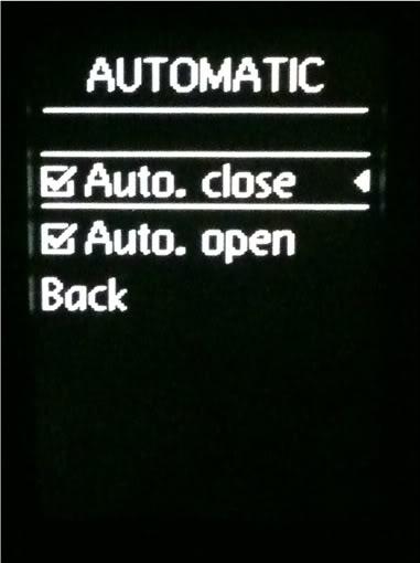

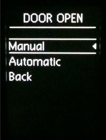

    Should be a way of disabling it . My My11 Passat came back after a service like that and on reading the Manual found out how to disable it via the MFD.

      in ur mfd u can set it to manual or automatic.
      u'll need to use vcds to modify at what speed the auto lock activates.

              i checked and mine is in the MFD as well, however most of the settings arent available untill i was in park, or the handbrake was on. thats where i found the door locking function. i like the unlock function when the keys are removed too!
