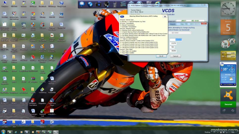

Hi gang,
In need of some serious friendly assistance.
Problem:
I have installed a C Version RNS510 into my R32. Everything worked (incl MFD status and steering wheel controls etc). BUT, somewhere along the line, my somewhat non-gynaecologic friendly fingers may have hit an incorrect key while checking some VCDS (aka VAGCOM) codes. Now, the LHS of the steering wheel (volume up/down/mute) no longer works, and the RHS only works when the MFD is displaying fuel consumption etc....not when Audio is selected.
I have searched, and searched and searched some more (everywhere). Tried (almost) every known cure for this and related issues raised by others. And now I've come down to one of my last hopes. I would like the VCDS Log readout from someone who has a similarly spec'd R32 to ours.
Details are:
Manufactured April 2008
DSG/5 Door (not that the number of doors would make a lot of difference)
RNS510 (either factory fitted, or installed post delivery and now working flawlessly).
NO BLUETOOTH MODIFICATIONS/ADDITIONS
NO OTHER 'CAN' MODULE MODIFICATIONS due to the installation of other equipment (eg, RVC, MDI)
Can have a Sunroof (ours does, but not that important).
Specifically, the modules I need to interrogate are:
Modules 09, 16, 37, 46, 47, 56
There is nothing malicious intended with this request, I just need to cross check the codes to find the error.
The log file will only be about 10 - 12kb (text/notepad form) and once someone is able to do this, I'll forward to them an email address for it to be sent to (me).
Really hope someone can assist with this.
