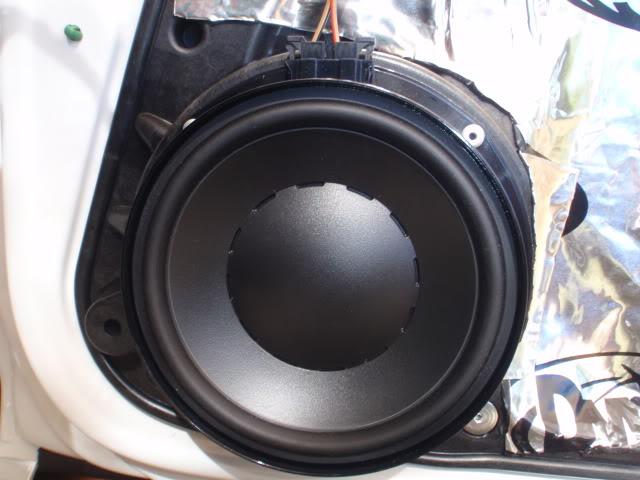

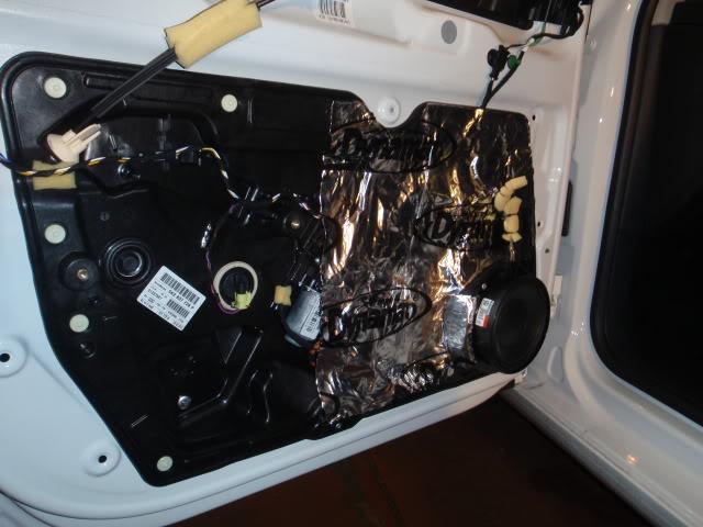

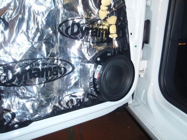

                    Yeah the Dyn system is way better than the stock setup. If you like your music it's money well spent. The MK6 Golfs use the excite system. 4x 5.7" woofers and 2x 1.1" soft dome tweeters and a 300w RMS amp under the passenger seat.
                    I'm pretty sure the door skins have a sound deadening on them put the inner card where the speakers are mounted to are plastic so you get a bit of drumming. I covered half the inner card with Dynamat and it made a huge improvement. Gave the system more volume and bass. I actually had to turn my bass down a few levels. The Dynamat also eliminated some of the rattles in the doors you get with loud music.
                    To make sure I wasn't going to get any rattles I also insulated the wires and latch cable in foam. Another tip is to run some sticky back foam along the bottom edge of the door card. This helps pack the door card out so when you tighten up the bottom torx screw it's a nice tight fit. From new it would rattle really bad with loud music. The door card would vibrate on the door frame. Nothing worse than having rattles with a good quality system.
                    I've pretty much eliminated all rattles associated with loud music and I'm very happy with my system!
