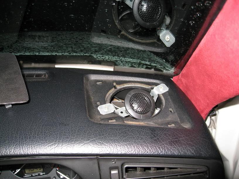

    Oh and I'll try and dig up the thread for you...I was lazy with my install but it STILL hasn't screwed up (one year or so) so you gotta be happy with that! I mounted the tweeters at the front in the dash with a piece of metal I bought and bent from bunnings lol...
      Argh there's no pics of them in my thread! I'm going to take pics now haha
      Here we go. The bracket that was bought from bunnings was like...2.63 if I remember rightly! We just grabbed two sets of pliers, bent right-angled bits accordingly, and screwed it into the dash.

            thanks for the quick photo post.
            nice and easy by the looks.
              Yeah mate, a very simple fix to what I initially thought would be heaps of fabrication work
