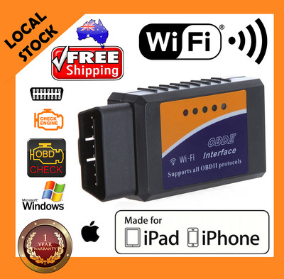

            I have a similar setup on my MK5 GTI and it all works perfectly, there might be something wrong with the obd2 device if it doesn't detect your ecu. I use a unit like below which is wifi not Bluetooth.
            The ELM327 WIFI OBDII interface is an engine performance and diagnostics tool for automotive professionals and enthusiasts that allows you to wirelessly connect your car's on-board computer from your any Wi-Fi enabled device with the compatible application or software.
              https://www.ebay.com.au/itm/231177929373
              Yeh thanks mate I'll buy that one and see how it goes. I have a strange feeling there bluetooth driver issued with my phone. It connects to the OBD reader but on all the apps i try it always fails to find a protocol to read the ECU. Any possibility this car isnt OBD compatible?
                I'm no expert but why would it have an odb2 port if it wasn't?
                At $30 or whatever the adaptor costs it's a small risk to take especially if myself and others have got it working. I don't see why the mk6/7 would be that different.
                Good luck either way
