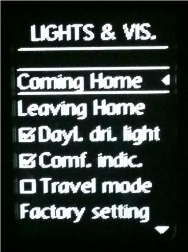

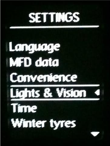

Since I took delivery of my can back in Nov 11 the 'Auto On' for headlights has always been selected. During my trouble shooting this arvo, I turned the switch off and the light problem went away..... all lights work.... though there is an interesting twist and that is the parkers no longer work when I turn the headlight switch to the parker position - tail lights work.... and when the switch is turned to the headlight position the headlights come on together with the normal operation of the tail lights - no parkers though.
Interestingly the DRL no longer work even though this is selected in the MFD settings.
Looks like things a bit screwy.
Can anyone shed any light (no pun intended) on this problem??
