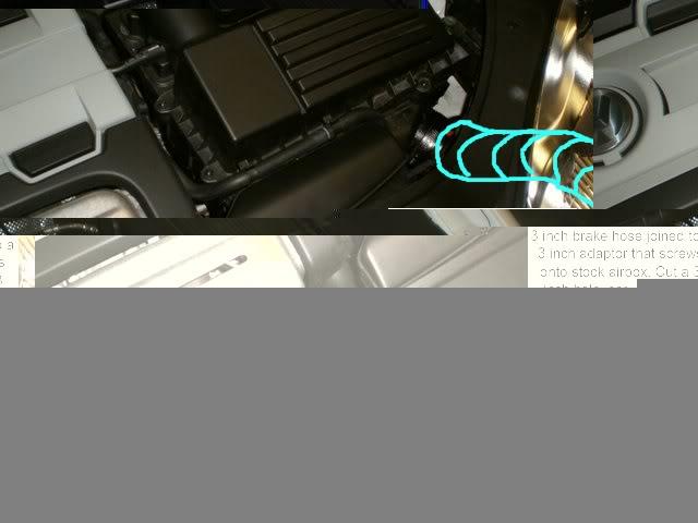

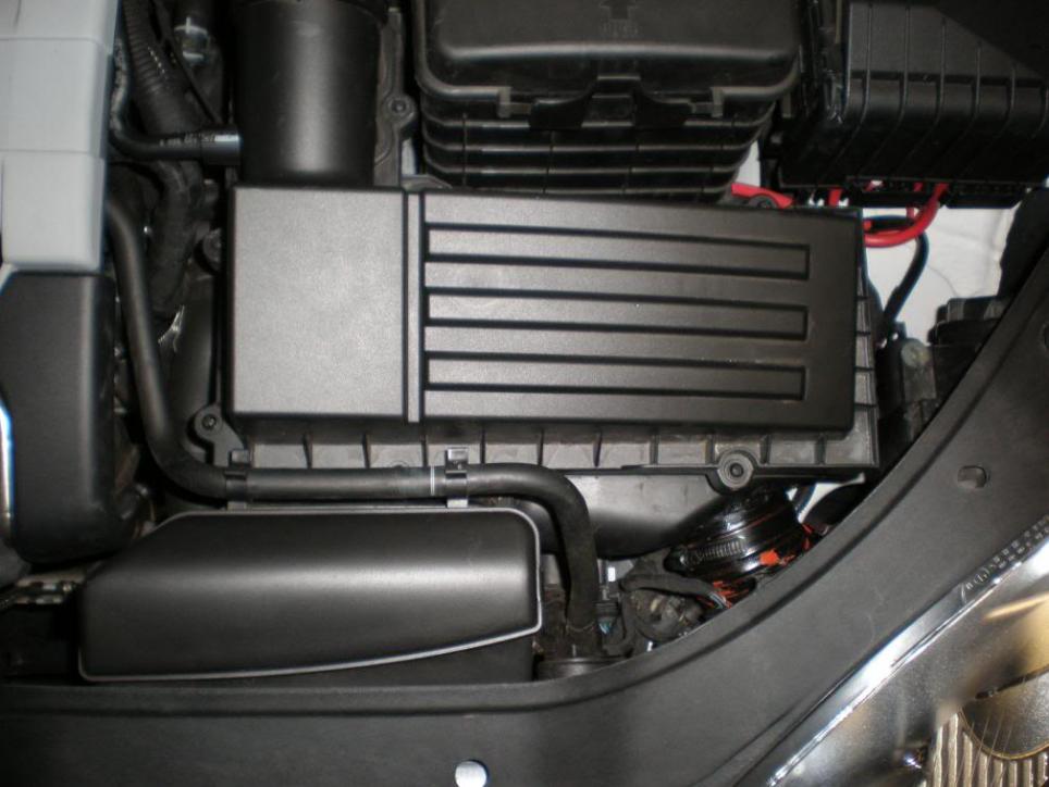

    I decided to improve my GT 1.4 TSI airbox by cutting out a small square hole where the factory over the radiator air intake should be going into, then removing the plastic screen that covers 90% of the surface area under the air filter and finally installing a circular hole in the right hand side of the airbox to mount a cold air pipe to the lower foglight area.
    looks totally stealth from above as the pipe is black and the factory system is still 100% present.
    This should flow enough air to compete with aftermarket air intakes as the intake size of the turbo and supercharger is so small that the existing pipework from factory is more than enough provided the airbox gets better air feeds like I have done.
    Enjoy.

        I feel like the car is a little more perky when its been running for a while. To be honest the cold air pipe on the right hand side is probably overkill for our little engines but because I had it there and had the pipe it was easy to do. I will put a longer pipe on in future and have it hooked up to a circular hole in the foglight covers.
        To get 90% of the gain I think you should just open your airbox up so the stock intake can work properly. Do this by cutting the square hole I cut to allow straight airflow from the factory induction.
        Also remove the plastic screen you will find under the air filter, it pops out and so you could put it back before a service and they would not even see the square hole you cut! factory!
        To make the square hole use a soldering iron, just stick it into the plastic and drag it around. Makes fairly easy holes and they can be quite precise. I just did it quickly. You can also melt the plastic back onto a pipe and make it snug

                            1. Unscrew all screws in airbox lid to pull it upwards and expose air filter,
                            2. unscrew the front air intake with star shaped alum key and pull it off.
                            3. pull the bottom half of airbox upwards at each point where a pole with knob comes up through a rubber grommet in the airbox. Apply force upwards and you cant go wrong. There are 3 grommets around 3 poles.
                            By the way my cold air intake is showing me air intake temps on the Scangauge 2 of 23'c when the outside temp is like 18'c.
