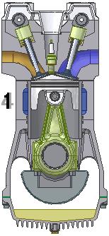

    I've included a .gif of the 4 stroke process to help visualize the details written below.

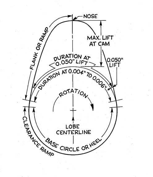

    Below are a few pieces of referece material to help visualize things that are discussed later on......
    Here we have a photo description of EVERY part of a camshaft/lobe:
    to help visualize the 4 stroke combustion process, refer to this:
    EXHAUST SIDEINTAKE SIDE

        DURATION is the length of time that the valve is held open by the cam. This is measured by the degrees that the crankshaft rotates. More degrees of duration will make the engine operate in a higher rpm range. There are two ways of rating duration:
        **ADVERTISED DURATION was originally the S.A.E. (Society of Automotive Engineers) standard as measured from .006" of valve lift. Over the years this has been altered by most performance cam makers to make their cams look hotter, or different, than the specs of their competitors. Valve lift points as low as .002" are sometimes used and this can add up to thirty degrees to the advertised figure. Even when the cams being compared are all measured the same way the figures can still be misleading if you don't know what the cams were designed for. Cams designed for quiet street operation will show higher .006" duration numbers than performance cams of the same rpm range.
        **DURATION MEASURED FROM .040” (1mm), or .050" of cam lift is the best for comparison of specs because most of the variations in cam design are reduced and the valves are open enough to start getting some flow past them. Most cam makers give accurate ratings and good comparisons are possible between cams of the same type (hydraulic or solid or roller).

        BASE CIRCLE, or the heel, is the round portion of the cam lobe. This is where the lifter rides while the valve is closed. VW hydraulic camshafts have a 1.34" base circle, where a mechanical./solid lifter cam has a larger 1.5".
        BILLETS and CORES are the blank shafts that the camshafts are made from. CAST CORES and PROFERAL IRON BILLETS are used for most flat tappet camshafts. STEEL BILLETS are used for roller tappet camshafts.
        CAM LOBES are the parts of the camshaft that create the valve movement.
        CAM PROFILE or CAM GRIND is the actual shape of the cam lobe.
        CLEARANCE RAMPS are the portion of the cam lobe between the base circle and where the valve starts to open. They slowly take up any slack in the valve train and reduce the shock created by the sudden movement of the lifter.
        FLANKS are the sides of the cam lobe that cause the movement that raises and lowers the valve. They are also called the OPENING and CLOSING RAMPS.
        NOSE of the cam lobe is the portion of the lobe with the highest lift.
