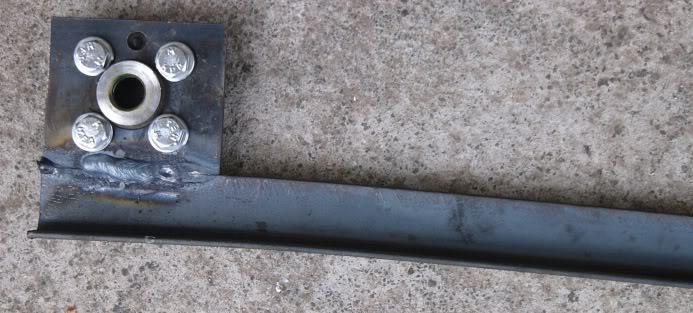

          When I had a crank bolt that was ridiculously tight and the motor was out I was going to lock up the other side of the crank and just breaker bar off the nut. I was advised against that by a mechanic who said it could damage the keyway. I haven't seen that happen but maybe it puts undue stress on the keyway as well if the bolt is really seized against the sprocket it will be yanking on the sprocket and its keyway when it finally cracks and turns. Anyway I just made up a tool just like Pete did. Its the safest way to crack that bolt.
          • #20
            That reminds me I meant to post the pic of that tool in this thread as well as the projects thread.
            Even managed to put a bit of a bend in this one. I might weld a solid bar into the angle for next time. This angle is only 3mm - thicker would be better.

              I used 1" pipe, fairly thick walled and it still bent a little! The crank bolt on mine was just so ridiculously seized I have never seen one like it. The proper factory tool is just one piece of flat bar - probably 5mm thick or so.
