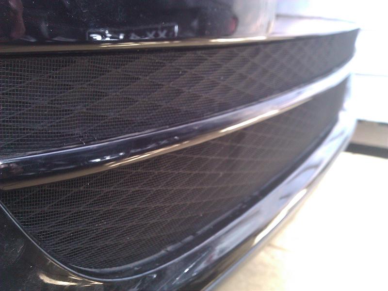

    So my question is in relation to the lower grille which has half of it blocked off (see pic below). The top section is blanked off whereas the lower section is open. Just wondering about removing the top "blanking" and having air flow through the whole lower grille. Is there any issues with doing this? Plus side is better cooling but wondering if it's going to cause me any issues.

    OK so I might be answerig my own question here but on further research I've found there's a few Ford models with active grilles - little stepper motors which open and close off the grille.
    Theory goes that having the grille closed helps to warm up the car quicker to get to operating temps and also helps with fuel economy by reducing aero drag. However having the grille open obviously assists with cooling so there's a trade-off.
    Given I can only have 1 fixed position, do I stuff up my aero for extra cooling or not?

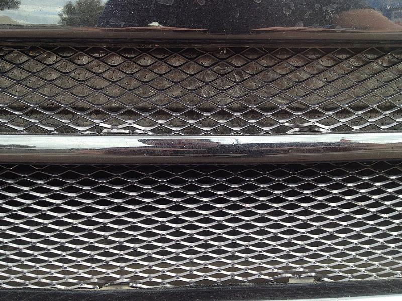

                              Well after all that I pulled off the front bumper/grille on the weekend to install some new mesh and found that behind the blocked off section of grille there's a big chunk of polystyrene.
                              I'm not sure what to do about it so I left it. It's probably there for impact resistance I imagine.
                              Here's the full grille treatment:
