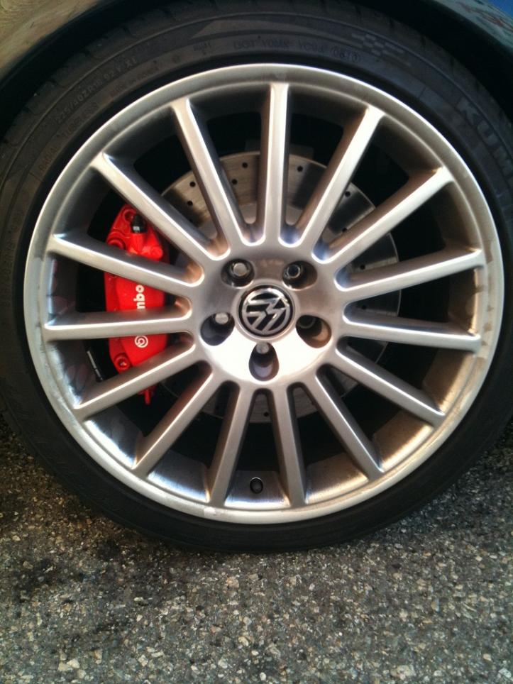

    Hi mate, I can confirm that 4 pot calipers on 312mm rotors are brilliant mated with decent fluid, pads, lines and rotors. They just bite so hard and not just initially either. The harder you progressively push the pedal the harder and faster you will pull up. It's like you have to concentrate on how much pedal you use because the clamping force is so controllable but can easily be overdone. So make friends with your rear view mirror
    Not to mention the big unsprung weight difference between say the Porsche or Brembo calipers v's stock.

        He has some Brembos Paul. From Ebay in the UK.
