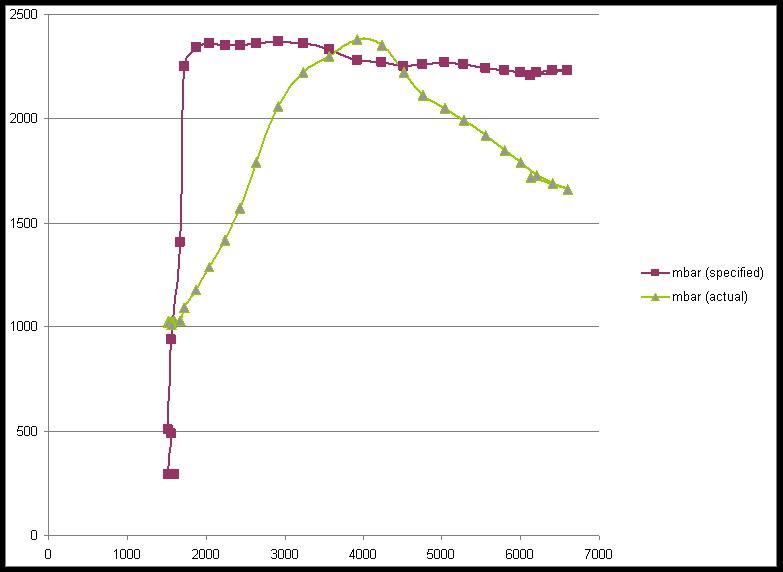

First one's shows the actual boost vs requested boost @ full throttle 2nd gear

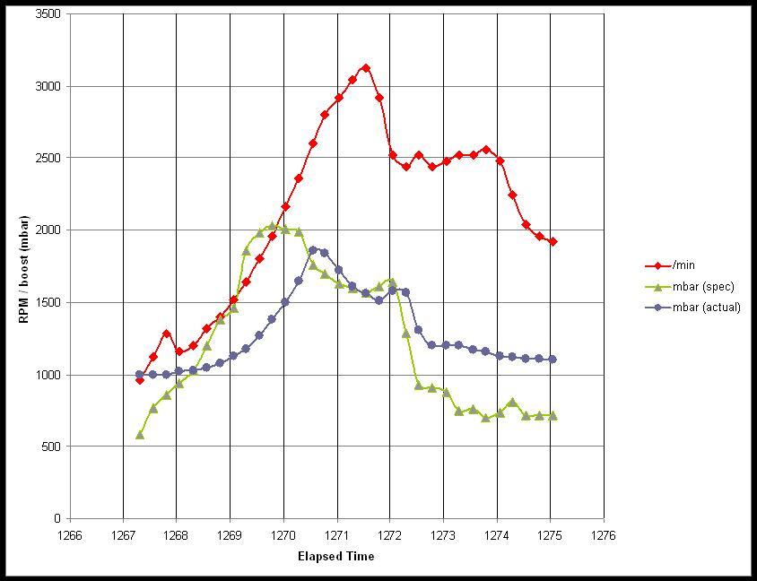

Second is moderate acceleration with fixed throttle position running with DSG in "D". Short-shift in 1st, 2nd gear to 3,000RPM and then cruising. Note that the boost drops off after 2,000RPM which results in loss of power.
