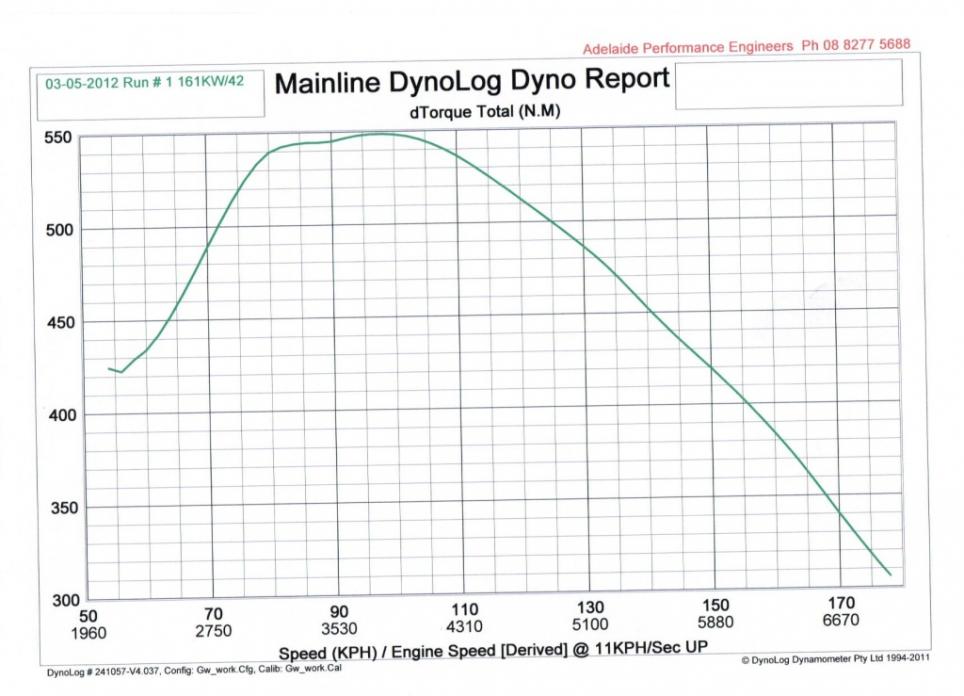

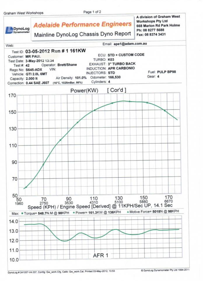

    What: MY06 MKV VW Golf Gti / 161KW / 548NM / Custom TBE / APR Carbonio Intake
    How: Custom Code Stage 2
    Who: Optimumcode (Gavin)
    Dyno: Graham West Auto - Park Holme
    Comments: HPFP and 145 bar rail valve to come!

    Looks like u need that HPFP. Almost touching 13's top end, which is a bit lean IMHO.

        Holy crap 548nm, nice one mate! I need a 2L stroker kit

          And a very strong gearbox!! they are rated too, that tends to get forgotten about a lot

            548NM? Hows the traction?

              Wheels spin in 1st, 2nd & sometimes 3rd! You just need to feather it. Given some SS boys a wake up call. The mid range is just Phenomenal.

                It's got a fault we are looking at which is affecting the AFRs. The AFR shouldn't be oscillating like it is. That's also off the exhaust not the ECU.
                Gavin
                  Nice one; AFR doesn't exactly look HPFP related - it goes up to 13 at high rpm as well where the FP isn't struggling as much.

                    is 548nm correct? my R only made around 430nm with k04...
                      The torque is uncorrected, not making anything like that number.
                      Just not possible.
                        Just not possible.
                        The dyno lottery again. Probably much closer to 400. Yet again proving a dyno is only good for before and after comparisons or as a tuning tool.
                        Gavin
                          Absolutely true, the debate will never end though will it!
                            And people will always compare one dyno to another and saw my cars better cause it made more.
                            No. The dyno gave your reading. Another dyno gave the other persons reading.

                              Paul found some faults with it on the day. What looks like a boost leak from somewhere, despite a new DV and fettling of the PCV system.
                              The AFRs look to be down to the inlet manifold flap. Not sure 100% but there were codes for it. After doing an adaptation the codes have stayed away and he says it's heap smoother now but doesn't feel as quick? Maybe less peaky onset of boost?
                              He's going to look at doing AFR logs today hopefully.
