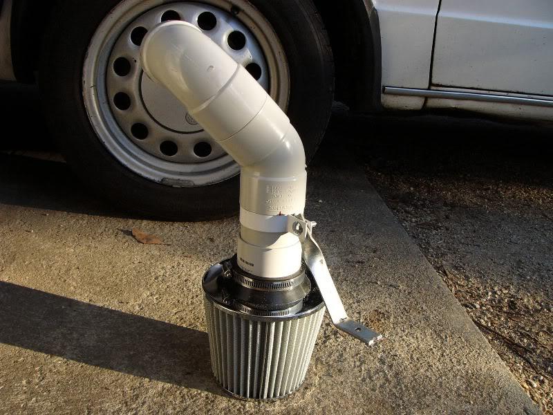

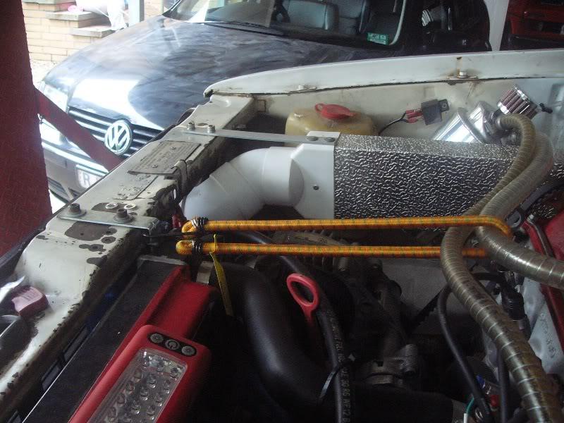

Bunnings CAI FTW!

Dude that bunnings setup is good. No sarcasm from me, thats good cheap air ducting where you want it.

It's absolutely a major improvement for your MkI but the stock intakes in MkV and MkVI Golfs (and 9N3 Polos) is far better routed than the stock MkI's.Originally posted by Peter Jones View PostBunnings CAI FTW!Resident grumpy old fart
