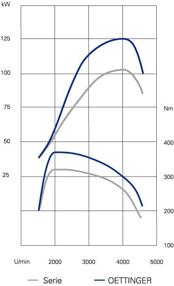

    APR Don't do the TDI upgrades, it's through Oettinger.
    The Oettinger TDI flash gives you 103kw > 125kw, torque 320nm > 380nm, cost installed is $1350 including GST.
    German Auto in Melrose park can do this upgrade whilst you wait - Andrew, the owner has a TDI Jetta of his own & they can look after your log book servicing for you.
      P.S. - Oettinger claim a 1.2 second increase in 0-100 times (TUV certified) - we don't have any stage 2 / or 3 options (like exhaust or bigger turbo), but the APR TDI Carbonio airbox goes well with the tune.
