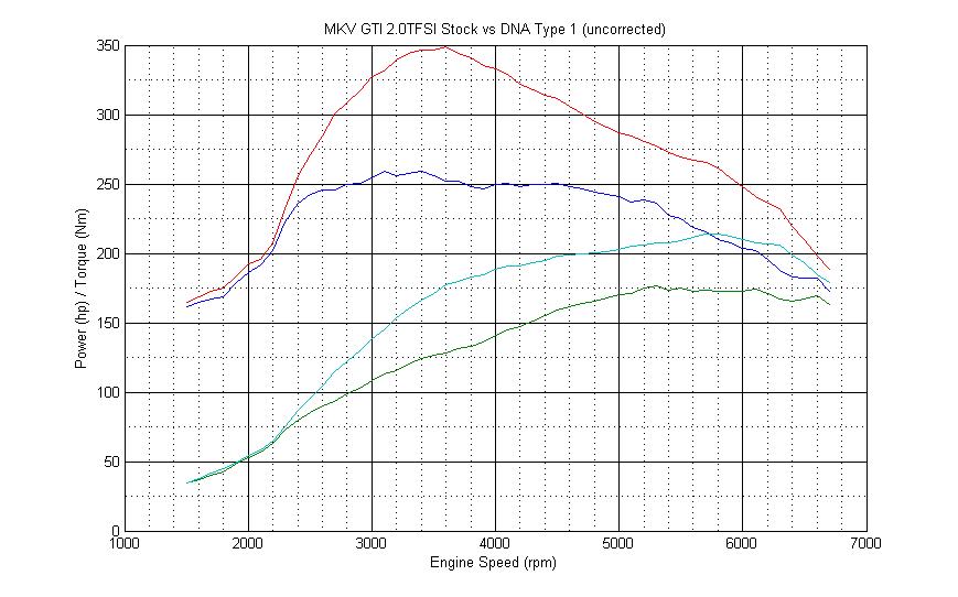

                        Our aggressive tune (figures at the wheels):
                        Other dyno graphs available; please send an email to me at dnatuning.aus@gmail.com and we can continue the discussions there, cheers.
