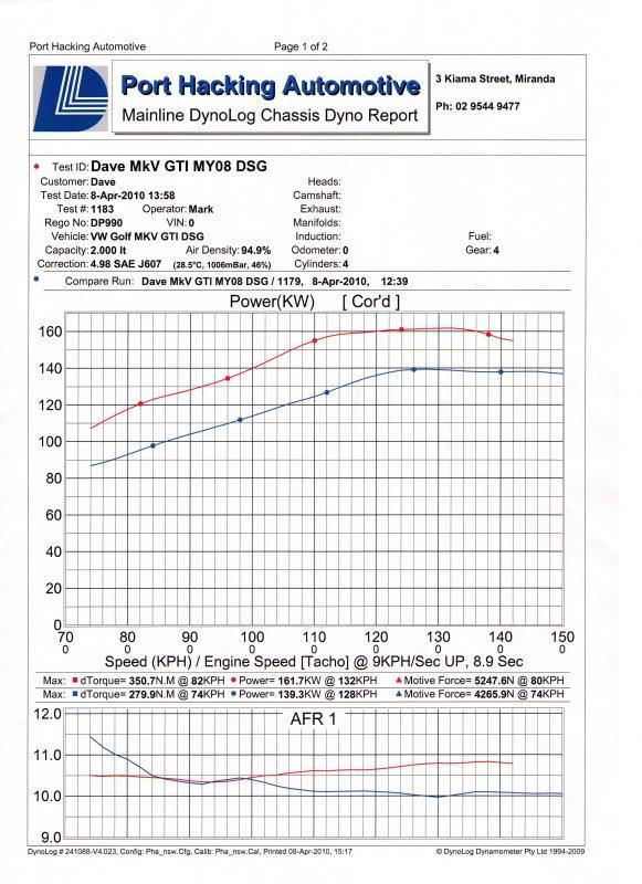

    Had the Hothatch remapped today and I'm very pleased with the result.
    I was able to dyno the car to establish a baseline which to my surprise and the tuners returned a healthy 139.3kw at the wheels stock standard.
    This is on a Mainline Dyno (Not a Disneyland Dyno). I was also able to see before and after tune AFR and boost figures also.
    Stock AFR was rather rich in the low 10's at WOT and boost was 14psi.
    Post reflash its now still really safe in the mid to high 10's almost 11.0:1 and boost has increased to 16psi.
    The car now makes 161.7kw atw's and was dyno'd in 4th gear DSG.

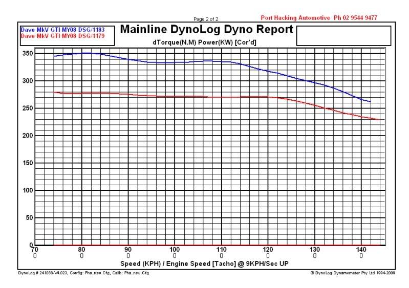

    The car is AWESOME !!! to drive as I had to drive home to Wollongong it got a good test in many situations. It pulls in 4th gear now how it use to in 3rd. 1st and 2nd are insane. I've also picked up roughly 70Nm of torque.
    I'm really happy with the result and the service I received.

    That looks pretty rich still. Have you noticed any black smoke when you boot it? I saw a bluefinned MK5 that was real rich at a dyno day last year that was in the 10s and smokey.

      No smoke mate, it's leaner than the OEM tune and there was no smoke before the tune and certainly isn't post tune. Agreed best bang for your buck mod. The car is the way it should have left the VW factory.

          Its pretty much flat 10's stock and approaching 11's tuned, still a bit rich but better to be rich than lean there still a bit to be gained if you need it . Remember this is only when the car is WOT. Check it again in a while and after you get the dump pipe

                  Daves car had the highest stock power for a GTI that I've seen they usually hover round 125 up to 130. I'm not sure what is going on there unless the previous owner had something done. It just doesn't make sense factoring in drive train loss. I'm even considering DSG after this one (note I said considering)
                  Everything is stock on the car mechanically too, nothing changes at this level, even the boost isn't too wild.
                  Oh yeah apologies for the Speed on the X axis and not RPM. I'll grab that for you next time I'm there. Operator error that one

                    Torque graph now added to first post.

                        Its will be interesting to re-dyno Daves car in a couple of weeks time just to see if its improved further with thing having 'learned' whats best. These two runs were only say 30 minutes apart. I think we did about 10 puls on the dyno maybe more, every run both before and after you could basically lay on top of the old
