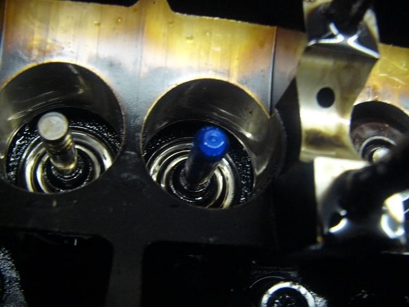

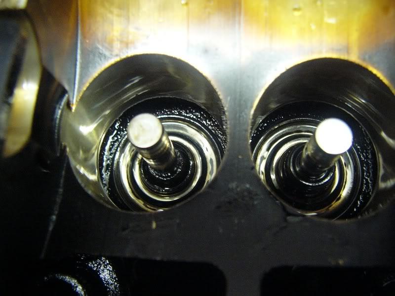

Here's what you're faced with after removing the cam follower.
Cam followers should be put back onto the same valve they came from.

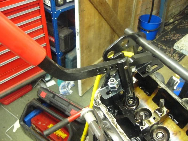

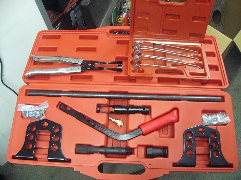

This is the tool used to press down on the valve spring to release the collets that lock into the spring retainer. Sometimes a bump from a hammer helps here if the collets have grabbed the retainer.
To stop the valves from dropping into the cylinder and just moving with the spring compressor, compressed air is used to pressurise the cylinder through the spark plug or diesel injector hole depending on the type of motor. This air valve hold came with the spring compressor kit.

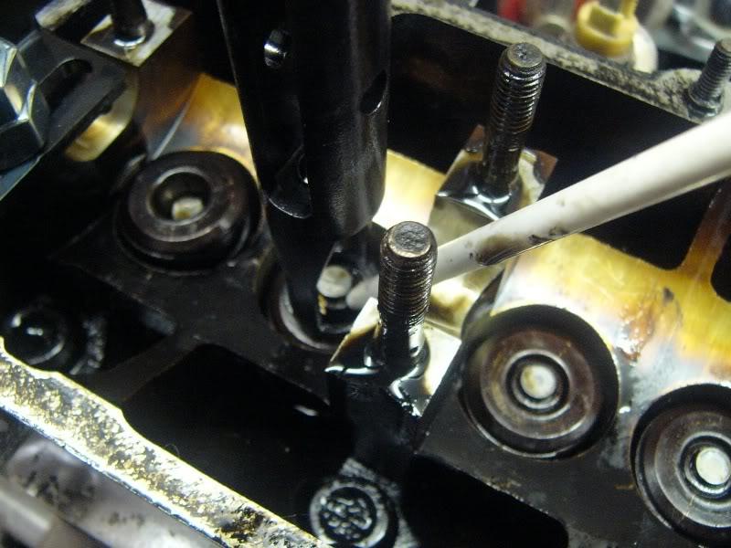

Here the collet is being removed from the depressed spring retainer with the aid of magnet on a stick. (technical ain't it?)
Collets removed.

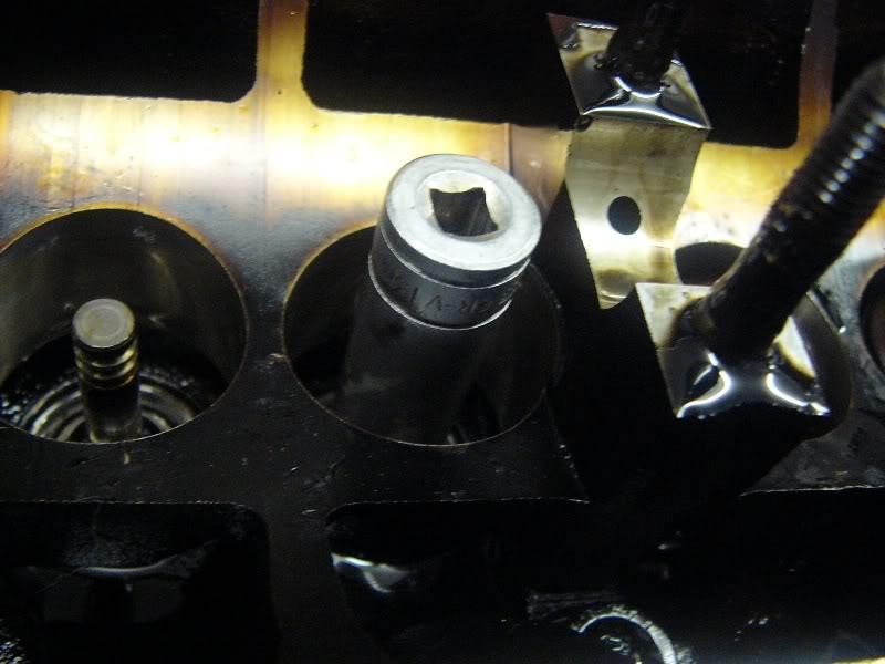

Springs and retainers out.
The stem seals live down the bottom of a deep hole and must be fished out using valve stem seal pliers which are specially designed for the task.
