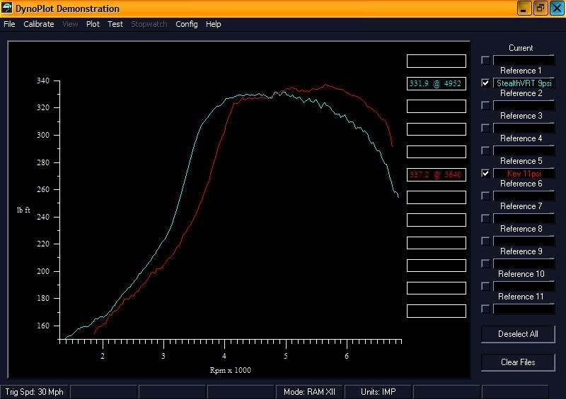

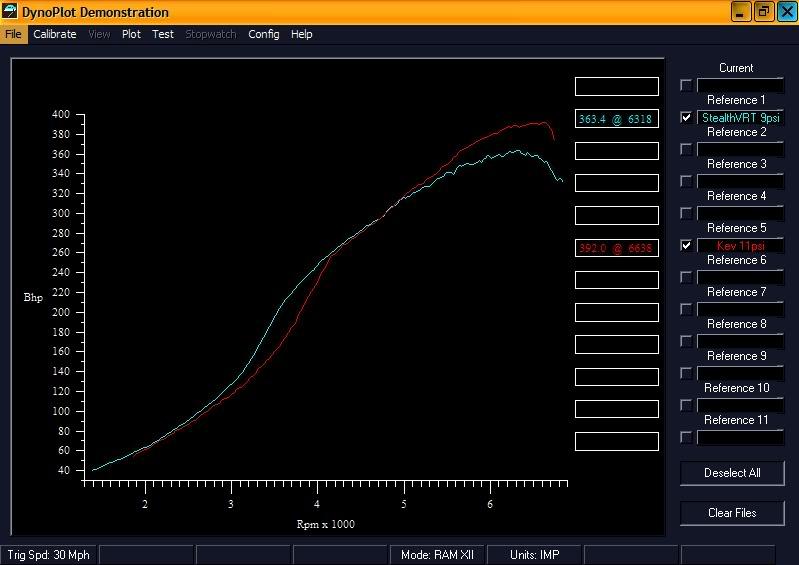

                      Heres another very recent option available in the UK. From UK based VR6 guru Vince at Stealth Racing, i copied this post from the UK Corrado forum;
                      Original post is here, i would register on the forum so you can view attachments of dyno plots, install etc... http://www.the-corrado.net/forum/vie...hp?f=1&t=89101
                      When Stealth set about this VR6 Turbo project we set out a certain criteria that we wanted to meet, all the boxes needed to be ticked before launching the kit.
                      1: Air filter / Intake to be mounted on same side as OEM, negating the need to relocate battery into the boot. I’ve seen some kits that have the cone filter mounted directly behind the radiator ie: not relocating the battery, all that hot air, madness in my opinion.
                      Our Intake sits on the O/S, so this box is ticked
                      2: The turbo kit had to incorporate the stock intake manifold negating the need for short runner intakes as these invariably need slimline radiator fans as there is no room for the stock fans. 2 Advantages to this requirement, firstly better torque from the stock intake and secondly and importantly no additional expense. Box is ticked
                      3: For Corrado’s. A good sized Intercooler needed to be fitted but without affecting the exterior look of the car. I am really glad to say this box is also ticked
                      4: Target BHP for our Stage 1 would be at least 350bhp.. Target achieved my Corrado has made 360bhp with 9psi boost. Box Ticked
                      5: Size the turbo correctly for what we believe to be the best compromise. By this I mean not boosting to early and putting undue strain on transmission components and not being too laggy and turning your VR6 into a slow boosting then almighty kick in the backside Sierra Cosworth. Box Ticked
                      6: We feel 360ish bhp is a very safe figure for stock internals with a head spacer, however if our customers decide on an engine upgrade at a later date then our turbo kit would need to also meet these requirements. In other words with the correct mechanicals this kit should do (Stage 2) 440bhp. We will look at stage 3 another day. So no wasted money in what you have already spent. Box Ticked
                      7: OEM ECU to be retained using our own in house tuned and tested software. Box Ticked
                      Below you will find the spec and list of parts included in our Stage 1 intro kit.

                              • #30
                                Sounds good mate.
                                In an earlier post theres a pic of my mates set-up, he's running pretty much what you've described, got most his parts through Bill Schimmel, he's running;
                                83mm Wossner Pistons
                                +1mm Inconel exhaust valves
                                +1mm Stainless inlet valves
                                3 angle valve cut, stems reduced
                                Schimmel 263 cams
                                Schimmel Intake manifold
                                Schimmel Air - Water intercooler
                                ATP Exhaust manifold
                                Garrett GT3582R (0.82AR)
                                500cc Denso 1220 injectors
                                DTA S80 Management
                                PLX Devices Wideband
                                Bosch 4 bar MAP sensor
                                TIAL 50mm BOV
                                TIAL 44mm Wastgate
                                Custom 3" downpipe
                                Techtonics 2.5" twin muffler (Borla) exhaust
                                R32 baffled sump (Turbo oil returns via the block)
                                Quaife Diff
                                Very neat set-up, he's invested alot of time and money into it, had some bad luck on the way with cracked exhaust manifolds, a GT30R seizing up, Pistons biting the dust etc etc. If you're interested you should read the thread on the CF that i posted, theres comparisons of this Stealth kit against his set-up, and theres not alot in it!! Actually, heres a couple of the dyno plots of the 2.........
                                Stealth Corrado VR6T running 9si Boost ---Blue
                                Kev's Corrado VR6T running 11psi Boost ---Red
