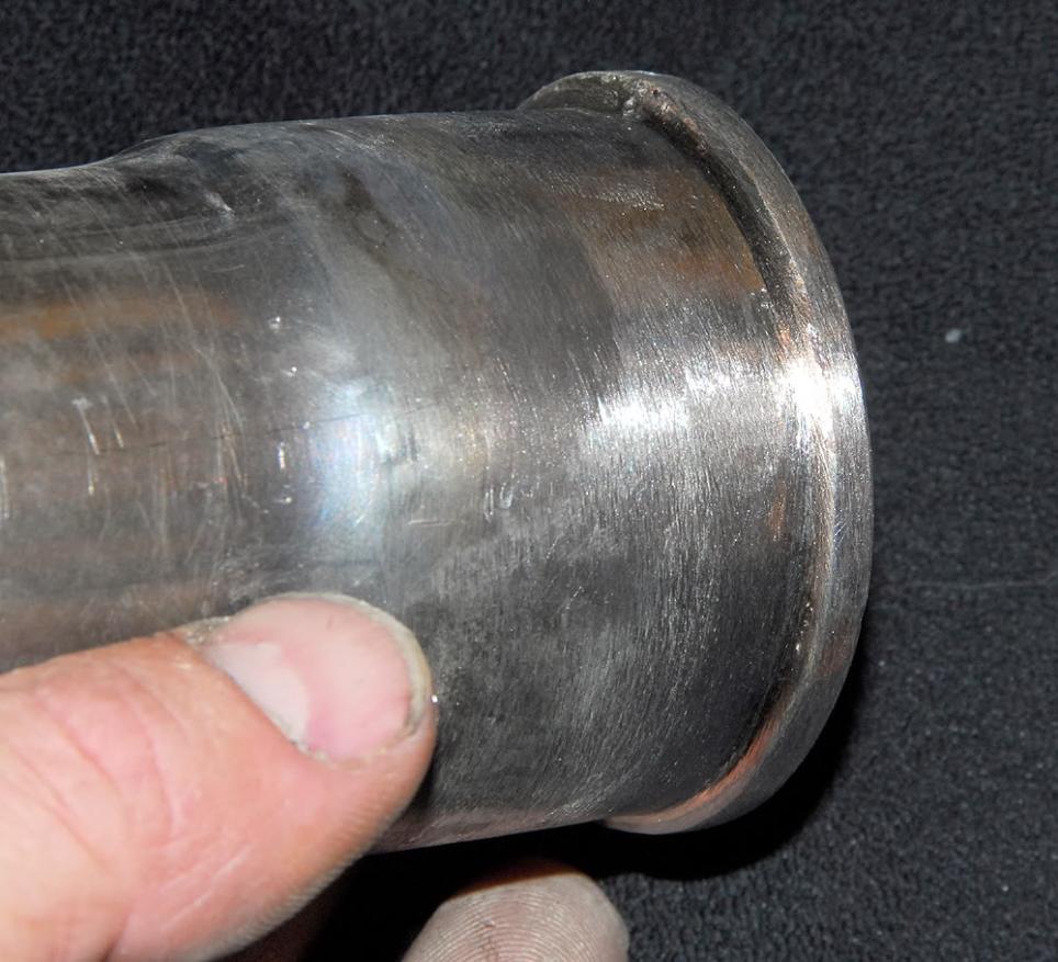

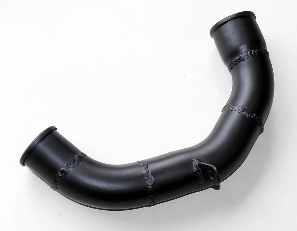

                        Roll 4mm wire (eg tent peg) around end of pipe, weld it into place and then grind it back. Mild steel mandrel exhaust bends, fusion weld with oxy acetylene.
                        Without these lips I initially had problems with intercooler hoses blowing off under boost. Now, now sign of a problem - even with the hose clamps not as tight.
                        (and an edit: I choose to put the bead at the very end of the pipe but you could equally well put it a little up the pipe.)
