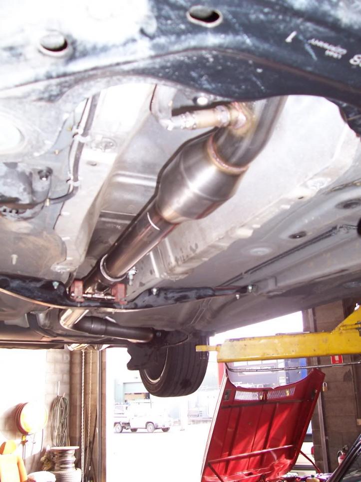

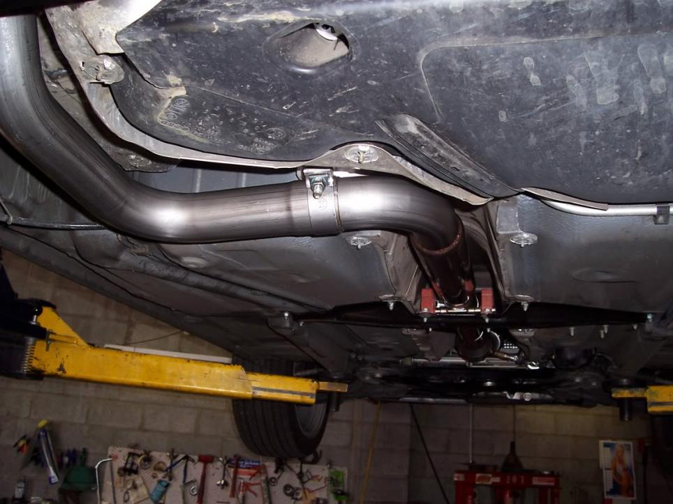

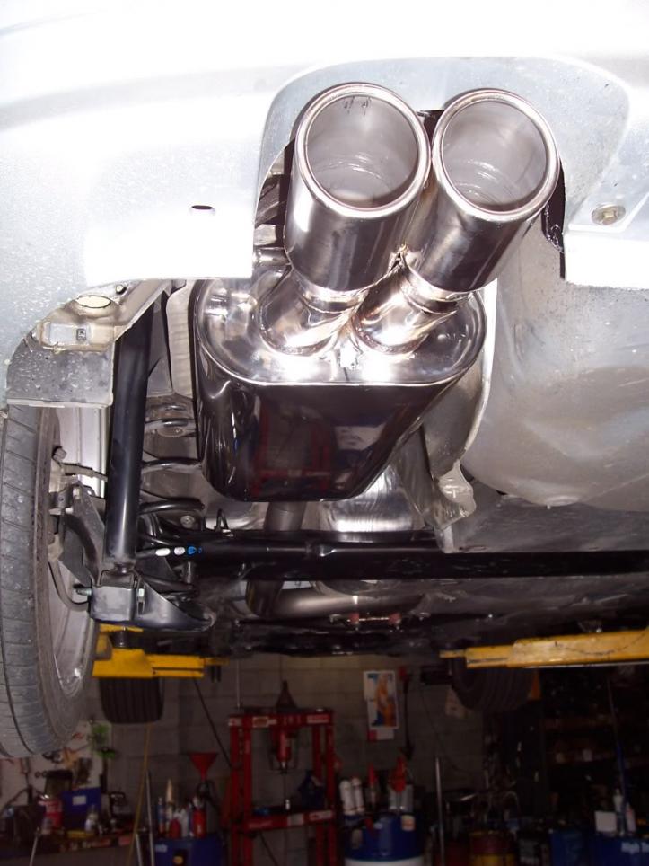

    I fitted this APR exhaust yesterday morning. Perfect fit and very straight forward to assemble. Didn,t have any clearance problems as I have with different brands in the past. Sourced a 4motion rear lower bumper section, genuine.
    It sounds very nice, a deep burble at idle with a nice unobtrusive deep note when driving. Check it out. Cheers, Andrew

          Looks quite good and fat tubing.

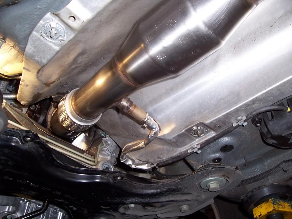

          Who makes APR and do they have any for MK2's ? In the pic, am I blind not to see the cat or is it that little bubble after the O2 sensor ? Do they make downpipes also ?

            The name of the company is APR. American. That "bubble" thing is the cat, very observant. No, sorry, they don't mave anything for the mk2. The downpipe on the mk4 is a reasonably new release, that being it is different to the LHD version. It is a great design, like the mk5 one that should still be found in pics on this forum. The mk4 system sounds exactly the same as the mk5 system.
            The longest part of the whole job is lowering the rear suspension to remove the old system. Sure, you can cut the old one but I prefer not to in case the customer decides to re,install it later on. Cheers, Andrew

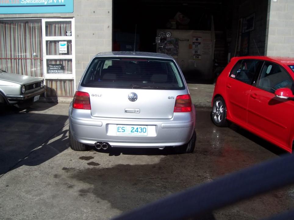

                        is that a 5DR GTI
                        N MY 18T -- '00 Golf Mk4 1.8T GTI
                          We didn't have a choice in Oz. 5dr or nothing!

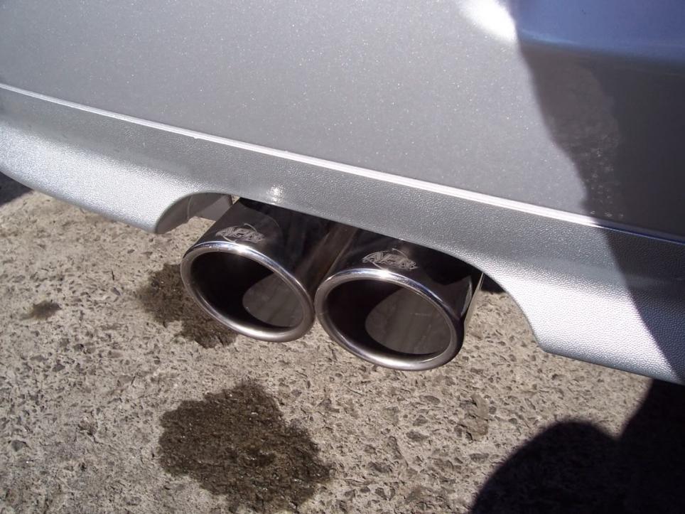

                            so is that a new rear skirt you fitted?
                              Hi, I'm back. Yep, that is the 4motion rear lower section. Genuine part. You need to trim a very small sectionof the body to fit it. Nothing major and takes about 5 minutes
