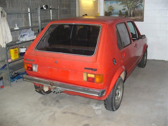

    This is our MK1 Golf - it's a '76 GL 5 door with the 4 speed manual and carby motor. Justin (celestine) and myself purchased it with the hope of restoring it to its former glory! We are both avid DIY'ers when it comes to cars, so we had no problem digging into this much much bigger project.
    We're both fairly new to VW's by some standards, with Justin only having his modded '07 Polo for about a year and my Polo GTI being the youngest at just 3 months old - a far cry from the 32yr old Golf But the obsession is flowing thick and fast with influences from here, VW Vortex and Performance VW mag.
    We landed this:

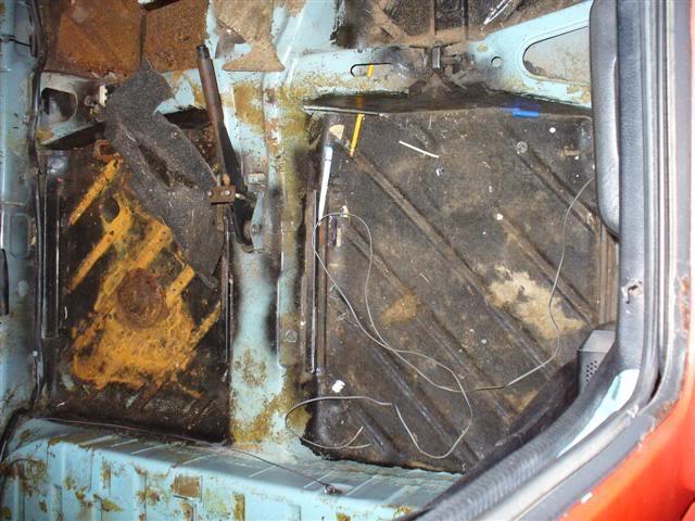

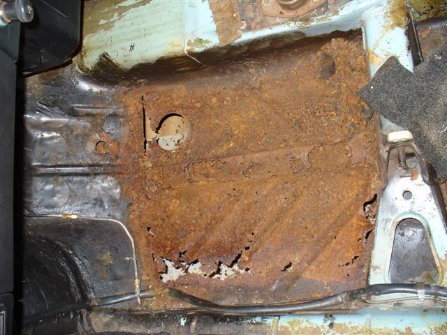

    Work began about a week ago, first job was to strip the interior out and check for rust - and boy did we find some! As some of you may be aware, these are the pic's we posted in the help thread:
    Not quite what we had in mind!!

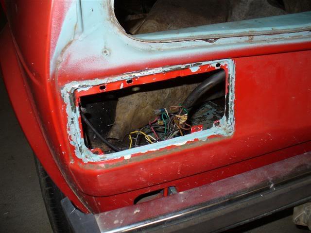

    Someone liquid nailed the tail lights in - what a mess! Not the mention the wiring...
      After some careful considerations and Justin talking with a few members on here (Jimmymac and GolfLoon to name a few!) we decided to keep going with the car and weld in a new floor section and cut and bog up the exterior rust.

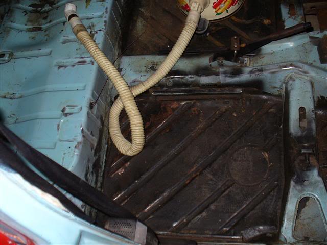

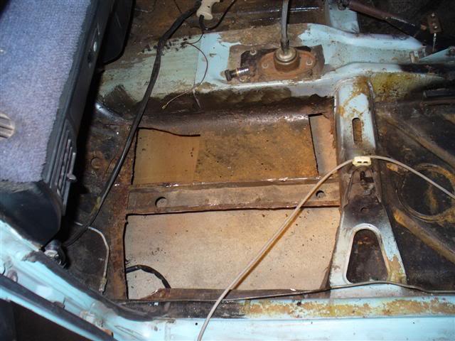

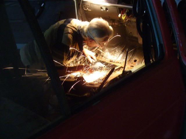

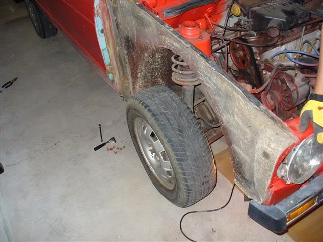

      This is where we are today - cleaned majority of spare wheel well out, stripped A pillars & guard, degreased floors and cut out the rust in the floor pan.
      We soon found some help to cut the floor out

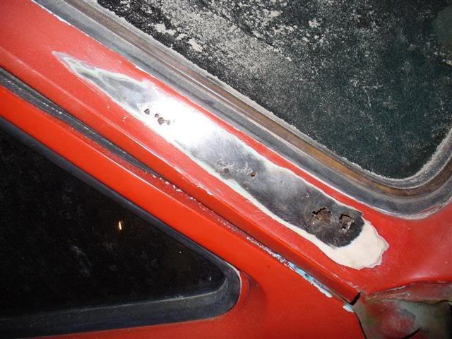

      Drivers side A pillar - previously been bogged up
      Passengers floor pan goooone! Justin picked up a sheet of 1.6mm steel to form the new floor.
      Partial cleaning of other footwells

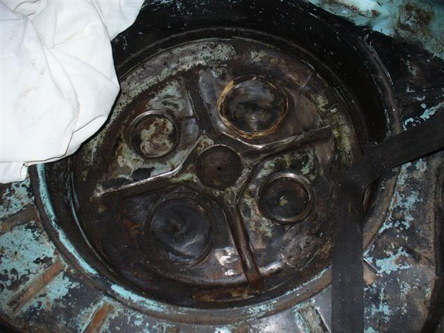

      Spare tyre well - surprisingly rust free with only a few small holes, considering.

                Leave a drainhole in the spare wheel well. That will save it for years to come

                  and, I'm surprised to see the rust in the A pillars, from what I know, not many 76's rust in the A pillars, but all (well most) or that later ones do, or are at least more prone to rusting there!

                      GolfLoon: Already one there, will make sure it's cleaned out.

                        Yeah only the later models had the external brake lines. Probably because the brake line grommets in the firewall leaked and that's why they all rust on the front floor i'd say.

                            tHE MK 1 ME AND JOSH JUST RIPPED APART HAD THE SAME ISSUE WITH RUST IN THE PASSENGER FLOOR, DUE (sorry caps) to no doubt the internal brake line.
