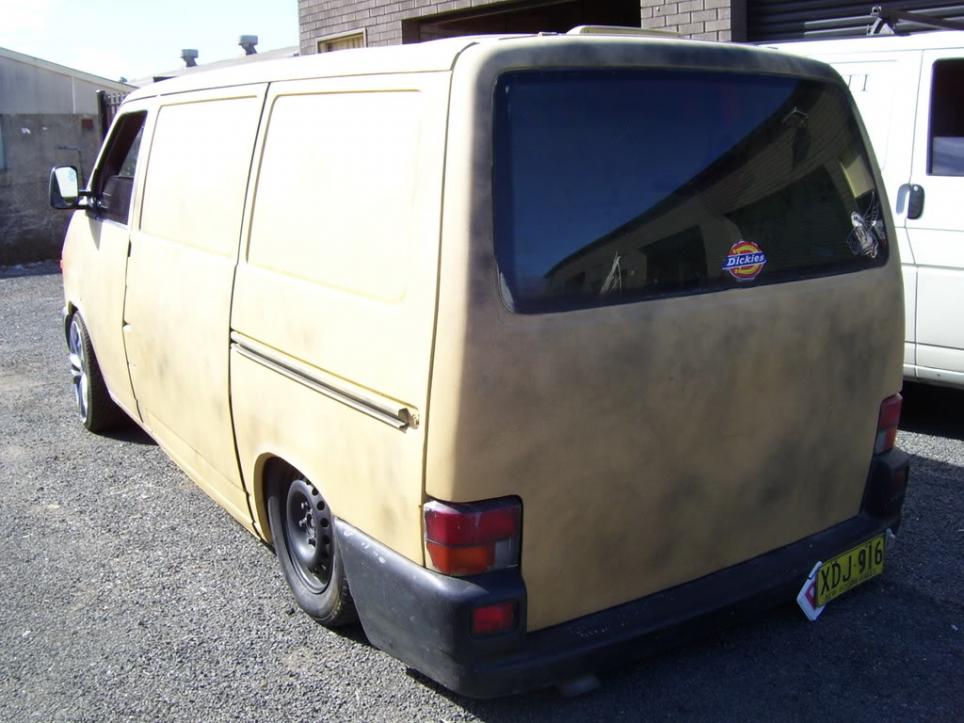

    My work van is a 2L 4 cylinder 1993 build van, but is very straight and completely rust free. I ideally wanted a later van, so I didn`t have to swop dashes etc, but after looking at all the rusty and battered cheapies around, I am gonna do my one. It also has no power steer or A/C, so am gonna fit that from the donor car too. Phew.

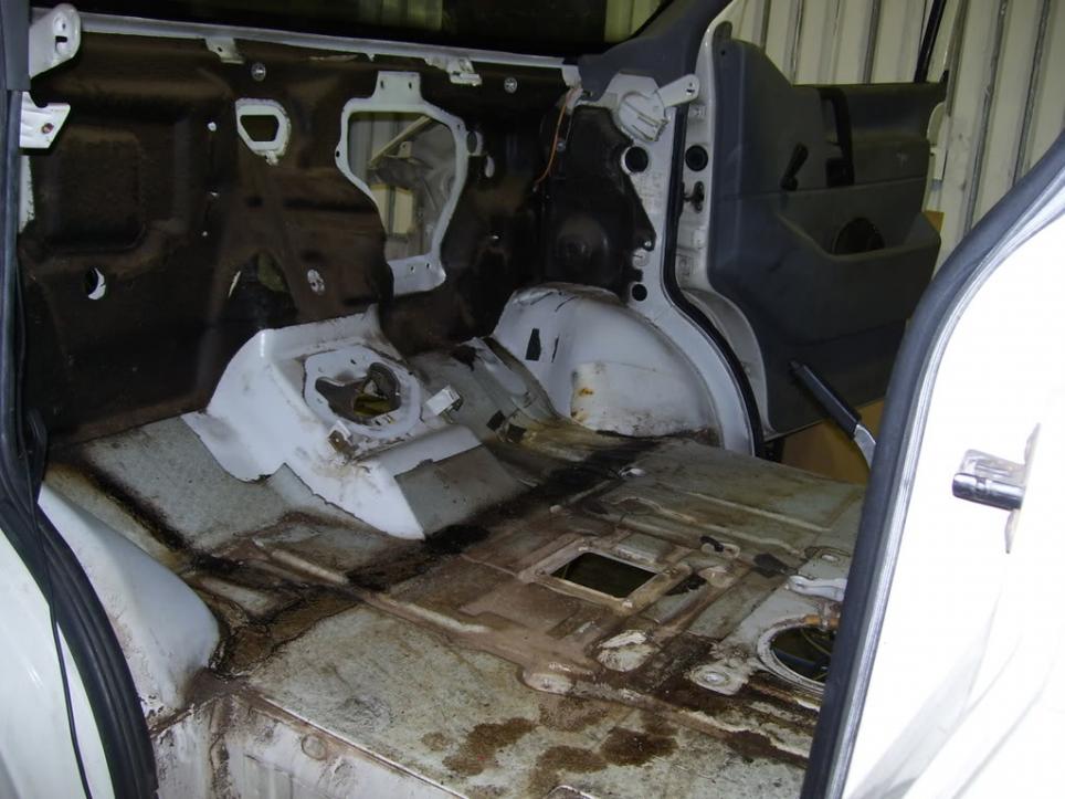

    Stage one of stripping the TDI was completed a couple of weeks ago, as I needed the space, so the shell had to go.

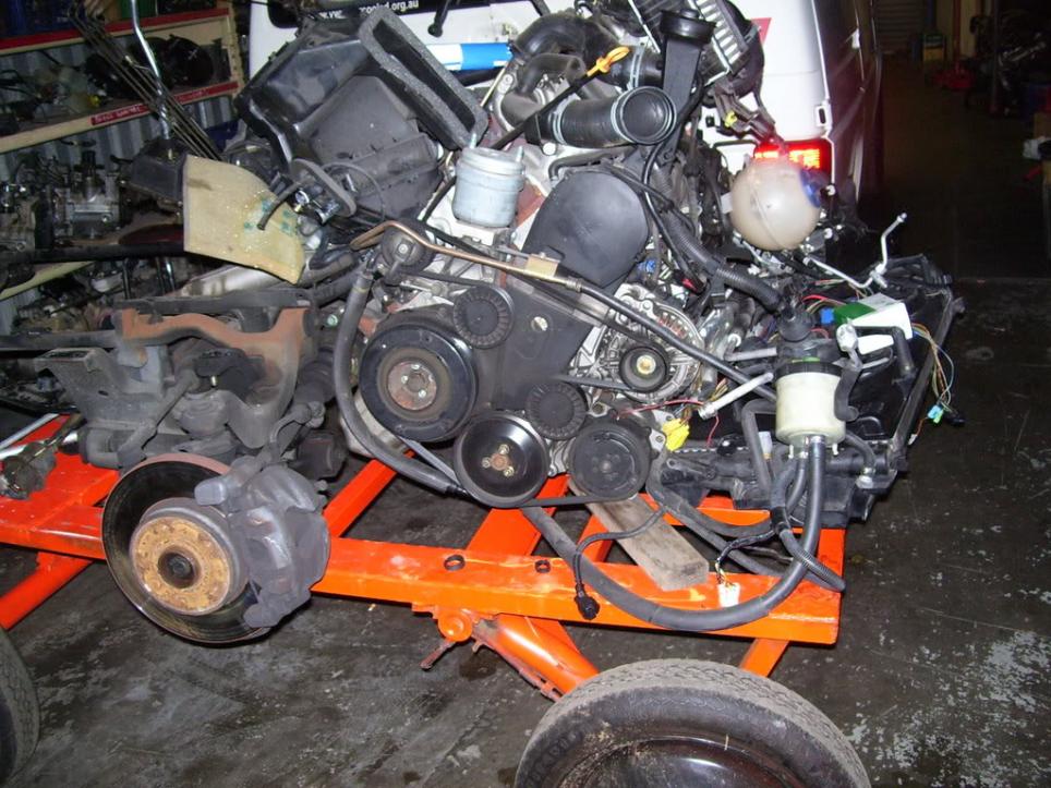

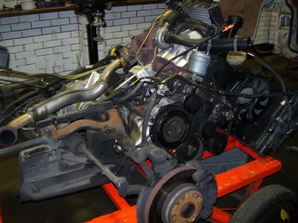

    Here is the whole front subframes and engine and box of the TDI, on a trolley ready to go.
    Stripped my van out pretty fast. Uuuh oh, we are in it now....

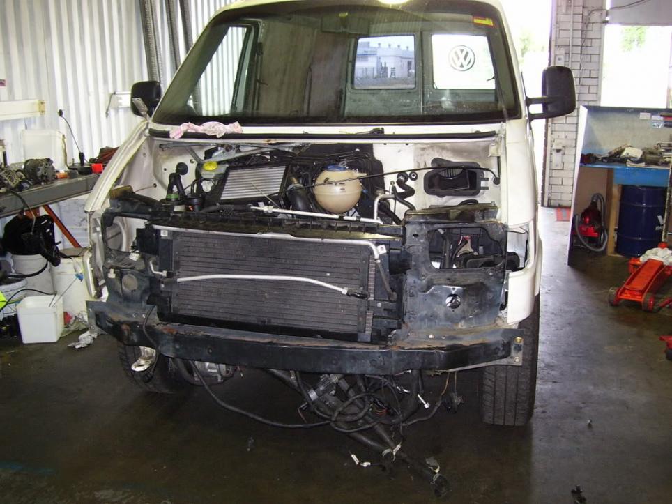

    Did the timing belt before we put it in. Safety first
    Engine hanging in by a few bolts....
    loverly power steer

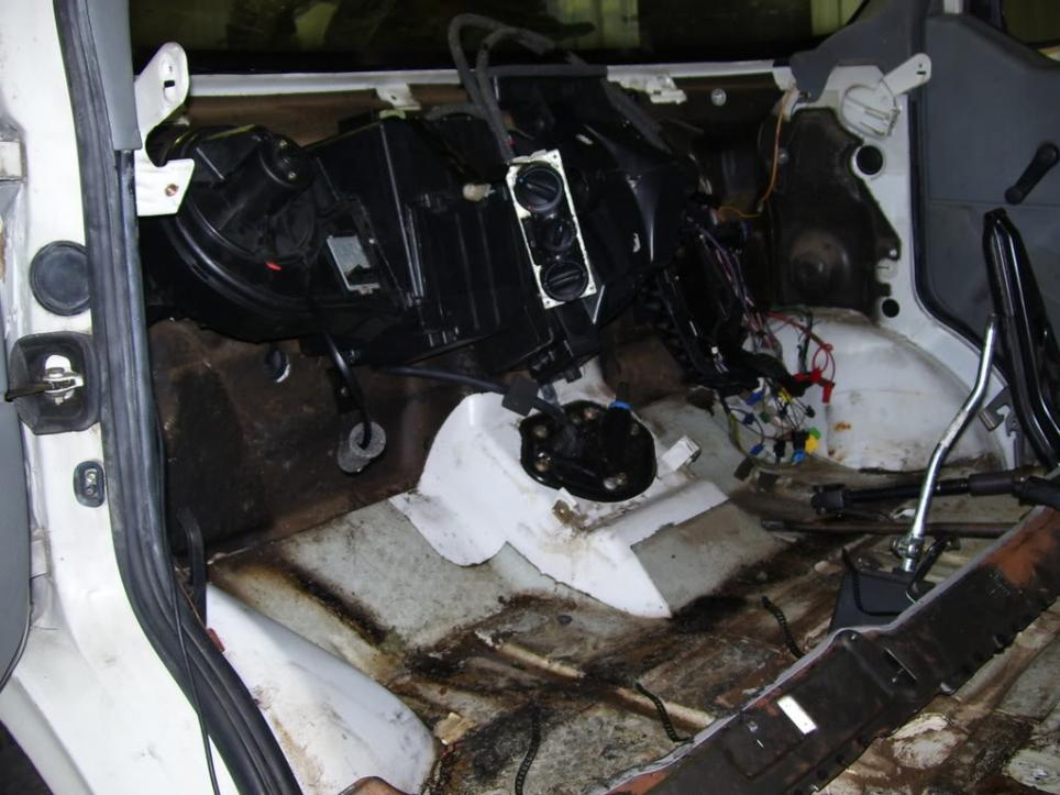

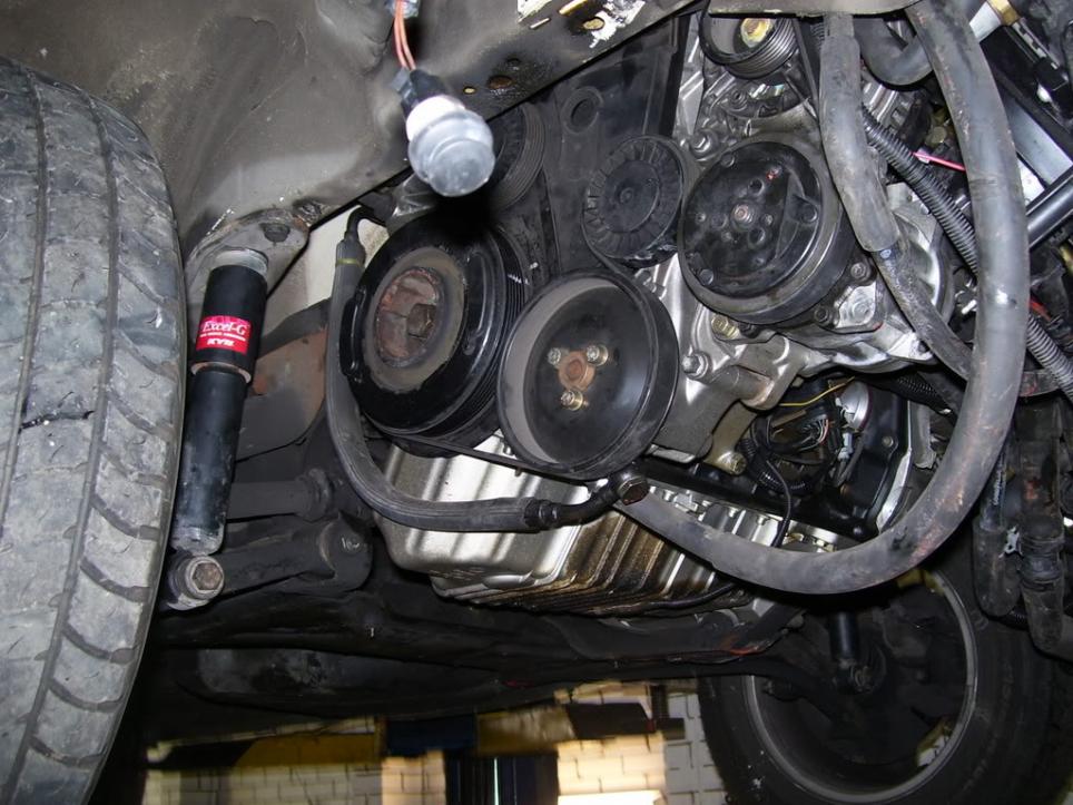

    AC Unit, Booster, MC, Shift linkages are in

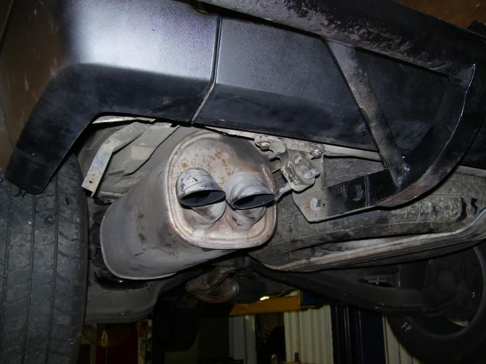

    Diesel exhaust system and the rear disks and axles for good measure, mine was drums.

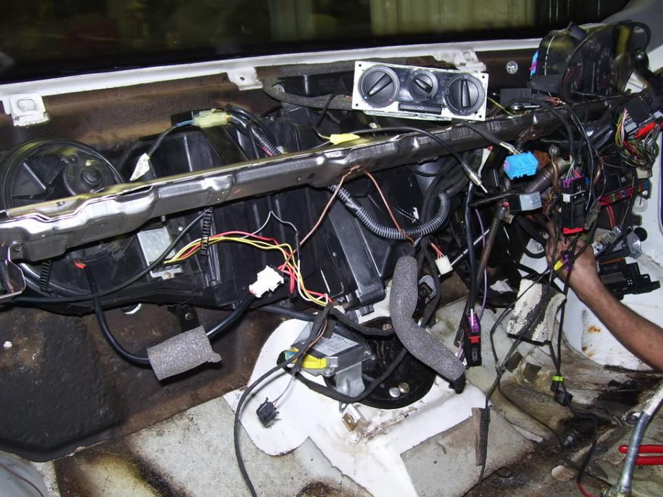

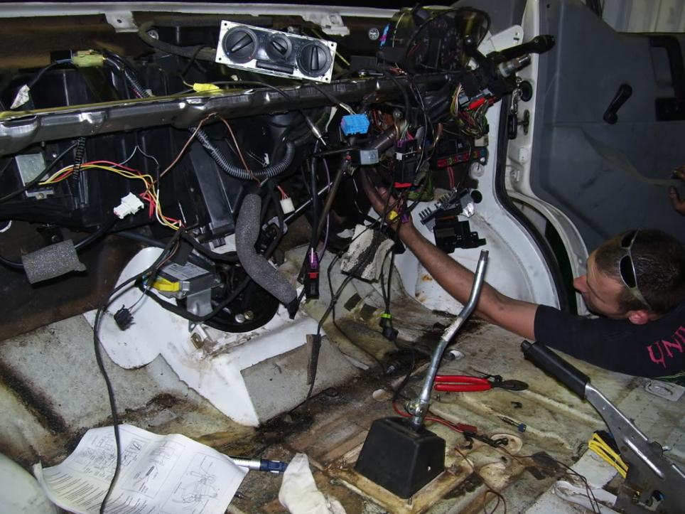

    Wiring
    Wiring

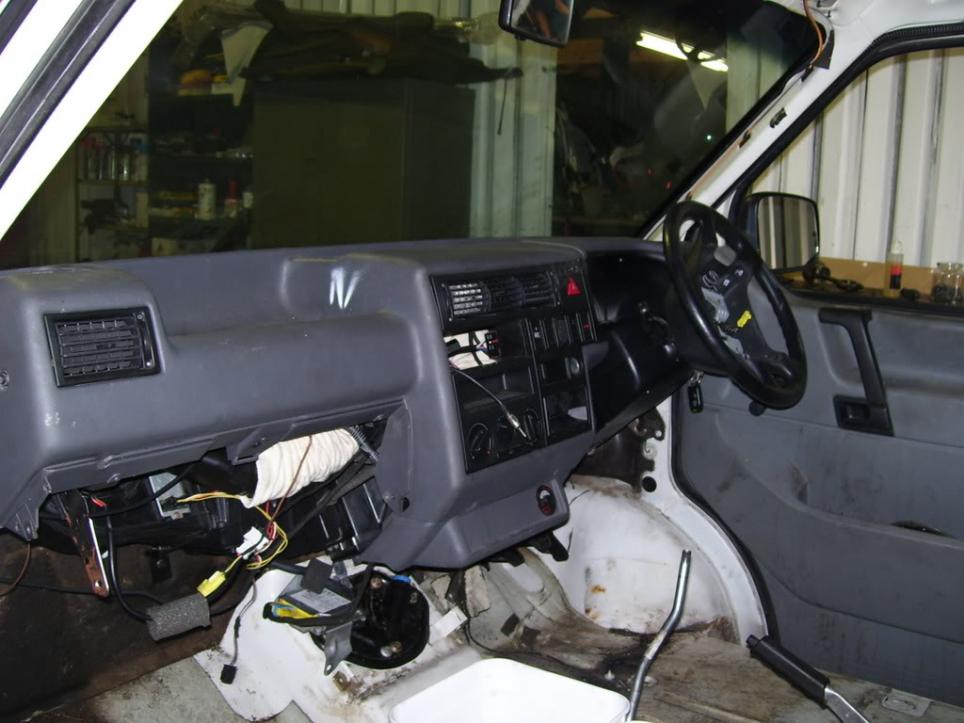

      Finally dash, I`m gonna have the TDI clocks, cool blue faces and the badass steering wheel and airbag system

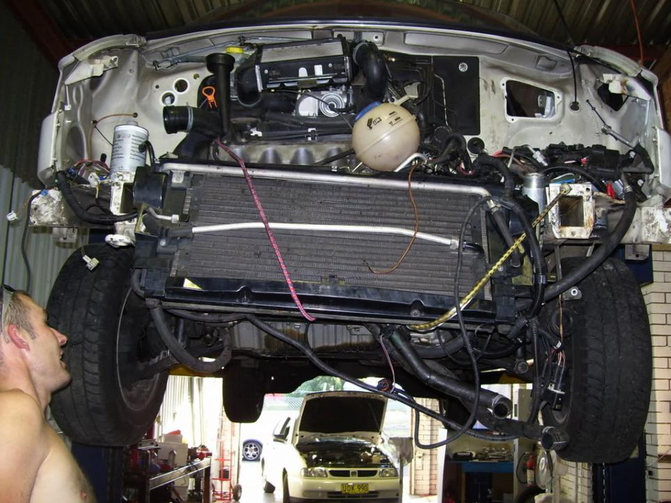

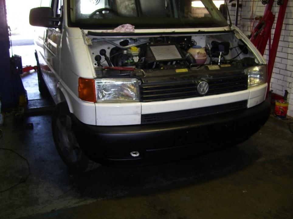

      Front end coming together

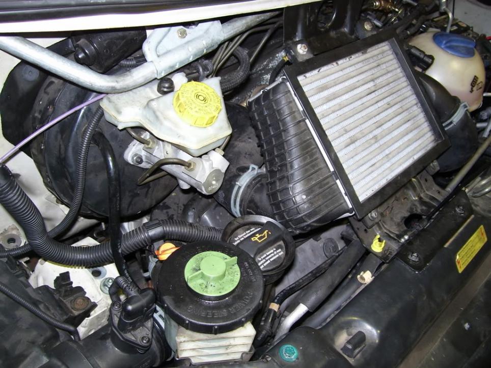

      Modified the airbox, as my guards dont have louvres, power steer bottle is a tight fit
      Gonna finish the inside, fit an amap and stereo to combat the diesel noise and hopefully finish it tomorrow.

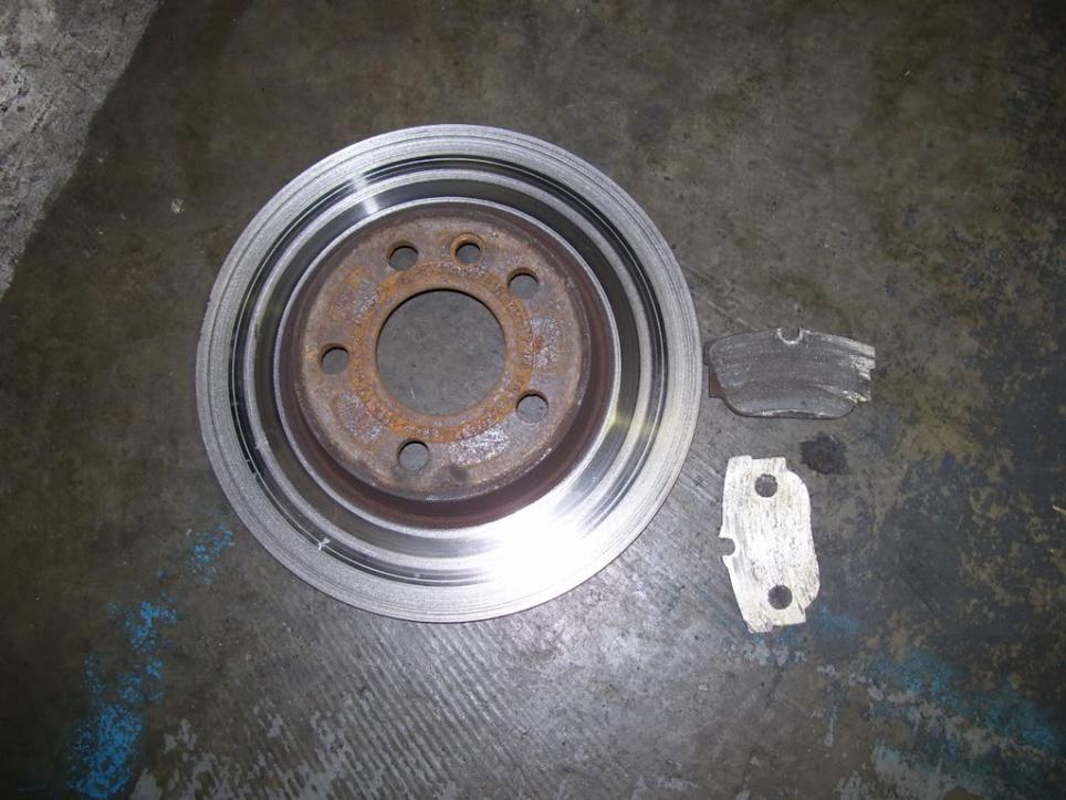

                    Rear brakes started scraping bad on the way back from rego. The pads are cactus. Couldn`t drive it any further like that. Will get some disks and pads tomorrow and make it sweet.

                        Back brakes ridiculously bad.
                        When the pads wear out children and the metal scraping becomes very loud, change em.
                        I now have new discs and pads and the car stops well now.

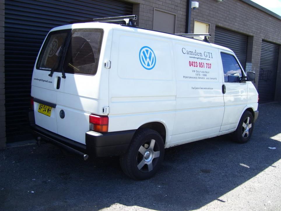

                        TDI springs make it very high and unweildy at the back, might put the 2L petrol ones back in. It used to handle better as a petrol.

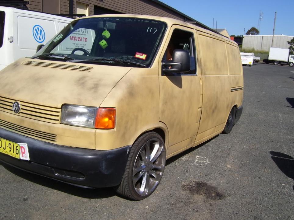

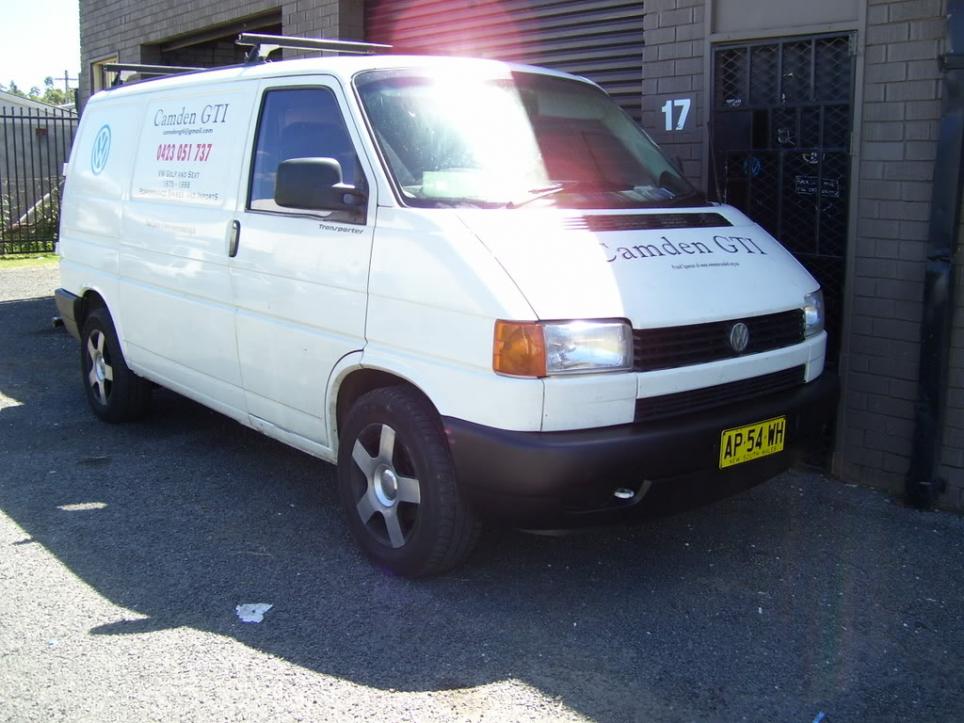

                              Finally took a couple of pics.
                              Still high at the back with the Diesel springs am gonna put the petrol ones back in.
