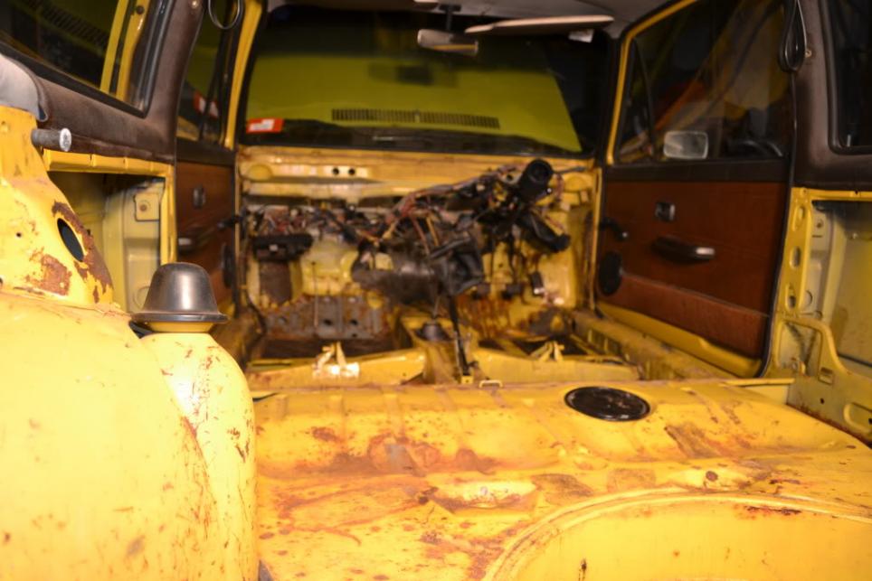

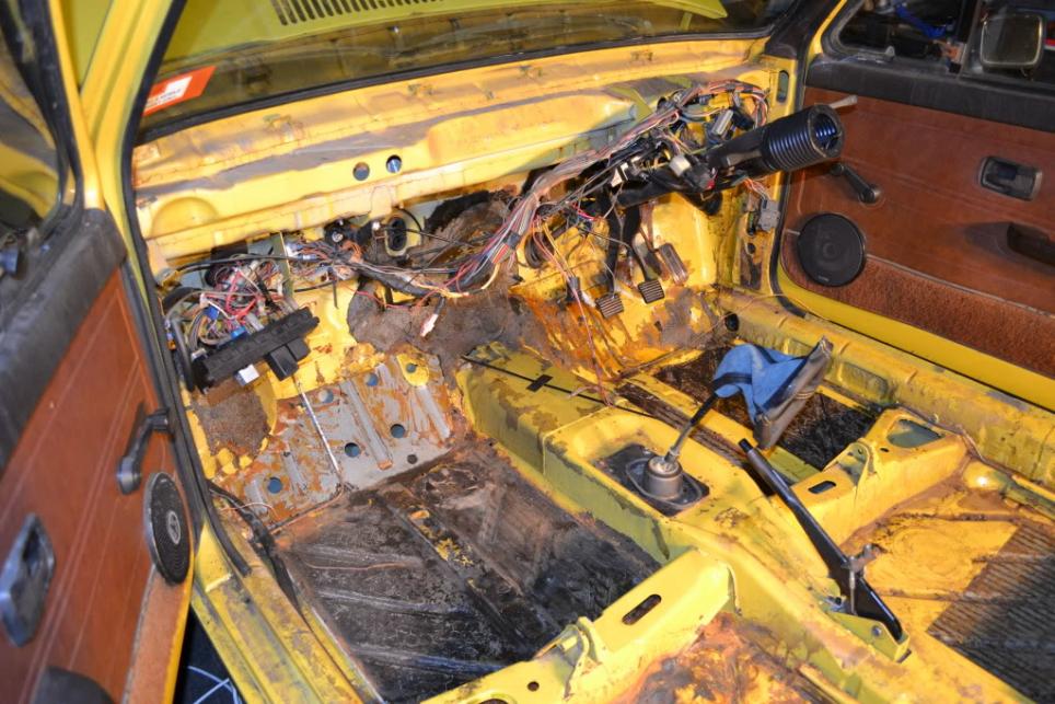

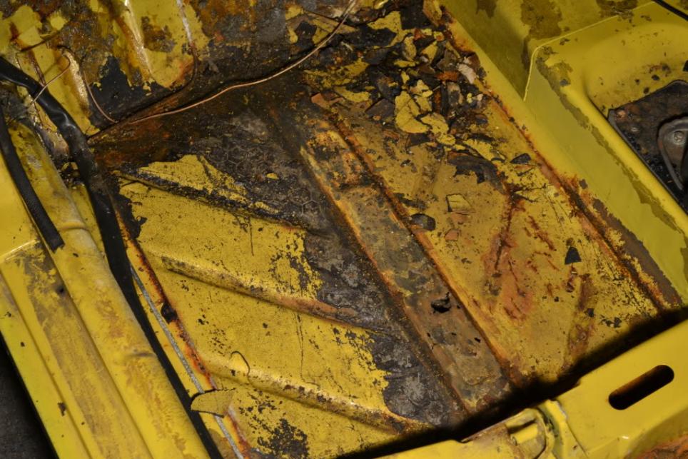

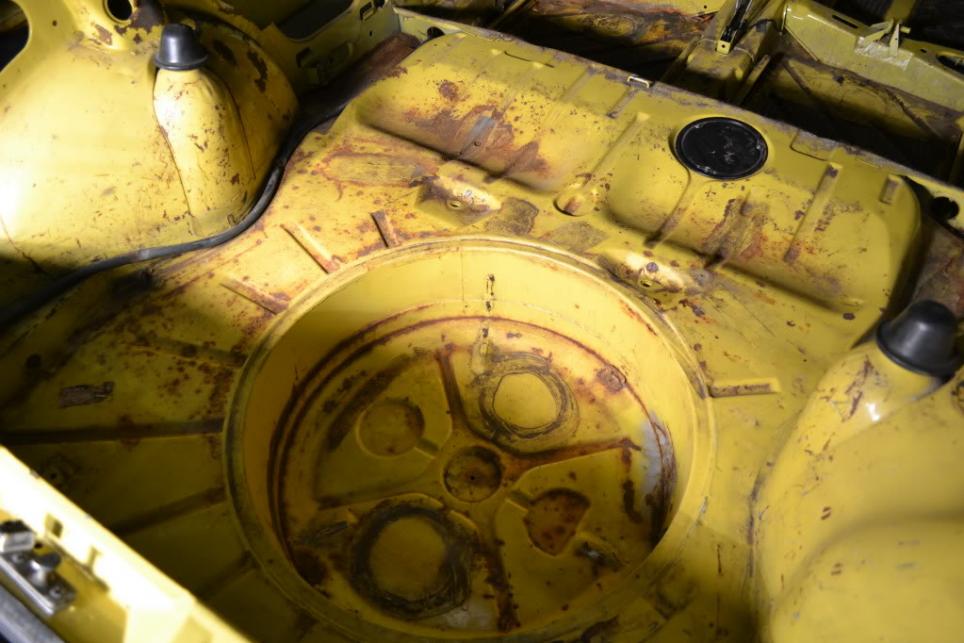

The rust, leaks and bodywork I will leave to a pro, as I want to make sure I'm starting with as solid a base as possible. I can't realistically afford to do a full dip/bare metal job all over as my budget for the bodywork is well under the ~$10k it's been suggested to me that may cost. I'm hoping to get away with under $5k...ideally, well under.
Paint/presentation has been demoted well down the priority list (no silky smooth engine bay for me), structural integrity is my main aim.
