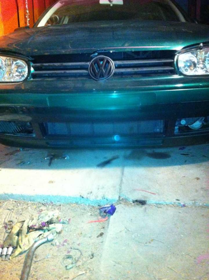

Very eventful night tonight!!
First of all tonight I checked all the earths on the wiring. She started and then died.. Immobilizer was kicking in. So checked that I had changed the instrument cluster like I thought I had, and well I hadn't. So put the gti cluster in and you wouldn't believe it... It started!!
I had to change the transmitter in my key to the gti one but it workednow...
So I tried to rev the car and see how she went. Well it's got a cable throttle so now I have to hook it up but otherwise everything is running without problems..
Tomorrow night I'll get the cable hooked up and see how she drives... I can't wait
Will let you all know how it goes.. Thanks to Stan and Jmac for helping with this.
Just thinking of it the motor must weigh more then the old one, it's now sitting alot lower in the front.

Awesome mick!
Still do a vagcom code clear, keeps the computer nice.
Your front springs were for the 1.6, so will ride lower, they may be a bit soft too, watch for bottoming out.
Did you upgrade the brakes, they are for rhe old engine as well
You might get an error light on the dash for the brake pad wear sensor, if you dont have those hooked up
Well done mate .
Na left the brakes as my model uses the same rotors and calipers. Plus I've already got slotted dba rotors on her.
I've got no error codes at all or no fault lights on the dash. She is a happy carjust need this cable hooked up and I'll be right
'01 Mk4 Golf GL, Engine swapped to 1.8L GTi motor, Whiteline Swaybars, Nolathane & Pedders Bushes, K&N Oversize Pod Filter, 2 1/2 inch Cat back exhaust
Good job then, looking forward to hearing the throttle is sorted. I found there was a difference between the original cable and the gti one. Ended up cutting it down a bit.
Cable is fine, should be a hole high on passenger side of firewall, cable attaches to the top of the pedal lever there, then out and across to the throttle body
Having a cable also means it's not too hard to run aftermarket cruise control, as it actuates the cable: my next project
you using the accelerator pedal from the 1.6? On mine the extension of the pedal goes all the way to the top of the firewall and if you prop the pedal in the fully out position is just about touches where the hole in the firewall is - simply clip the cable in that end (simple slotted hole in the top of the pedal extension) and run around to the throttle body.
If you can reach the top of you pedal from inside the car (if yours is different) simply feed the cable through until you can reach it and attach it..... go in through the firewall from the engine bay side and feed it down anywhere pretty much - way easier than feeding it out from inside the cabin.
Hook it up. test that you arnt getting any trouble from other cables etc from behind the dash...
hope it goes well mate - you are pretty much there now
After our chat last night the only option is to put in the gti accelerator pedal. Love the engine recording, sounds like a spitfire !
