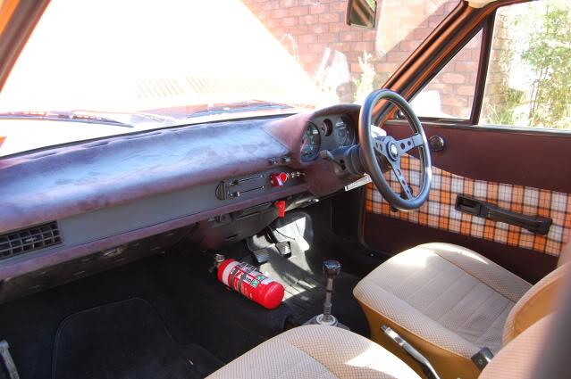

    Im my time of owning it I have done a few things:
    -New headlights
    -Fresh speedo
    -Front wheel bearings
    -Upholstered door cards
    -Upholstered dash in black suede
    -New shift linkage bushes
    -Healthy drop
    -BMW BBS Basket weaves 14x6.5 wrapped in Falken ZE912 185/55R14
    -Twin 40 webers with Pipercross sock filters
    -Basic two speaker stereo
    -Edead sound deadening
    -Redyed original carpet

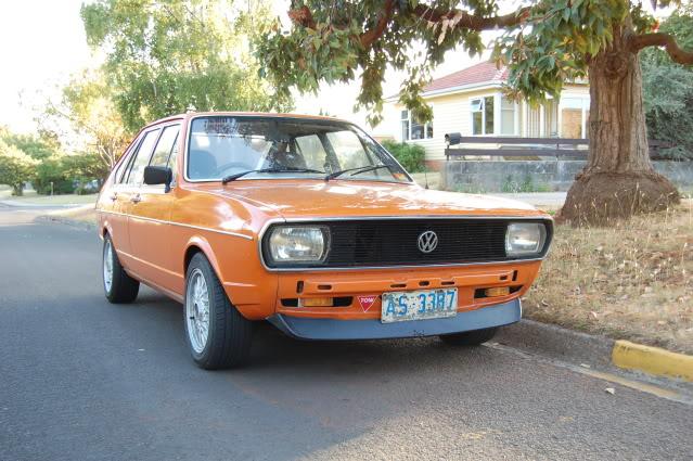

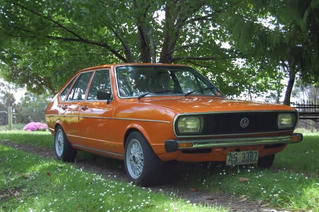

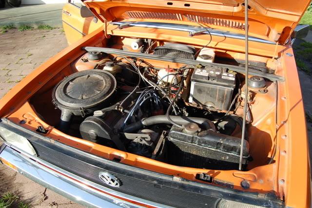

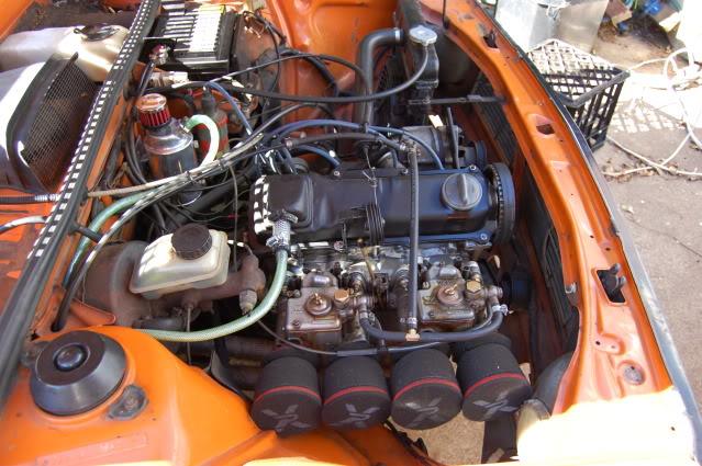

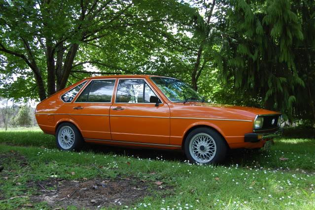

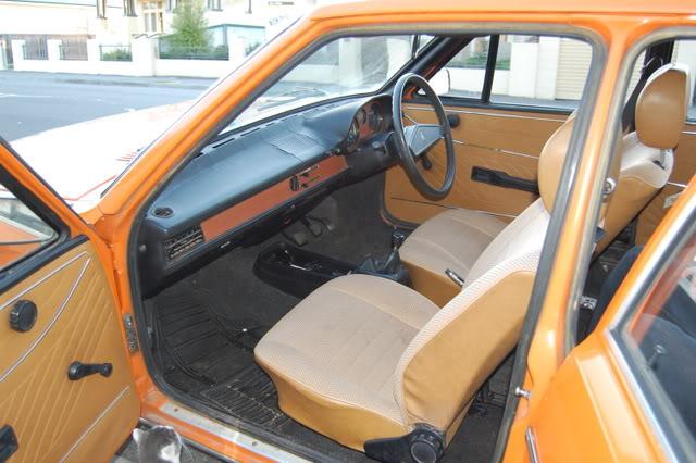

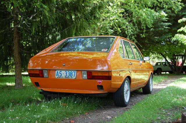

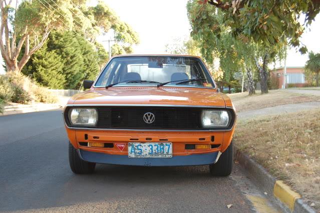

    Heres a few picks of how it was to how it is now
    How it was when purchased.
    And how it sits today

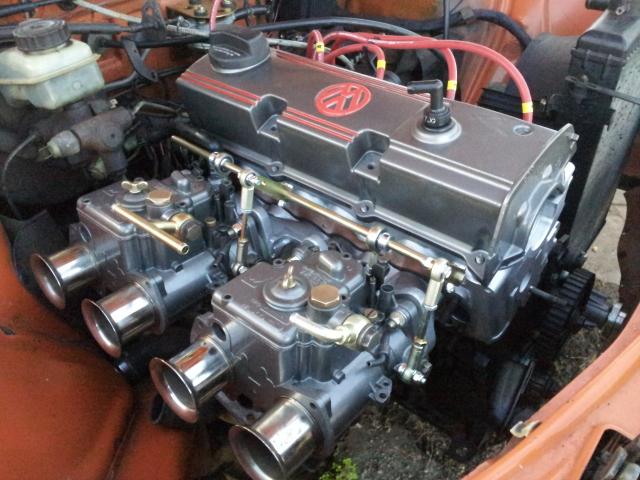

    Im trying to sort out what kind of jets I need to run the 2.0 engine while staying with the 40's rather than going 45's.
    Pulled the current jets out to see what size they are for curiosity reasons, knowing that no matter what size they are they will most likely have to be change.
    Ok heres the current setup.
    40 DCOE weber
    Primary Venturi/ckoke - 28mm
    Primary Main Jet - 115
    Primary Air Correction Jet - 160
    Primary Emulsion Tube - F47
    Idle Jet - 59 F21
    Clearly these webers had been set up for quite a smaller engine.
    This is the jet route in thinking of taking with a 276 cam
    Venturi/choke - 36mm
    Primary Main Jet - 145
    Primary Air Correction Jet - around 190
    Primary Emulsion Tune - F16 - F12
    Idle Jet - 50/55f9

    wow, great passat mate. love the wheels too (I have them on my cabriolet
    PS - i have a passat diesel radiator if you have need of better cooling.

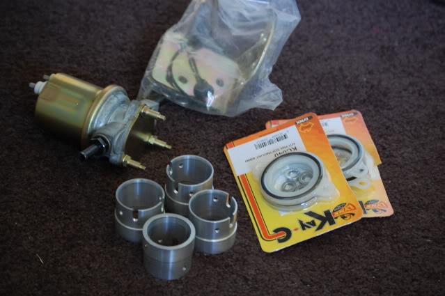

          little order came today from weber performance.
          Lynx soft mount kit
          36mm venturies
          Carter electric fuel pump P4070. 4-6 PSI

              Nice score its really neat!! I'm jealous. Thats a rare car now and rarer in that condition!
              I prefer it with bumpers and without the duckbill though...
              Are you gonna do anything with the E30 wheels (colour??)
              Whare abouts in tas are ya?
                Thanks dude
                i plan to pu tthe bumper back on but at the moment it will obstruct the number plate and I dont really want to be pulled over buy the police. A slim line number plate will fix that
                I was thinking of changing the colour of the basketweaves but I have grown fond of the original look of the wheels.
                Im in Devonport

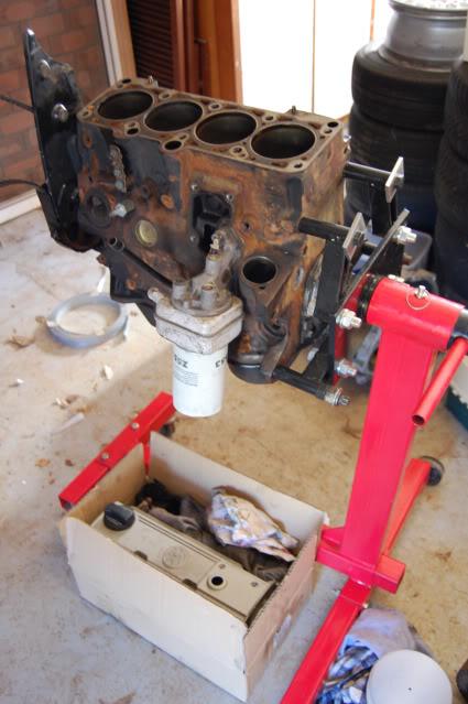

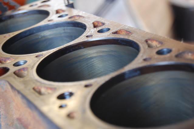

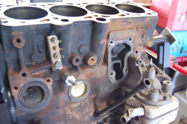

                  I received my 2.0L ADY engine and spare B1 passat gearbox late last week
                  Had some spare time at work today so took the head off for a general inspection then took it home where lives on an engine stand while the work begins.

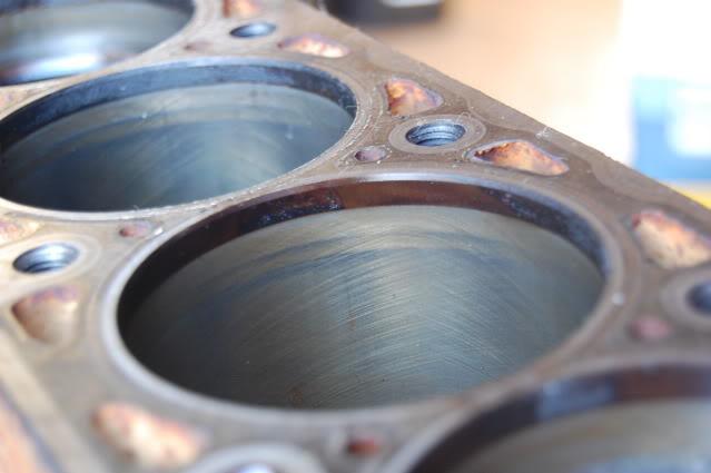

                  I was actually surprised at the condition of the head and the bores etc....Supposedly this engine has covered a fair amount of k's. The piston tops have very low carbon built up. The water jackets in the head and block arnt too bad at all and the bores still have honed markings on them.
                  Current plans are to strip the block, inspect the pistons, bearings, rings etc and then take the block and pistons to our local engine re-builder so he can measure the bores and pistons and tell me if I need to go over-sized or just new rings
                  While the engine was a work I fitted a welsh plug to one of the crankcase breather holes and will make up a plate for the other hole just bellow the engine number.

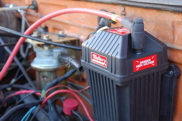

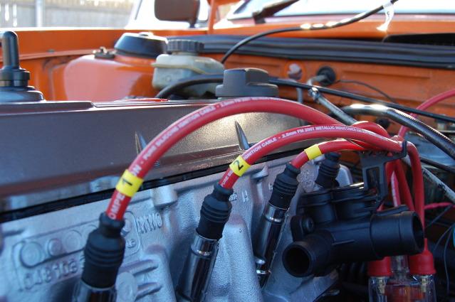

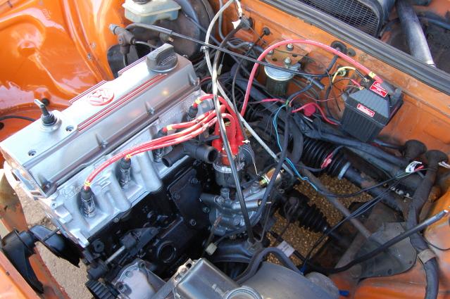

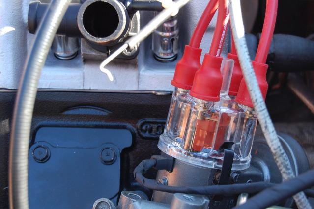

                          Change of plans with the head. Had a bit of drama so decided to run it standard with the addition of a techtonics tuning 260 cam and ported and polished exhaust ports.
                          Still a little to go. More clean up of wiring, sort out coolant hoses and other maintenance stuff.
