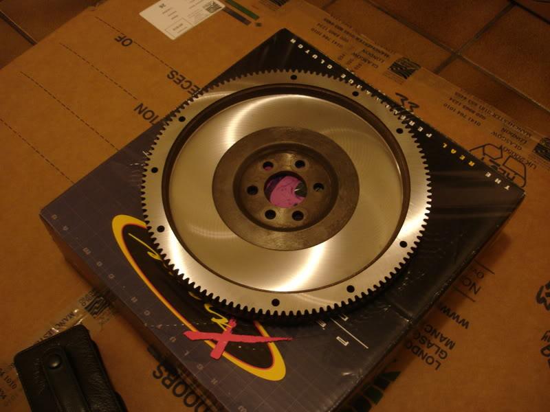

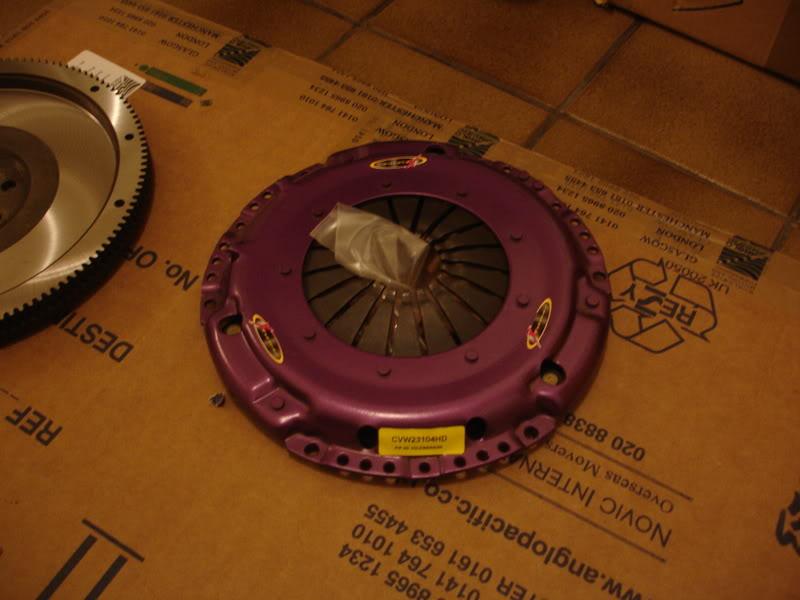

    Just about to drop a new clutch and flywheel in my A3 1.8T. The standard clutch has just started slipping and as one day soon I will be sticking a big turbo on, it seems a good time to upgrade.
    After extensive reading on the net, it seems that fitting the flywheel from a G60/ABF etc and clutch from a VR6 is the way to go.
    I was quite sure I would get a kit from ECSTuning stateside but the shipping was silly. In the end I got a lightened flywheel from Golfloon and an Extreme clutch kit from Extreme here in Adelaide. Was pretty big money but is a step up in spec from the ECS kit, closer to their stage 3.
    Photos and write up to follow.

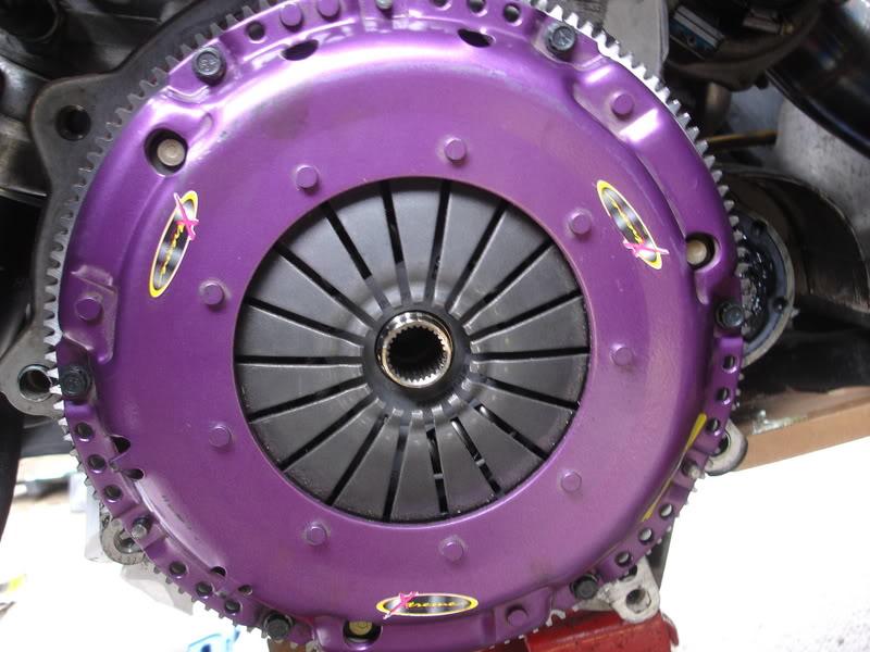

      800 for the clutch and 160 for the flywheel from Golfloon. 40 to have the clutch people face the flywheel. A grand all up. Fitting not too bad but need to address a really low biting point.
      It stalls pretty easy now if you are not careful due to the reduced weight of the clutch and flywheel over the dual mass.
      It should be good for over 300 hp. Standard VR6 plate and uprated cover.
      Gavin

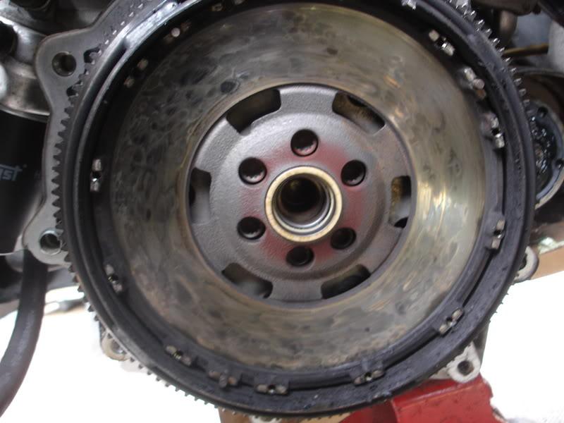

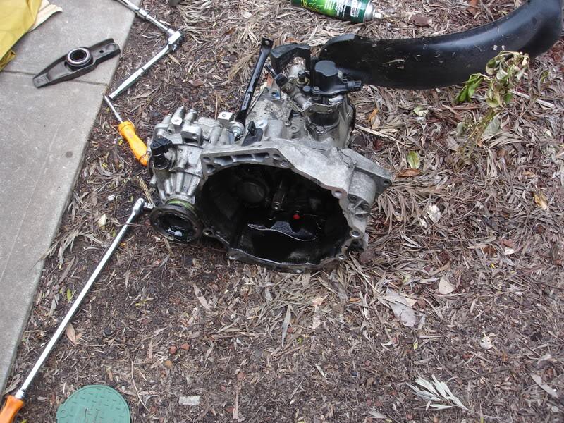

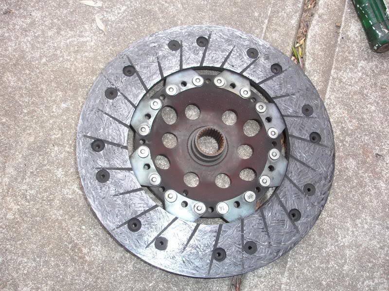

      the new one fitted up
      the old one before removal
      dead plate

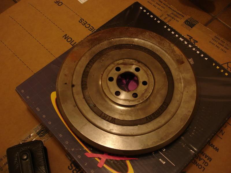

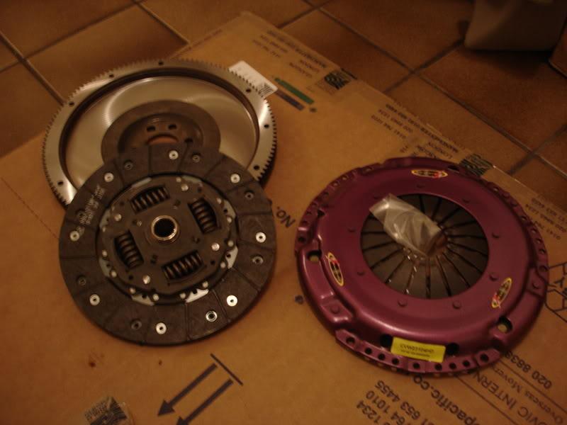

              h100vw, I know what you mean with the lower engagement and stalling - I've just done the same thing and I'm still trying to get used to it.
              I've got a Eurospec G60 single-mass 14lb flywheel with my uprated clutch/pressure plate
              Torque Rating it can hold : 415 ft/lbs.
              Now, to buy new rubbers and engine mounts..........
              Wait until I get home, I'll post the DMF shots....
