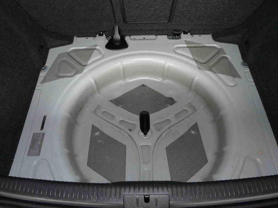

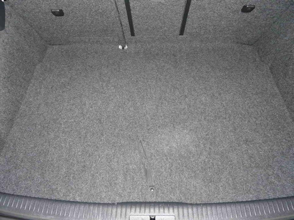

    1) removed everything from boot:

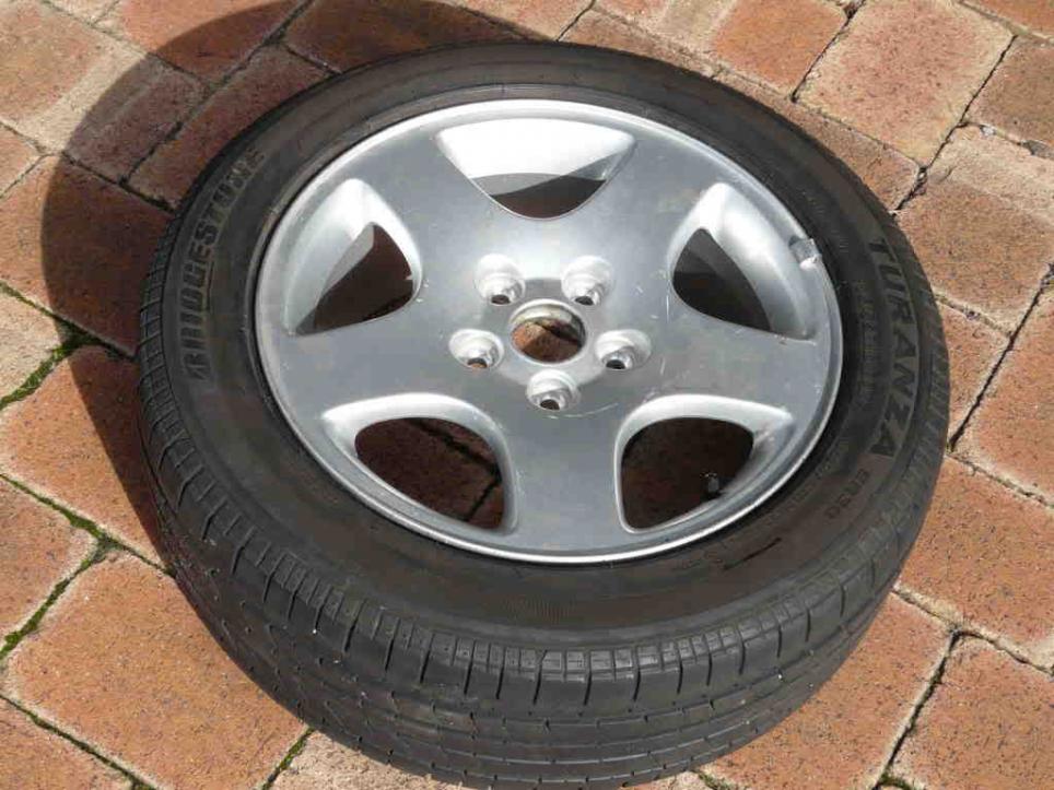

    2) second-hand rim and tyre from Swan Tyre Service (Osborne Park WA)- Audi ?A4 rim (16inch, 5/112, ET+45, Centre Bore : 57.1mm) and Bridgestone Turanza 205/55 tyre) Price $180:

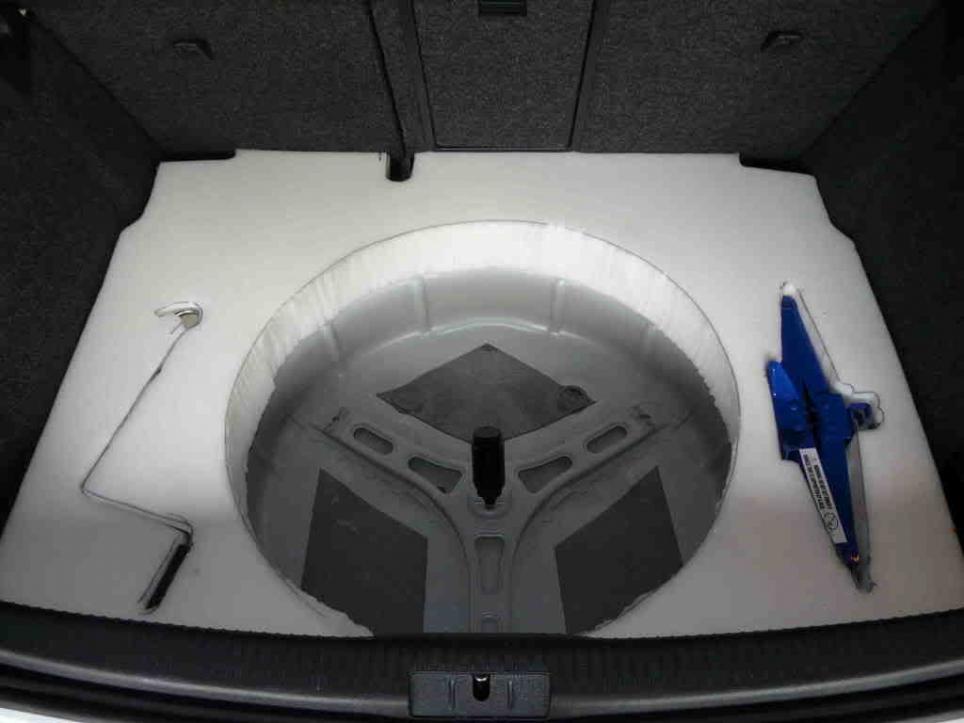

    2) high-density (10cm thick) foam from Clarke rubber that they cut to the shape of the boot insert and I cut out a circle for the wheel ($80). Scissor jack added as I think the standard VW jack is rather ordinary:

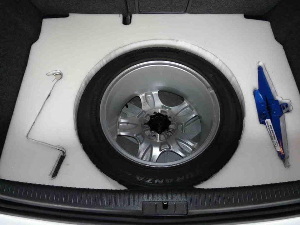

    3) Wheel in place:

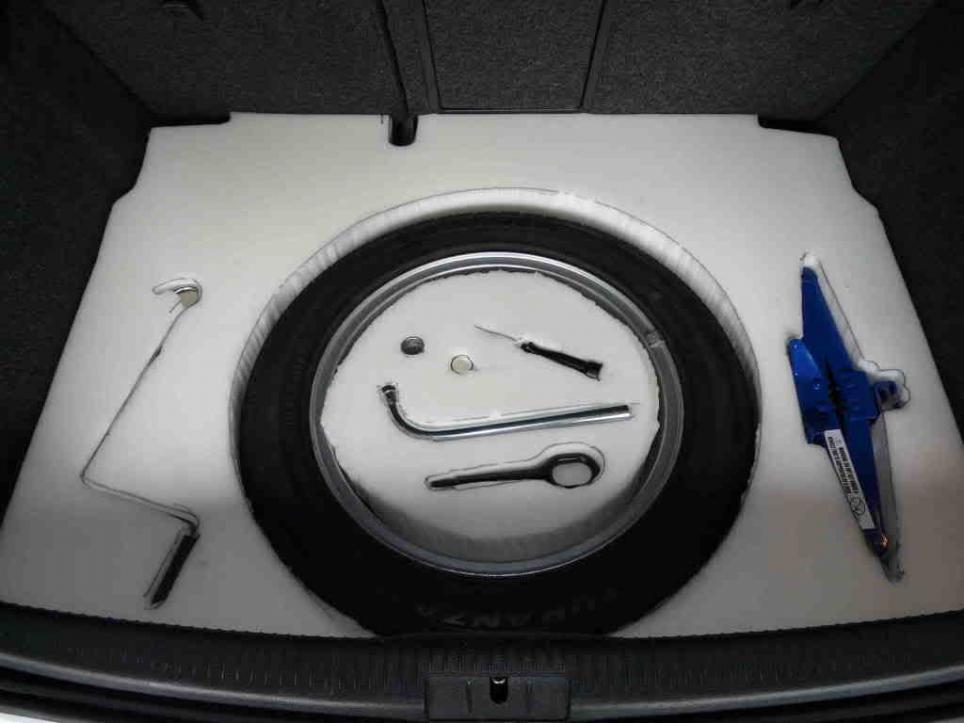

    4)Tools added to centre of wheel:
    5) The finished product:

              I don't think the 16" rim would fit over the brakes
              Resident grumpy old fart
                Ah, that is a shame... Looks like I would have to buy another second hand rim and tyre then... but keep the foam!
                Golf VI GTI MY13 Candy white/ DSG/ Detroits/ tint/ reverse camera/ parking sensors
                2016 Skoda Octavia 162TSI RS Wagon (Silver/DSG/Tech pack/ Black pack)
                  You'd probably have to add an extra (thin) layer to allow for the wider rim/tyre too.
