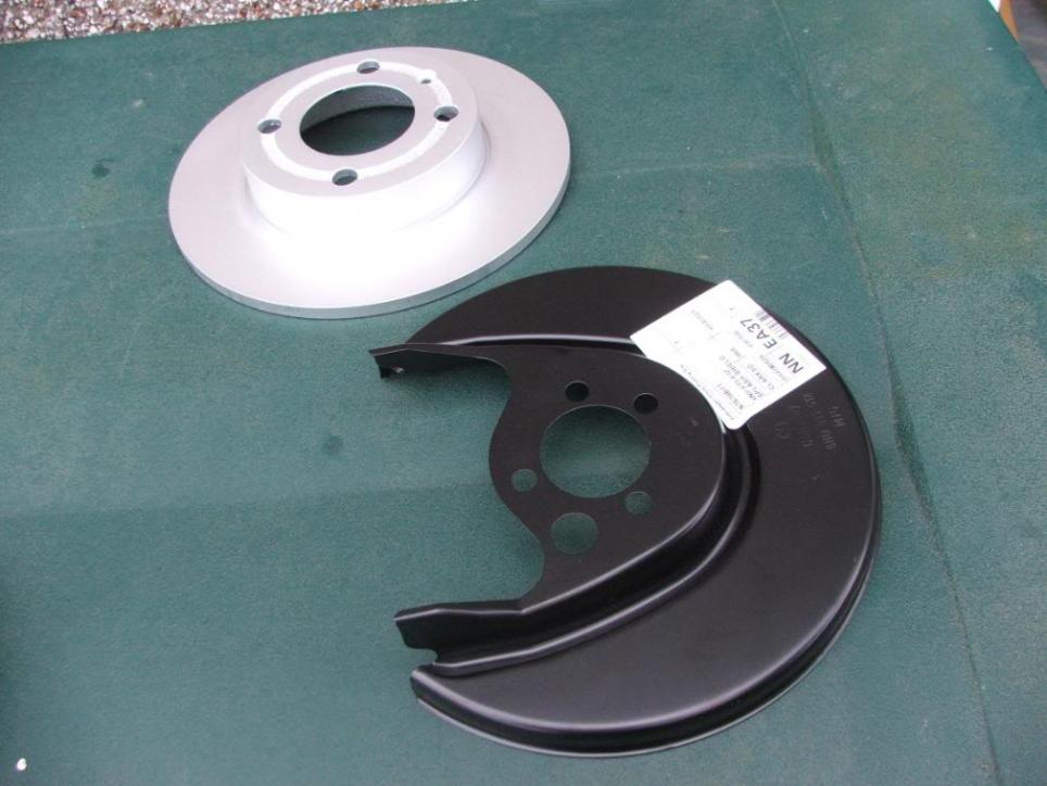

Discs and back plate

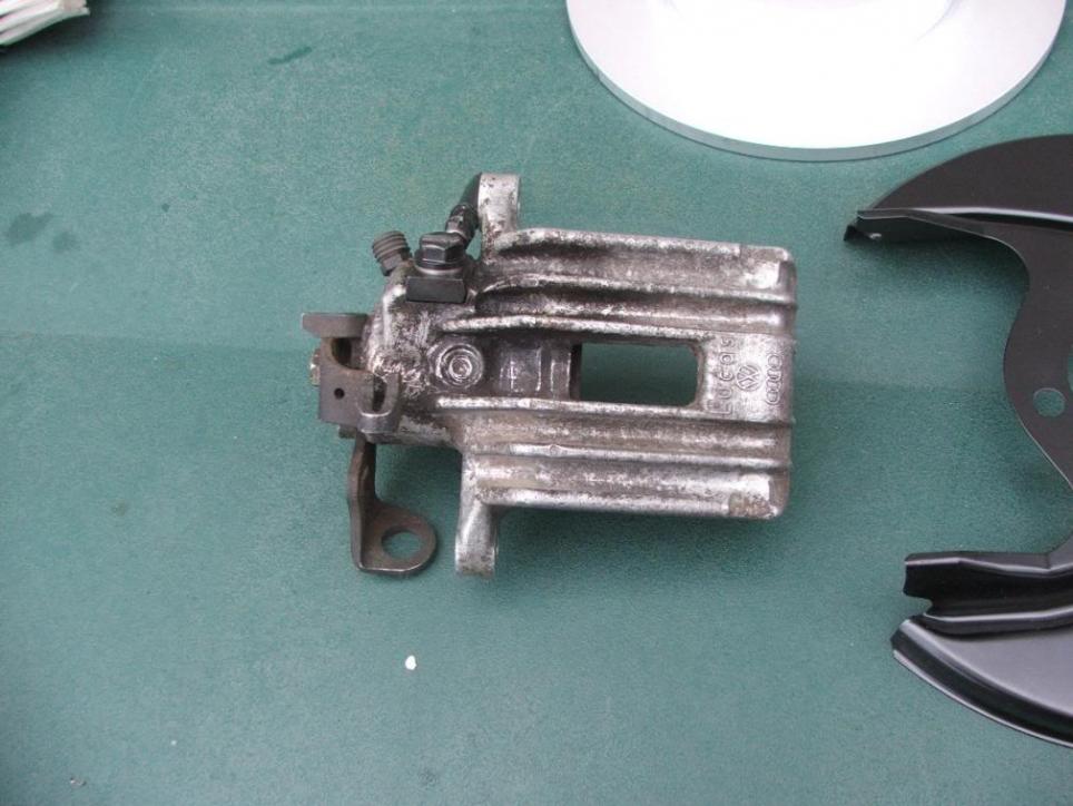

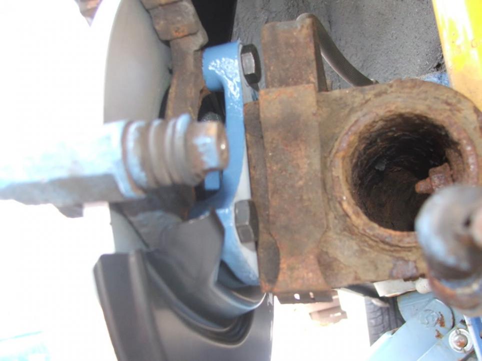

Polo caliper

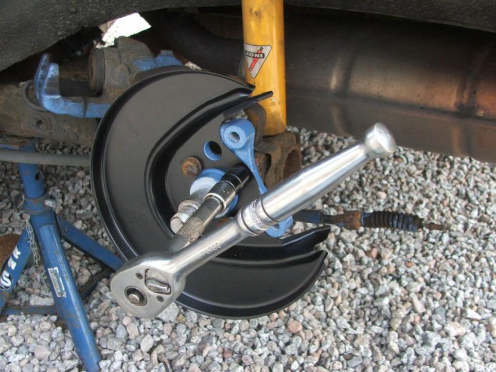

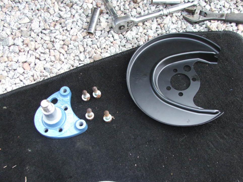

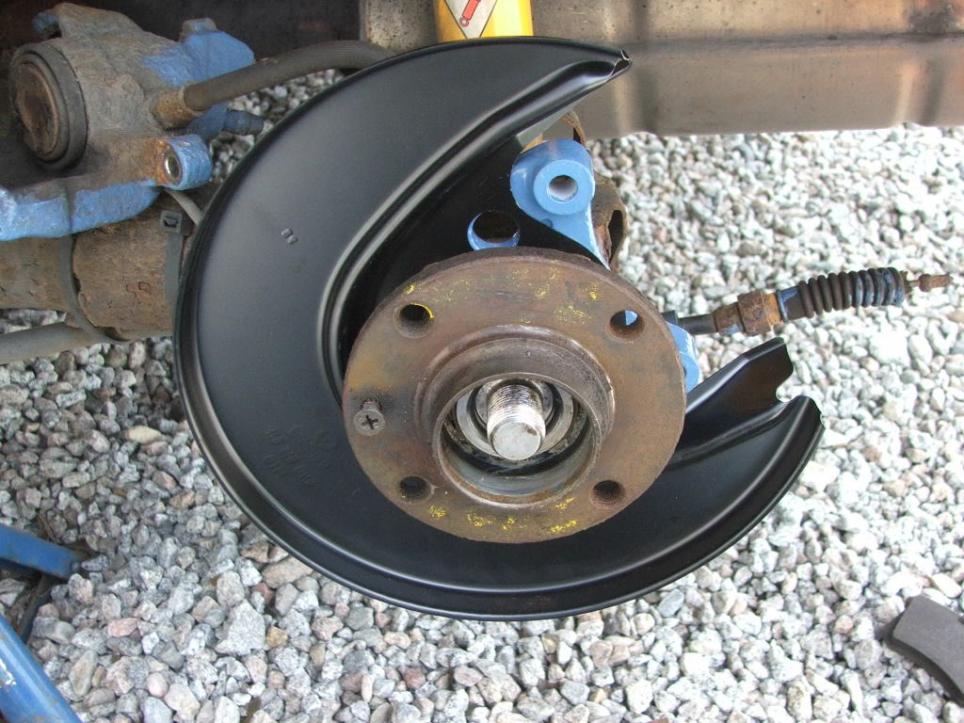

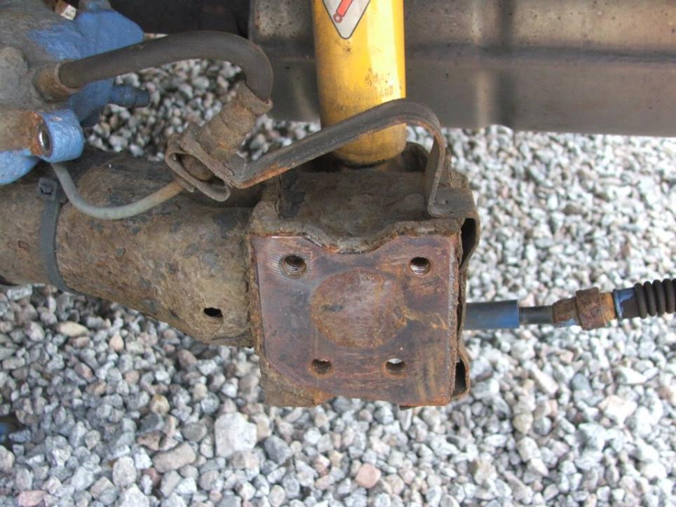

With all the old stub axle removed you should be left with this.
If you have a mk1 at this stage you will have to grind the bottom rear corner to let the stub axle sit flat
It is best to clean the axle threads out with a M10 tap since the Polo bolts are a bit longer
New stub axle and stone guard
ones the stub axle face is cleaned up you can fit the axle and back plate
and torque the four bolts to 60 nm or 44 lbf ft

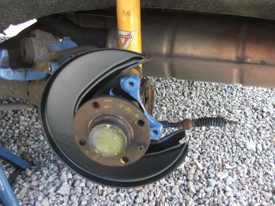

then you can fit the hub new hubs will be pre-greased but i tend work some grease
in to the bearing then torque the self-locking 12-point nut to 175 nm or 129 lbf ft
then fit the cap don't over fill with grease or the cap will blow off

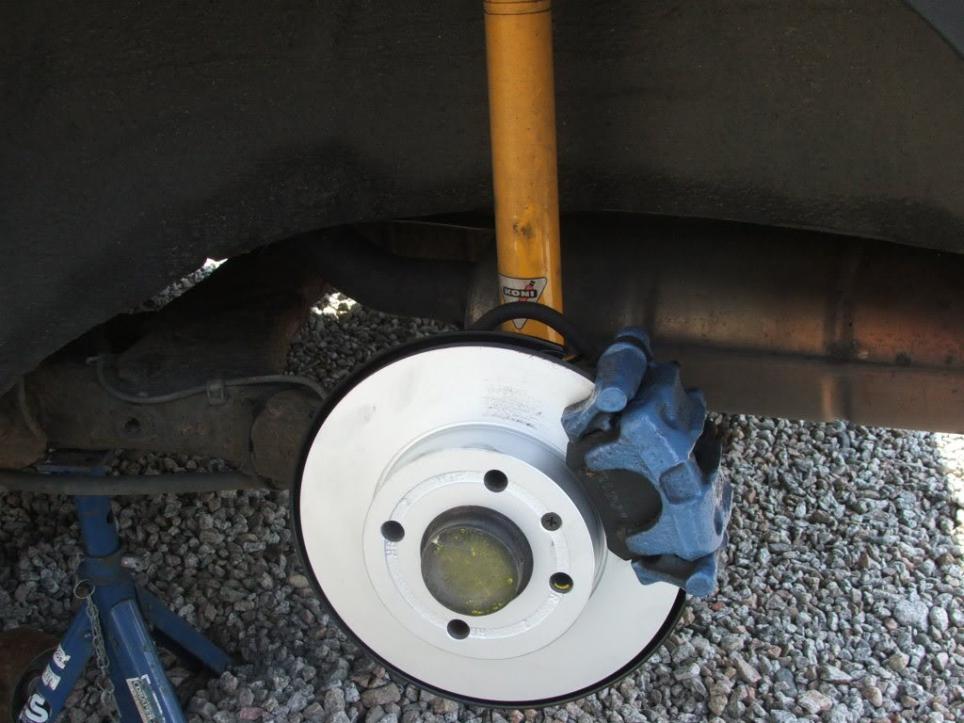

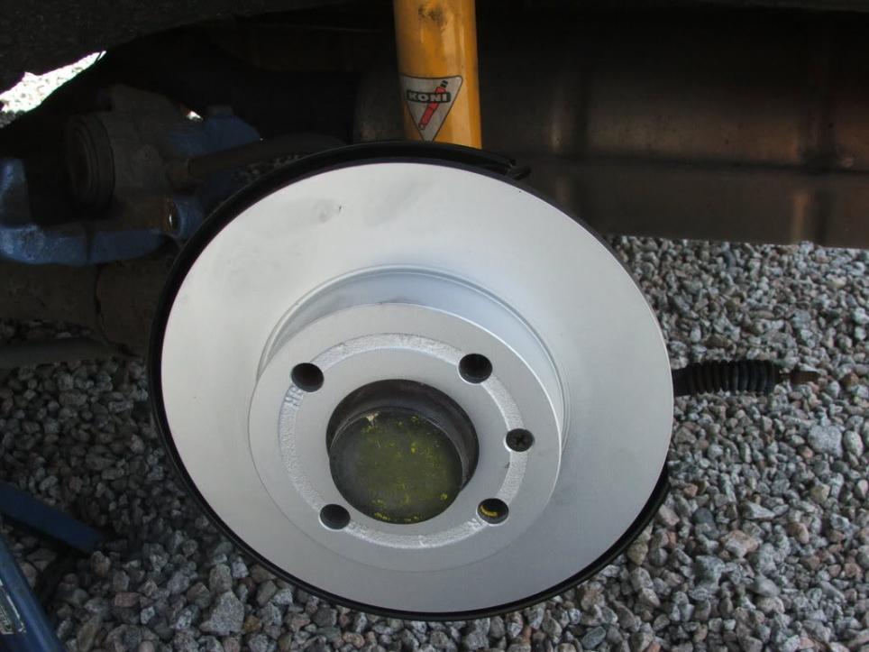

Then check the hub face is clean and flat and fit the brake disk and tighten the screw
Fit the carrier and torque to 65 nm or 48 lbf ft
Then fit the pads and reset the pad clearance on the caliper and fit bolts and torque to 35 nm or 26 lbf ft
Refit the hand brake cable and adjust
Fit wheels and torque wheel nuts to 110nm or 81 lbf ft with the car on the ground
then work the hand brake and pump the brakes
