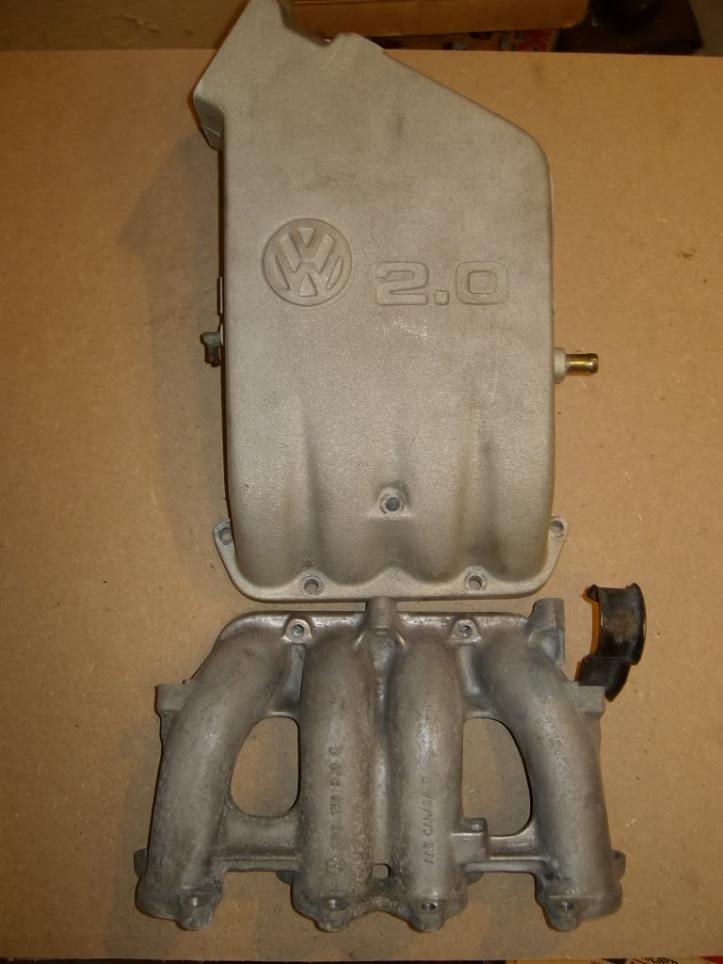

                        This is an ABA inlet manifold. It has mounting holes on the top and bottom of the runners.
                        This is a mk2 8v counter-flow inlet manifold. All of the counterflow heads have the same runner spacing and manifold bolt provisions.
                        These are not interchangable. The ABA, i believe, uses a US specific head, with a similar bottom end as the AGG motor. The early ABAs apparently came with squirters for pistons and the late model ones didn't. There are different schools of thought on their necessity but many are adament that they're really quite useful.
