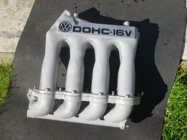

                      Engine cleaning beginnign this week also, going to paint the valve cover tornado red or black and clean and polish up the intake mani. Camera is busted atm will get pics up soon.
                      • #26
                        The inlet manifolds look pretty good grit blasted back to clean alloy, then polish the 16V dohc bit and paint in the letters.
                        I did one in powder coat gloss back and sanded off the flat and polished that. I'll did out the picture in a minute.
                          Yeh thats actually what i meant will do the letters in T red too.
