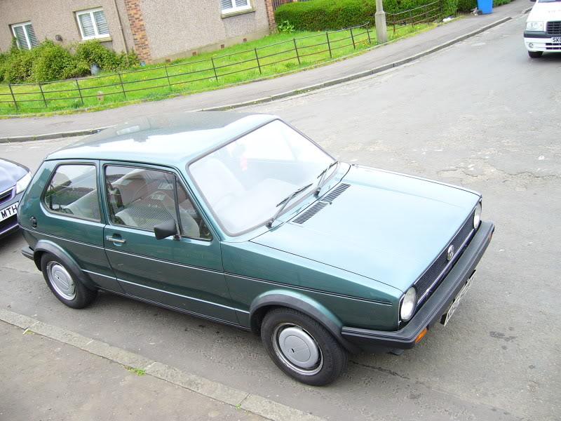

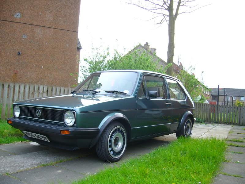

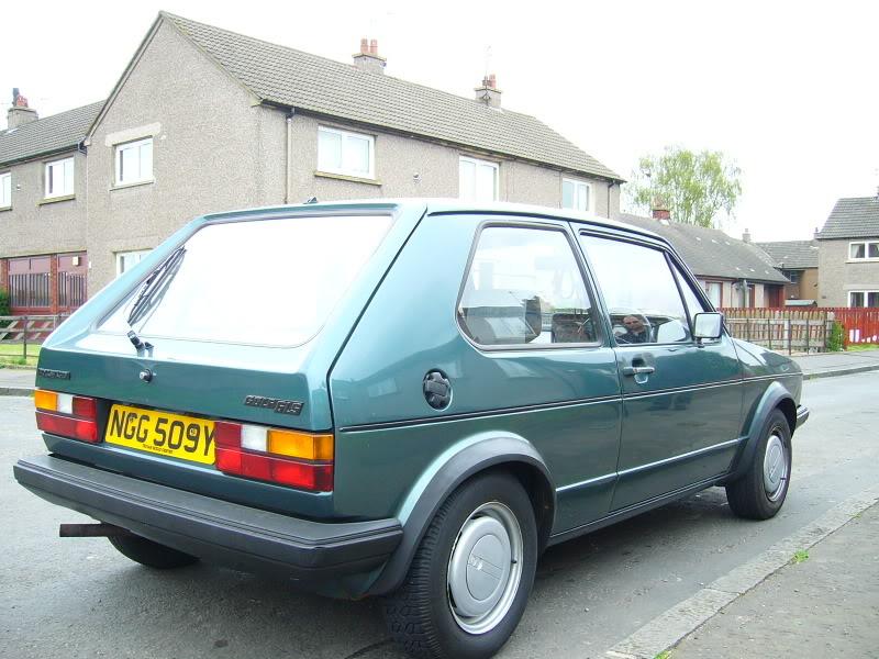

    not even a c as poverty a spec as you can get I came accross it whilst looking for a mk2 1.3 for my at the time teenage sister for a first car. This lhasa green mk1(strange in itself as the colour was never available for the model came already fitted with a 1.3 and a 5 speed conversion and with intergalactic 198,000 miles. Appearing solid I bartered the guy down as there was a couple issues with brakes and tyres and tags etc and we agreed a deal. Filling out the forms for transfer and checking the paperwork out the car had remarkably only done up to 48,000miles when the guy fitted the 1.3 and wishing a rev counter swapped out the dials for the rev equipped non-mfa 1.3 dials...immediately adding 150,000 miles but got me a good mk1 for my sister
    but she decided she didnt like it
    so I kept it

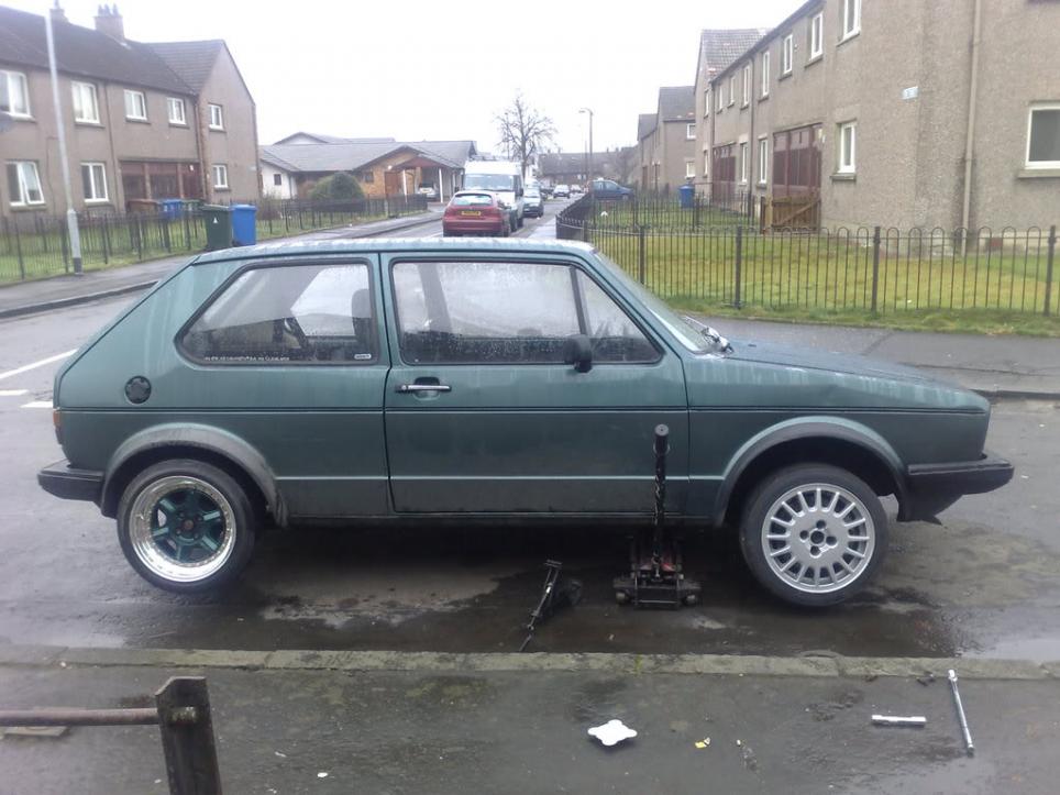

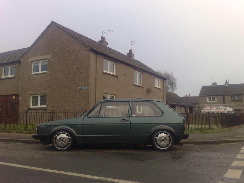

    stole the suspension and wheels of my jetta coupe(started an unfortunate trend here )minus 50 springs and renault turbine wheels fitted with 165/50x15s
    wasnt low enough though so using some of the funds from selling my passat estate I bought some fk highsport silverlines(also fitted some tinted indicators,gave the front plate a kick and gave it a clean

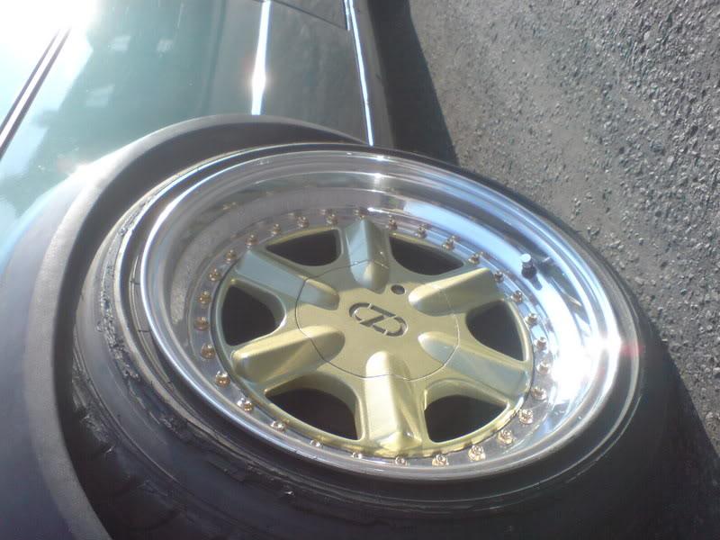

    bought some OZ executives,2 piece split rims after an exhaustive search,loved these wheels forever.They came in 7 and 8x15" sizes in a bmw e30 fitment(also painted vw racing green)

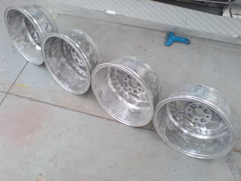

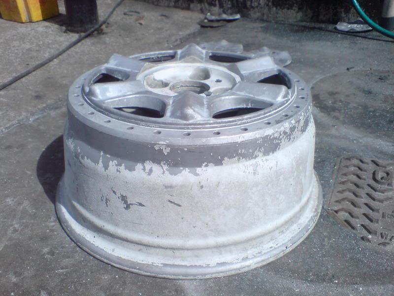

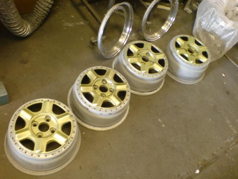

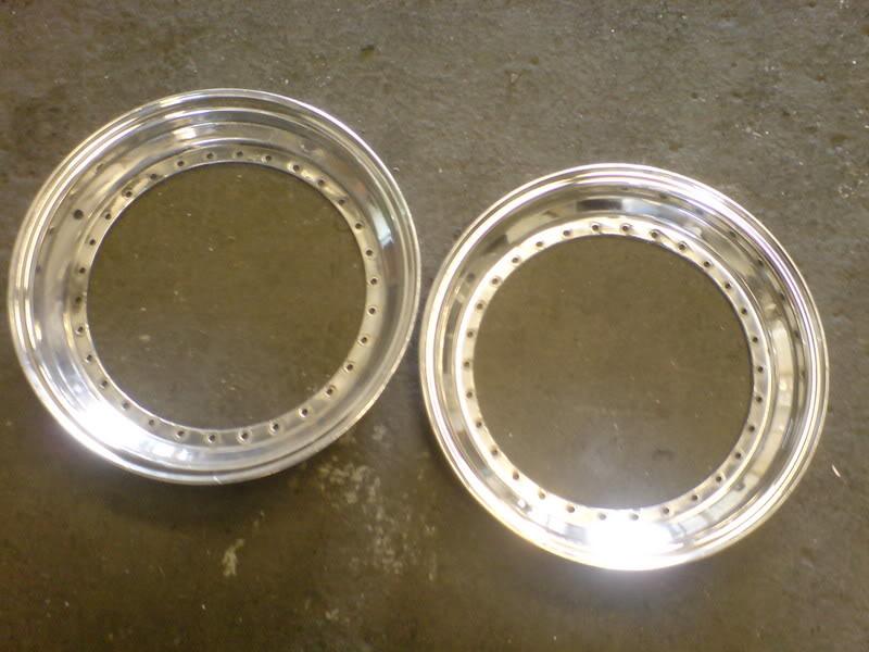

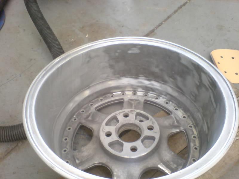

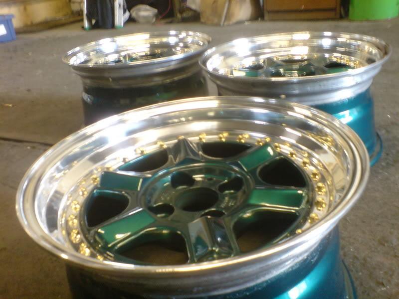

            OZ's got fully stripped
            these appear soon
            but in powder
            with some
            but most of that later,can only post so many at a time lol
              the wheels ...

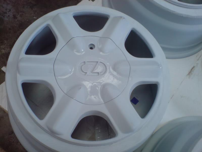

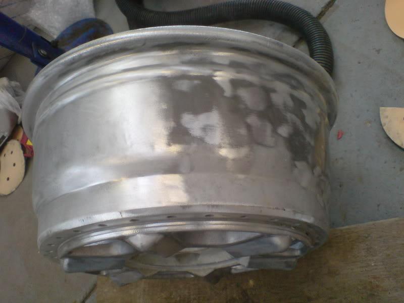

              sanded to 1200 then filler primer,flated then primered and wet flatted

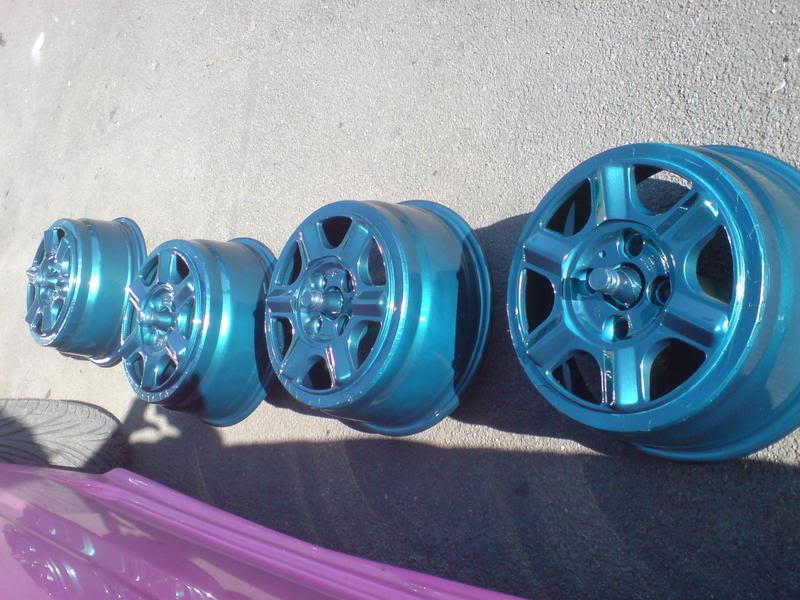

              and colour
              made them up to 8" all round

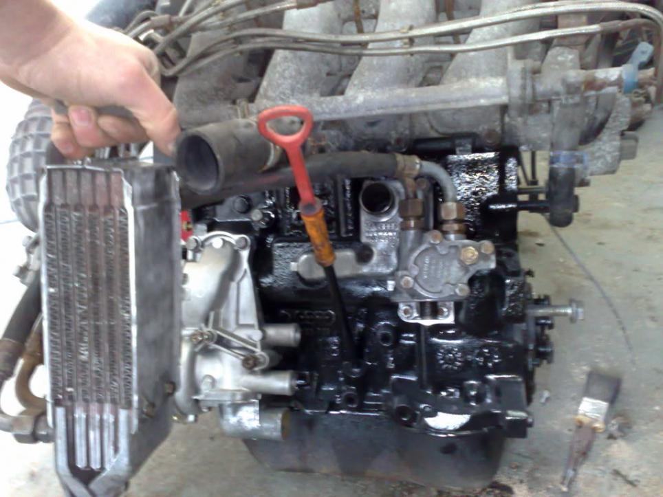

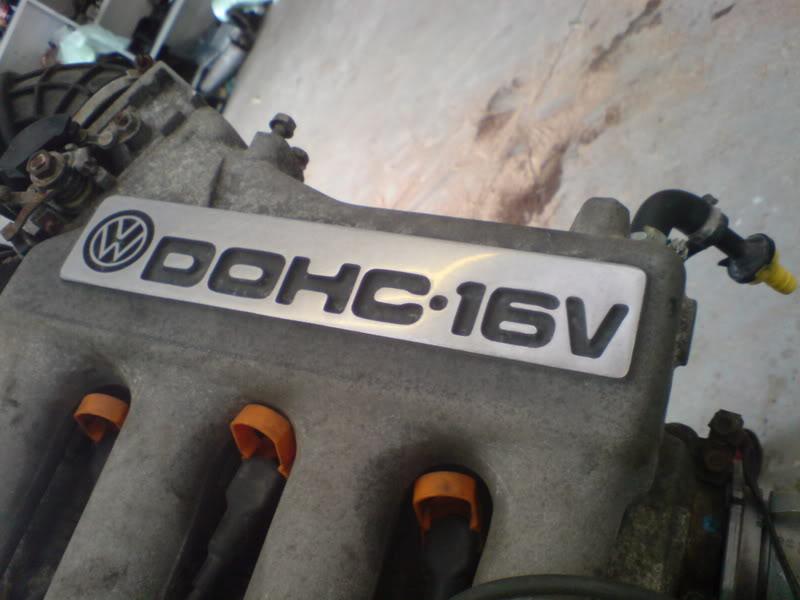

                blew up the 1.3 carb box and found a 1.3 digifant with 5 speed from a polo gt,fitted it plus...

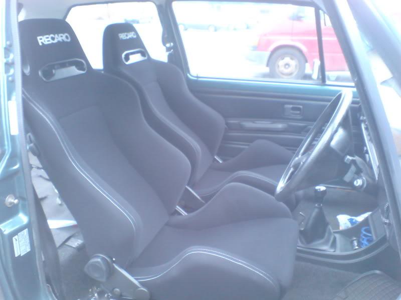

                still have the full oe interior
                and got the wheels on

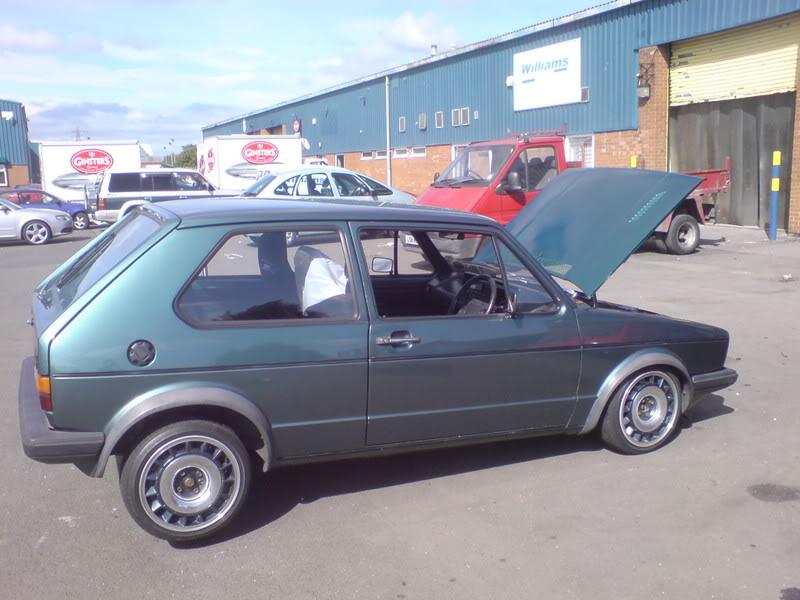

                got it to a show without it grenading

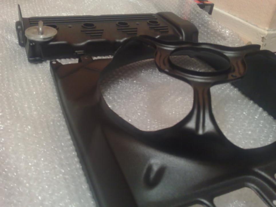

                fan cowling now changed for black

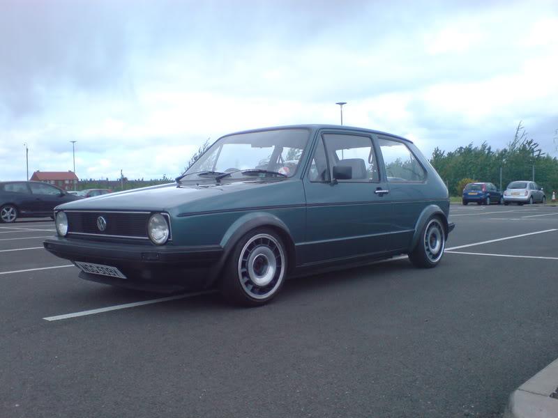

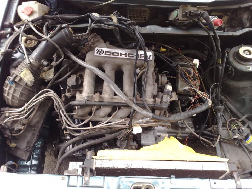

                decided the 240's were not up to the KR(its lightened and balanced,runs cams and a ported head and inlet,four branch stainless and 2.5" system)so stole the jetta's 285's(and technically the engine was for my jetta as well )
                  black bits

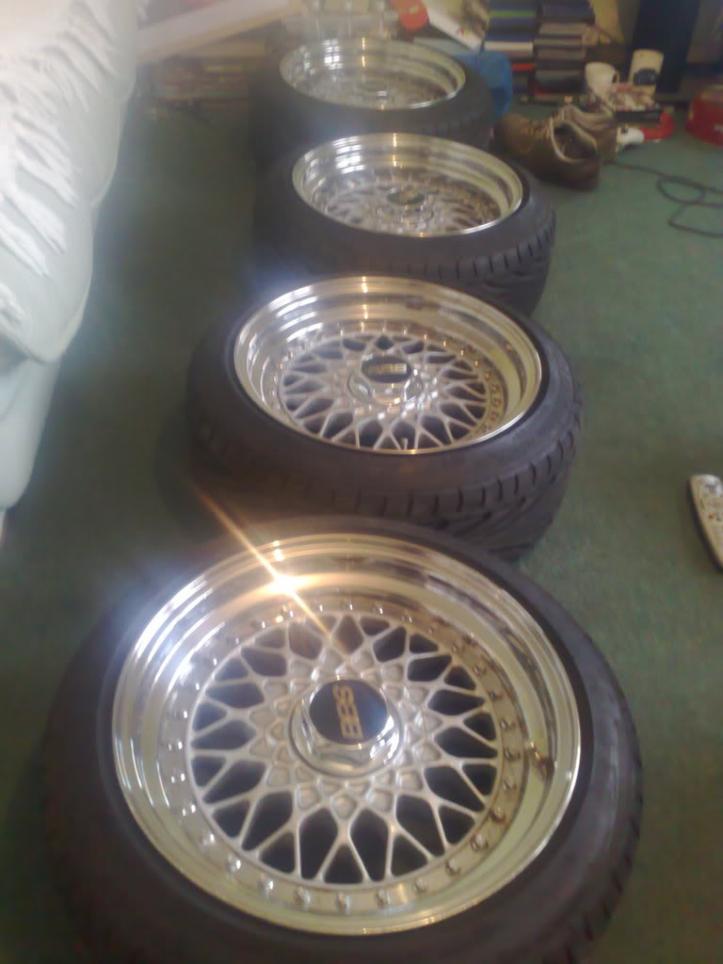

                  swapped my old porsche splits from my passat for these rs 071's
                  but they were a bit of a state although they came with 2 and 2.5" stainless dishes

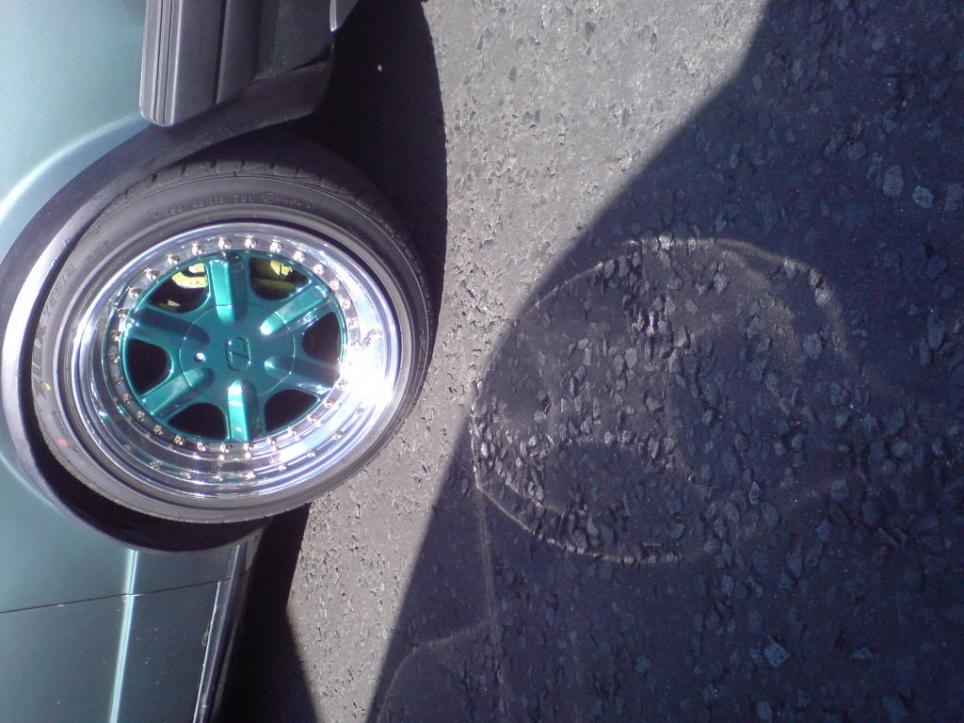

                  cleaned them
                  and fitted them
                  then sorted these out

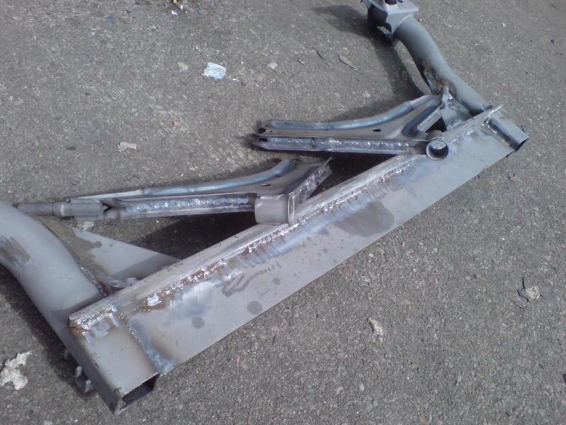

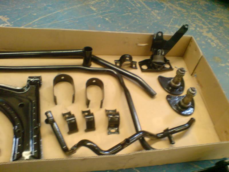

                        fitted the(jetta's)seam welded wishbones,poly bushes and powdered strut brace
                        and more recently have had it off the road while I tool about in my mark 2 as I collect a store of bits. Found oem lhasa green front wings,a set of oem plastic arches as one of mine had parted company although im looking into berg arches or at least a clipper kit,currently having the(jettta's)seam welded and powdered)rear beam fitted with polo stub pins and rear drums,a bigger master cylinder and new in-tank lift pump and external main fuel pump and possibly the(jetta's)powdercoated eibach ARB's ive had lying about along with (the jetta's)fk konigsports with a view to getting it track ready for next years track day sessions and ive been promising myself a nurburgring trip for ever and 180na horses should be quite fun round a track.
