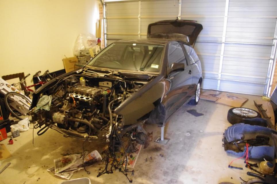

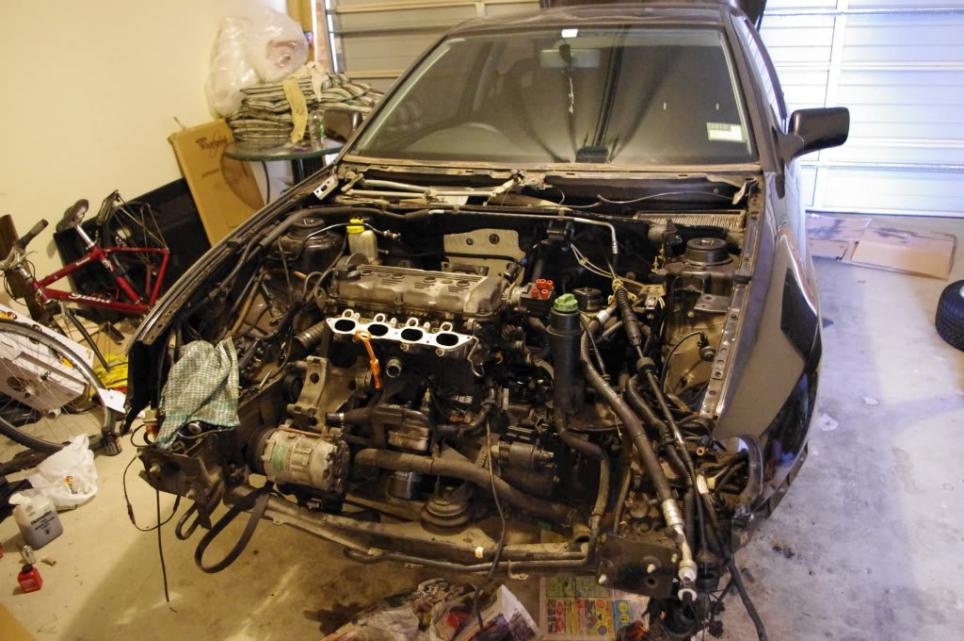

Bit more progress not alot though!! removing and labelling harness was a bitch!! almost ready for removal.

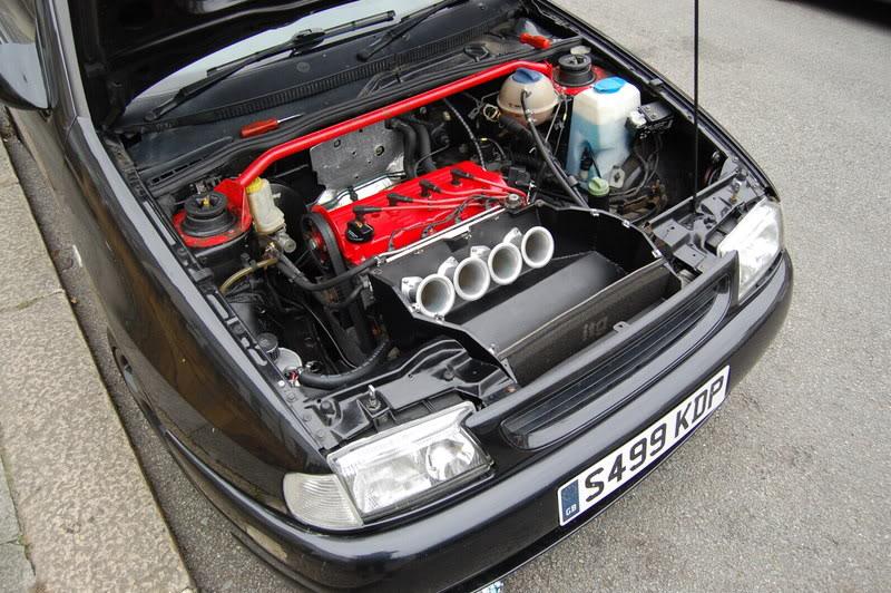

By the way, dBilas Dynamic make a direct bolt on ITB/chip/airbox/ISV/TPS kit for the ABF engine, allowing standard management etc all for around $2,700AUD shipped, plus import duty. I have one in the post, so will be able to report on what it's like pretty soon
Originally posted by Valver. View PostBy the way, dBilas Dynamic make a direct bolt on ITB/chip/airbox/ISV/TPS kit for the ABF engine, allowing standard management etc all for around $2,700AUD shipped, plus import duty. I have one in the post, so will be able to report on what it's like pretty soon
Does that have the throttles feeding from a plenum which routes to the MAF and IAT? I've been theorizing about how people run ITBs and standard engine management, and that seems like the only feasible way, except for maybe 4 modified individual MAFs and harnesses.

that does make things a lot easier.. pics would be awesome.
basically converting to alpha-N using the stock ECU with modified fuel and timing maps, correct?
