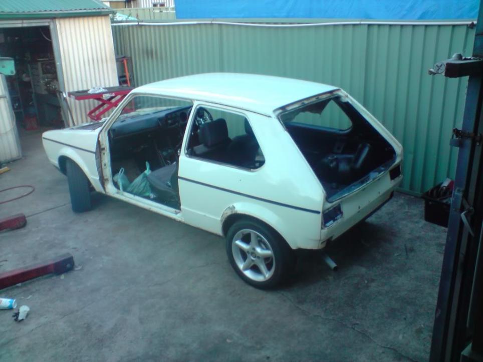

Heres the first update of my little project, yesterday i transported the golf to its new temporary home in Prariewood where its going to be for a couple of months or so! A lot was accomplished that day, as was a lot was learned!

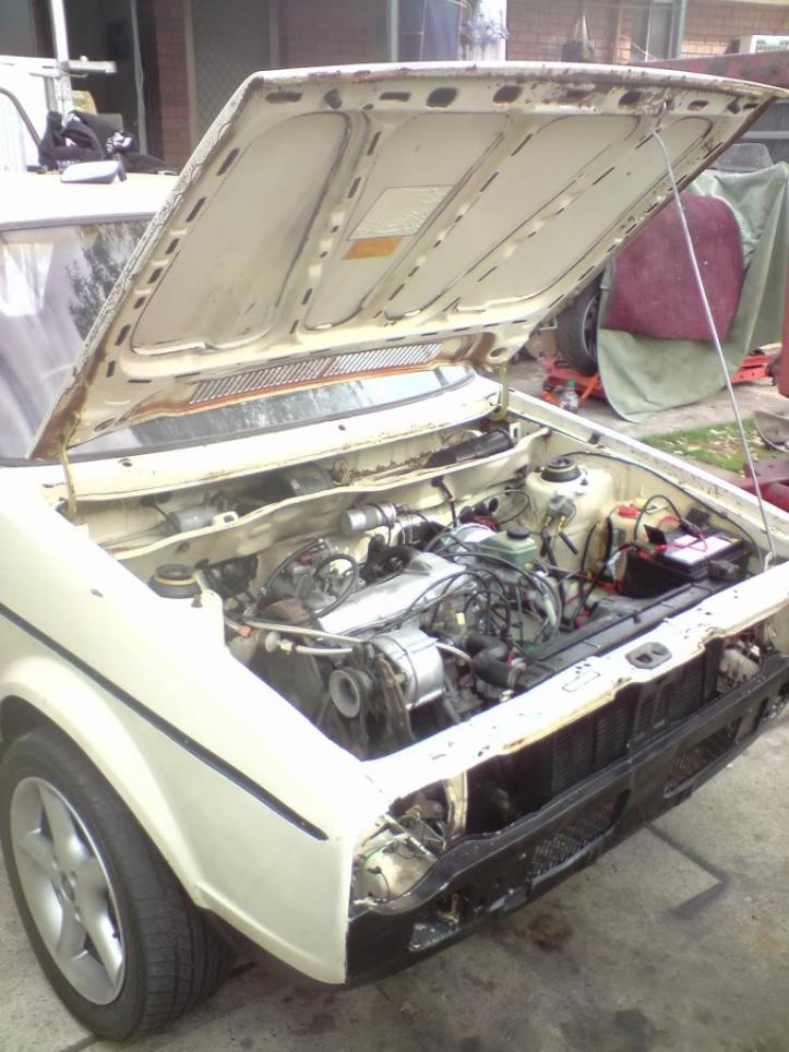

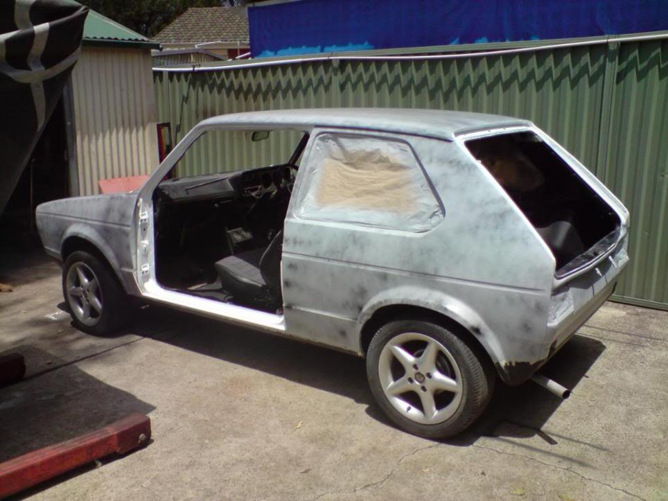

My mate and i started stripping the car first thing in the morning, as today the internals of the doors and bonnet are being sanded and primered!

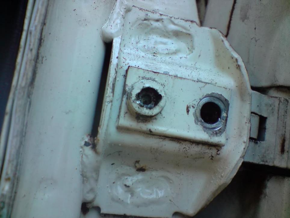

Doors, Bonnet and Hatch came off with ease as did lights, wipers, and the little things! However on the drivers door one of the bolts was rounded so that made life a little more difficult
I had to also take out all the glass and seals off the car and basicly everything that was needed of for the respray!

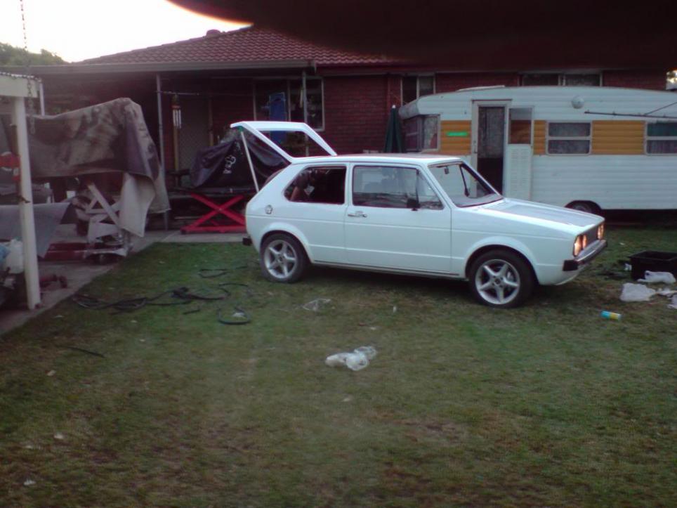

Since basicly everything was off by 12:30 we thought it would be fun to lower it! So we did the typical cheap way, and just cut them! however i thought i'd use the spare springs... and as u can tell the was a huge difference

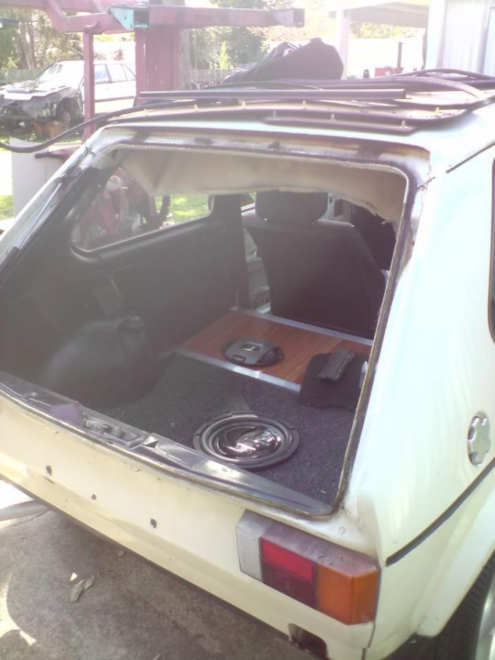

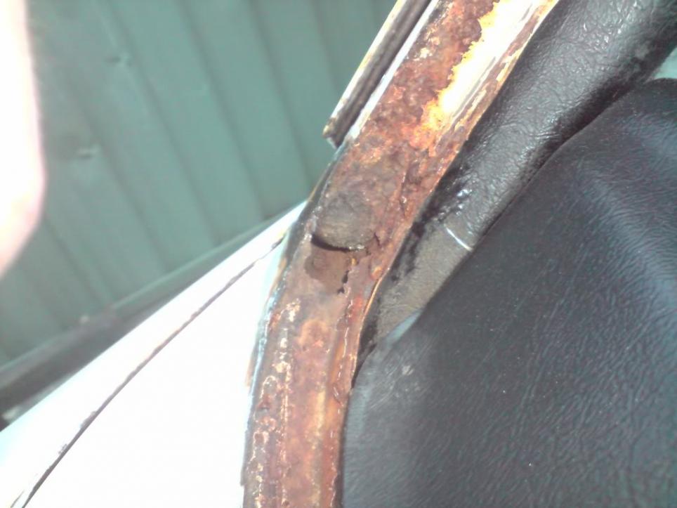

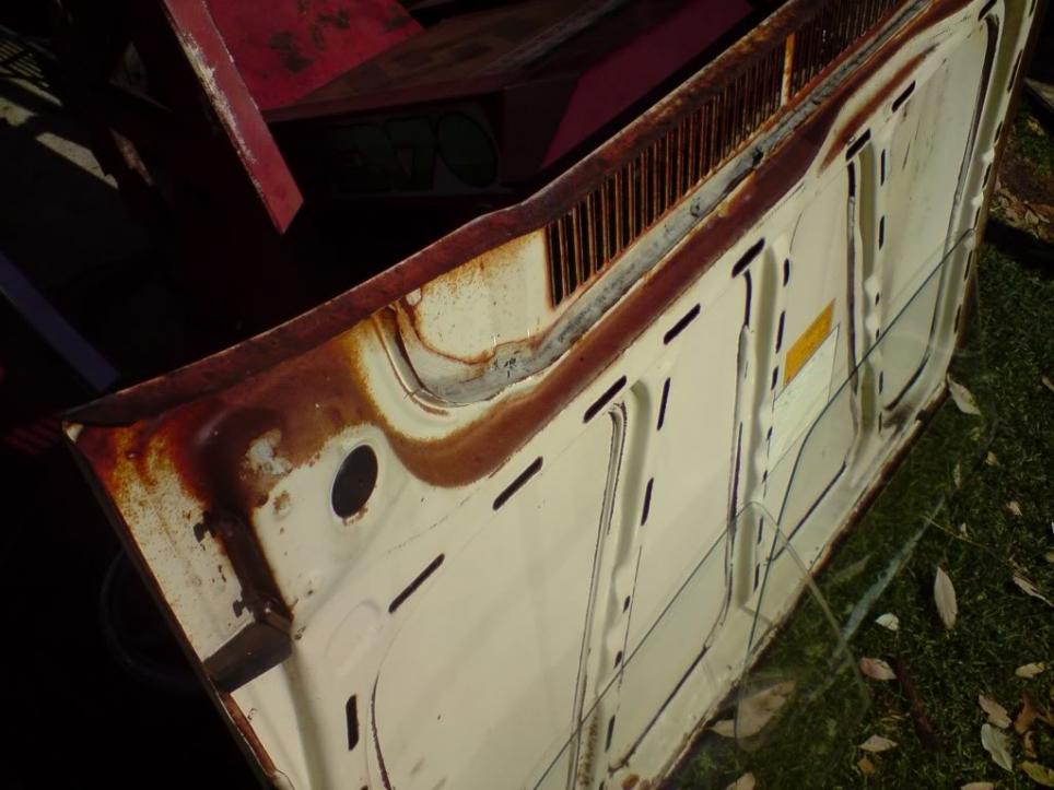

However, during the process of removing the windscreen i learned that rust was a little worse than i thought!
Anyone had this problem, if so what would be your best advice on how to fix this?
Cheers, Daniel.
Very common rust spot for Mk1s mate.
Best if you can weld it, if not the kurust treatment that makes it go black and strong and then some bog and sealant.
Thats not bad, I have seen ones much worse.sigpic Camden GTI Performance. VW / AUDI Specialists

Hit that whole window section with some wirebrush, as I'm sure some more pin holes willl appear. It's best to have it welded up properly, although rust convertor and a metal/fibreglass filler would be my next preference. (as opposed to just bog, as it has practically no structural qualities.)
Thanks for all the advice and great comments!
im sure i can get it welded up, however, i do still have fome rust converter and that fibreglass kit that i used for the hole in the floor..

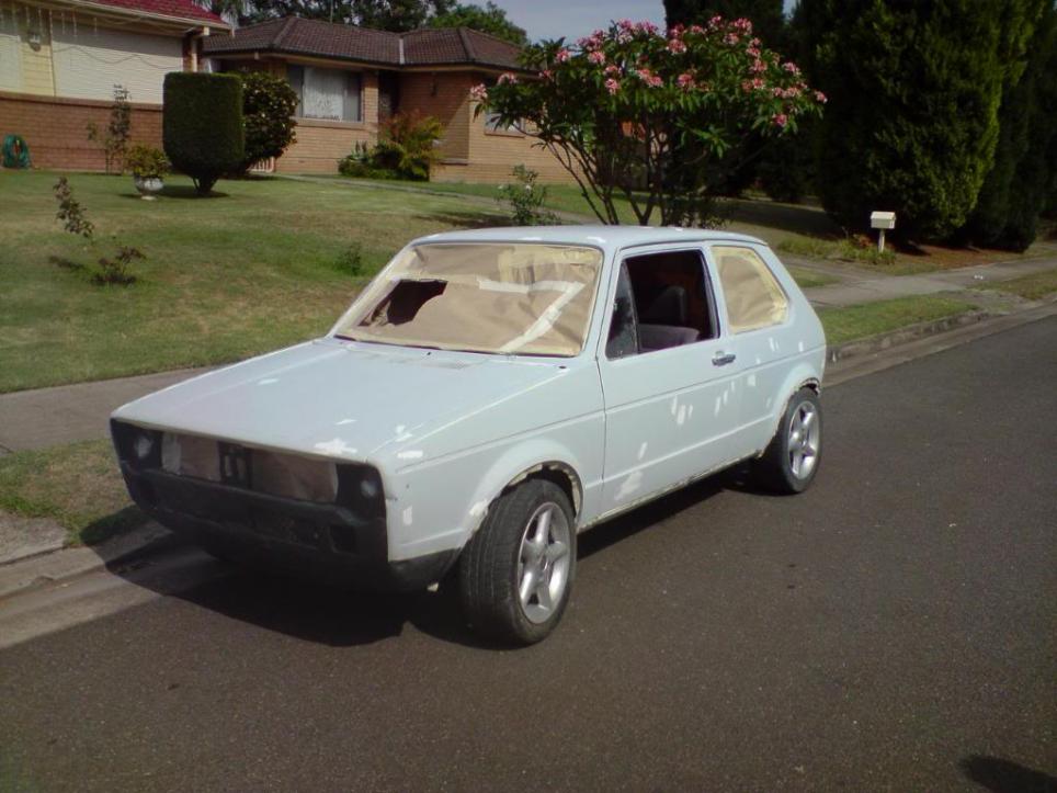

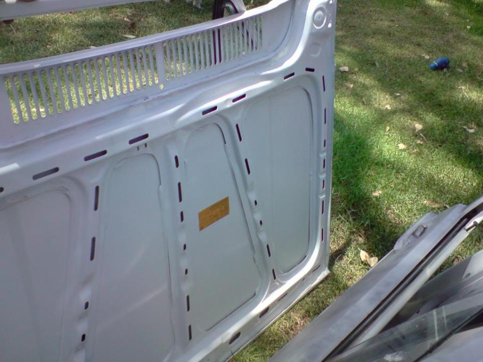

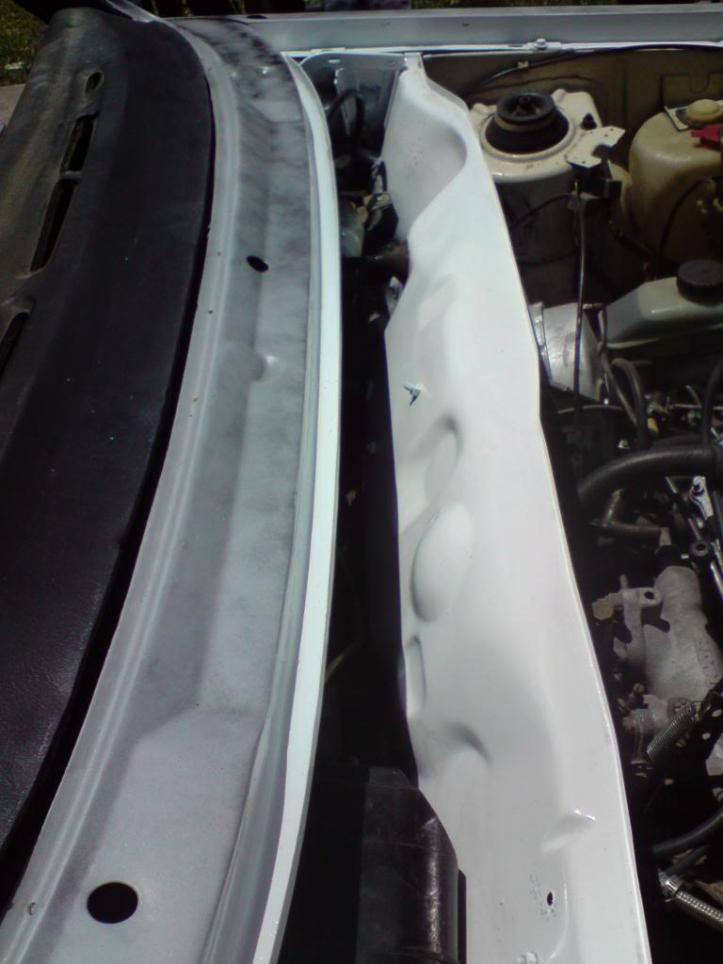

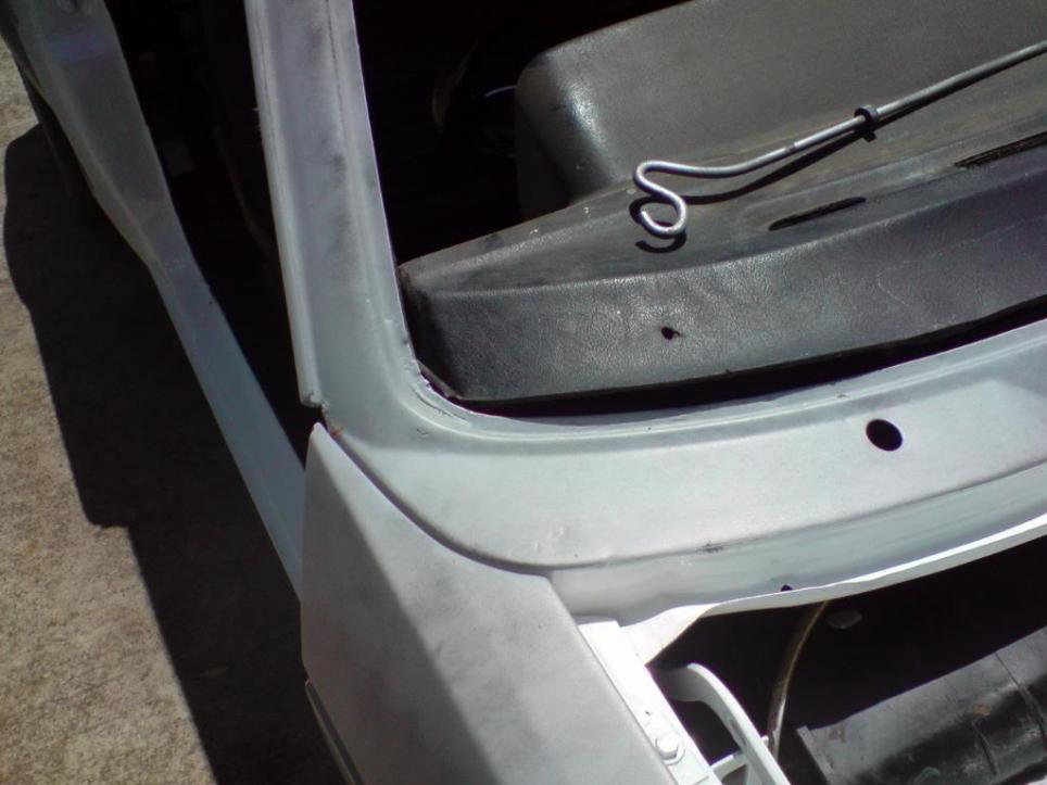

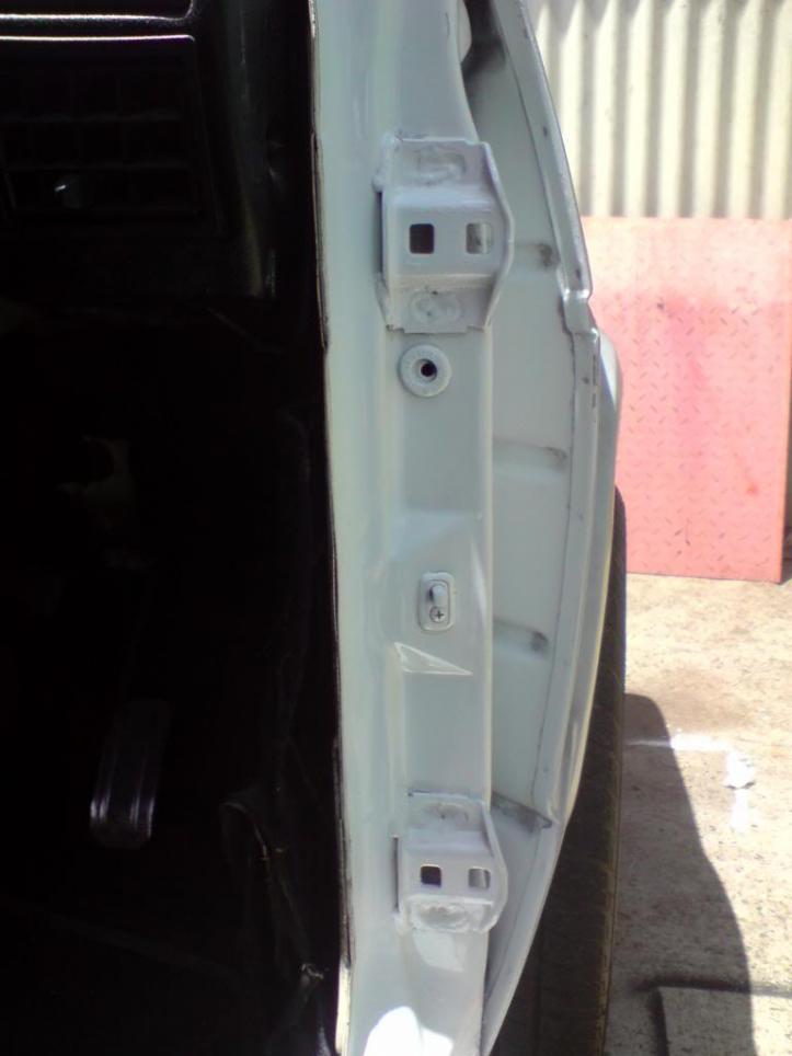

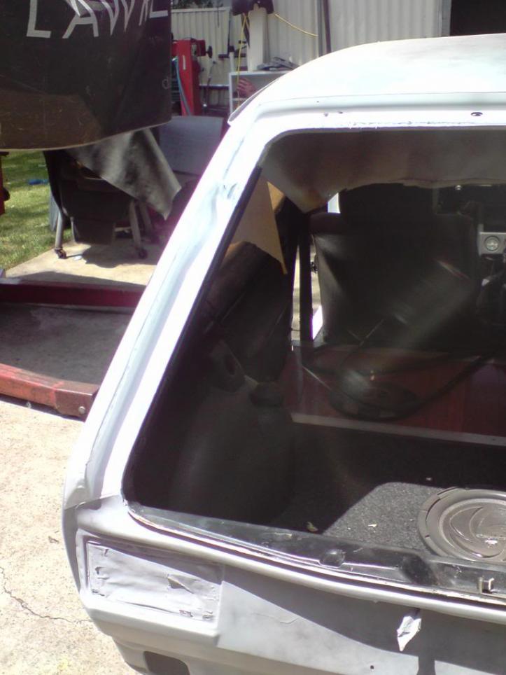

Here it is after 10 weeks and the resprayer had sanded the old weathered paint back and primered it up nicely as well as paint the door jambs.
Very nice aquarium now compared to before!

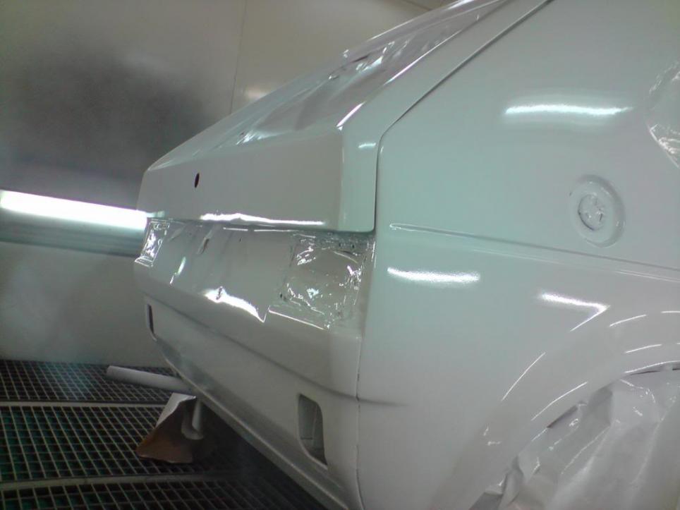

Good ridance to the rust around the windscreen! hope to never see it again!
I love this photo, just thinking back to the visual condition this bonnet was in before makes me feel ill, its too bad its going to get dirty as soon as i do a few hundred or so kilometres..

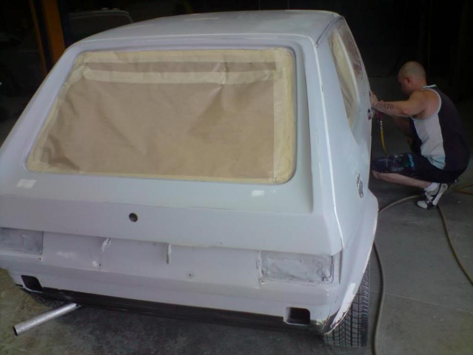

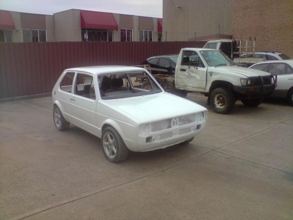

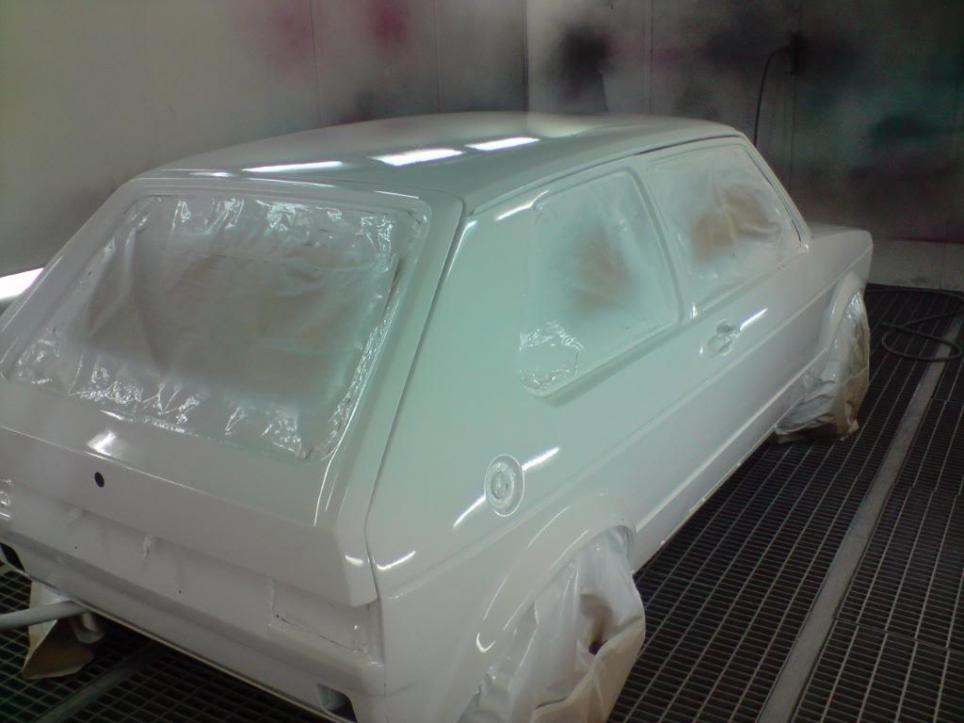

Here it is on the big day, all properly masked (though the interior still ended up in heaps of overspray)
Resprayer sanding back plaster just before we wiped it down with thinners whilsts inside the booth.
The car recieved another coat of primer before the paint went on, and after that it recieved 4 coats of paint, no paint as spared! so at least now should anything stain my paint theres no problems cutting back!
After it was heated for an hour and a half in the oven we drove it out looking like a different car.

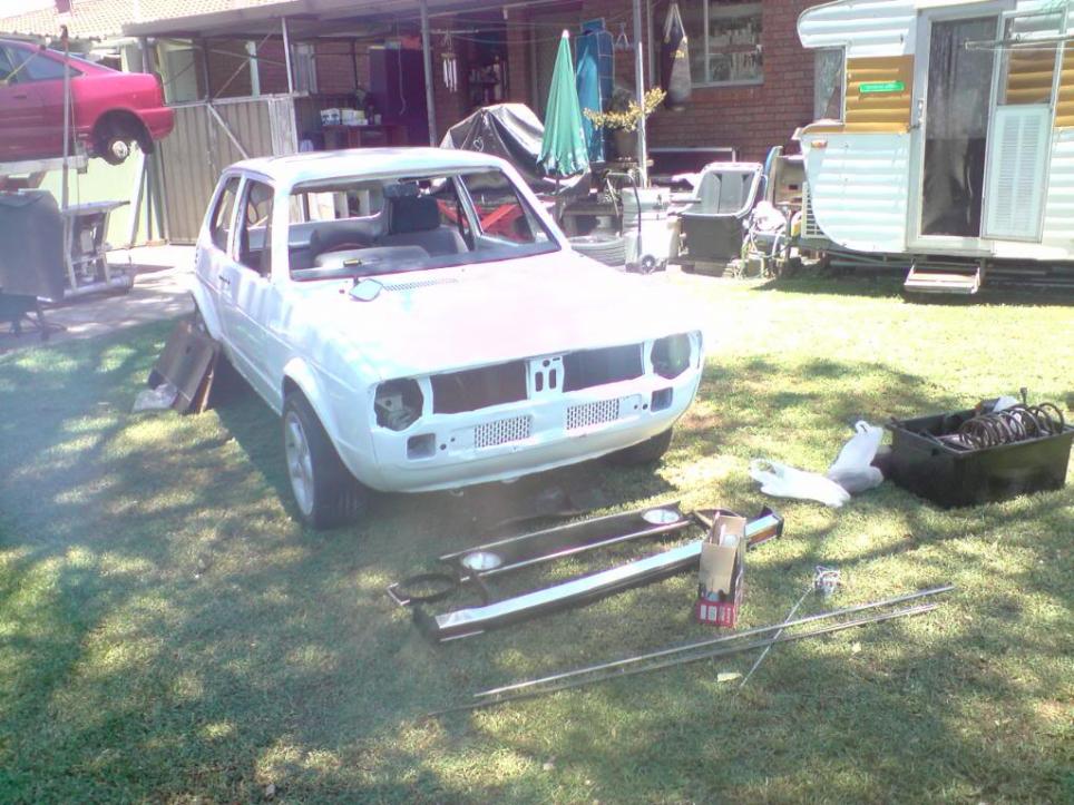

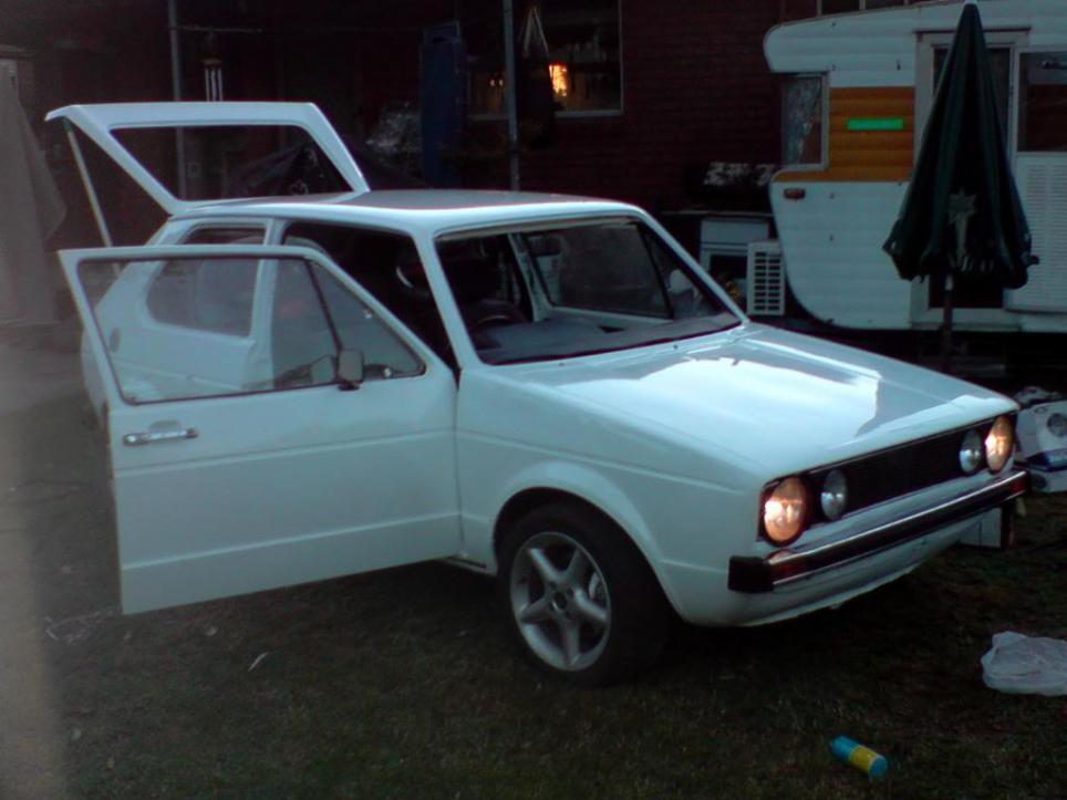

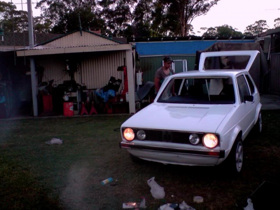

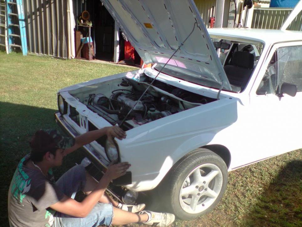

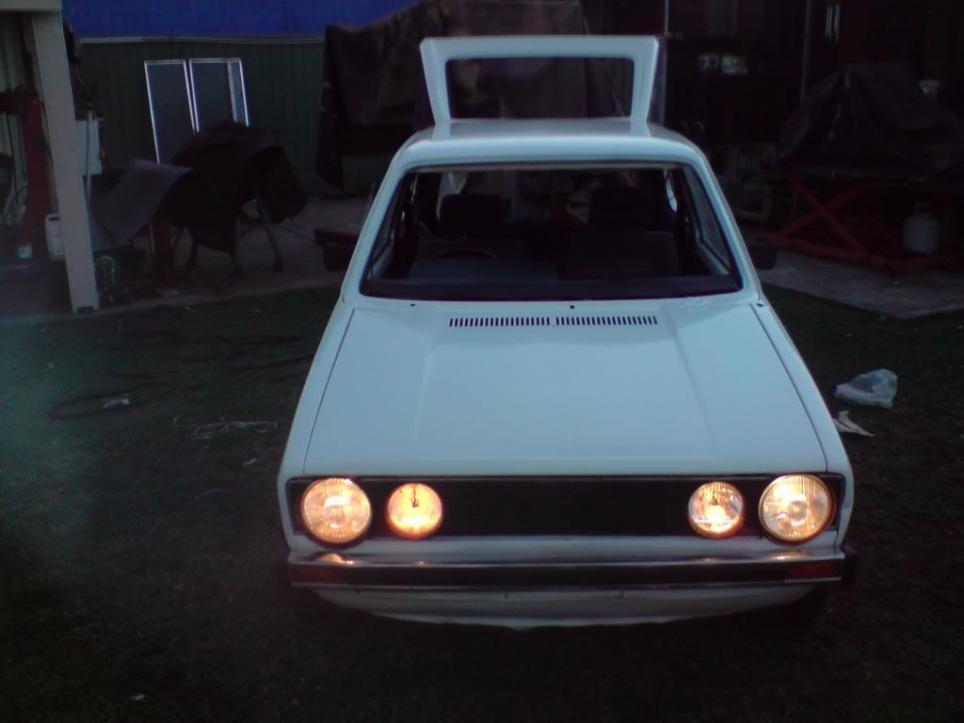

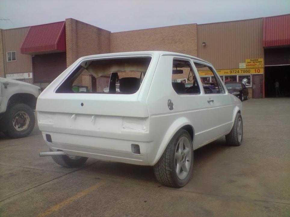

And then finally came assembly day my mate and i started at 3pm unfortunatly so we couldnt get all on however the majority is on excluding windows, chrome strips, gti decal stripes!, and various other little components.
ONCE again used the crappy camera on my phone, better photos will come soon!
No more cable ties holding on the grill! lol

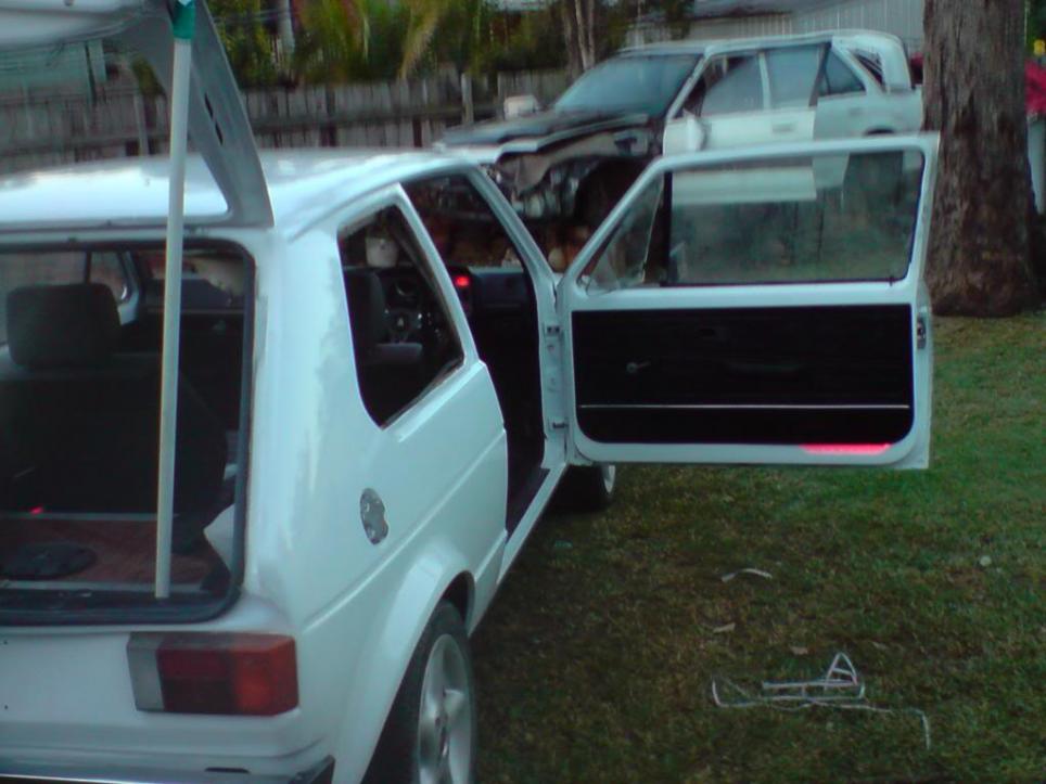

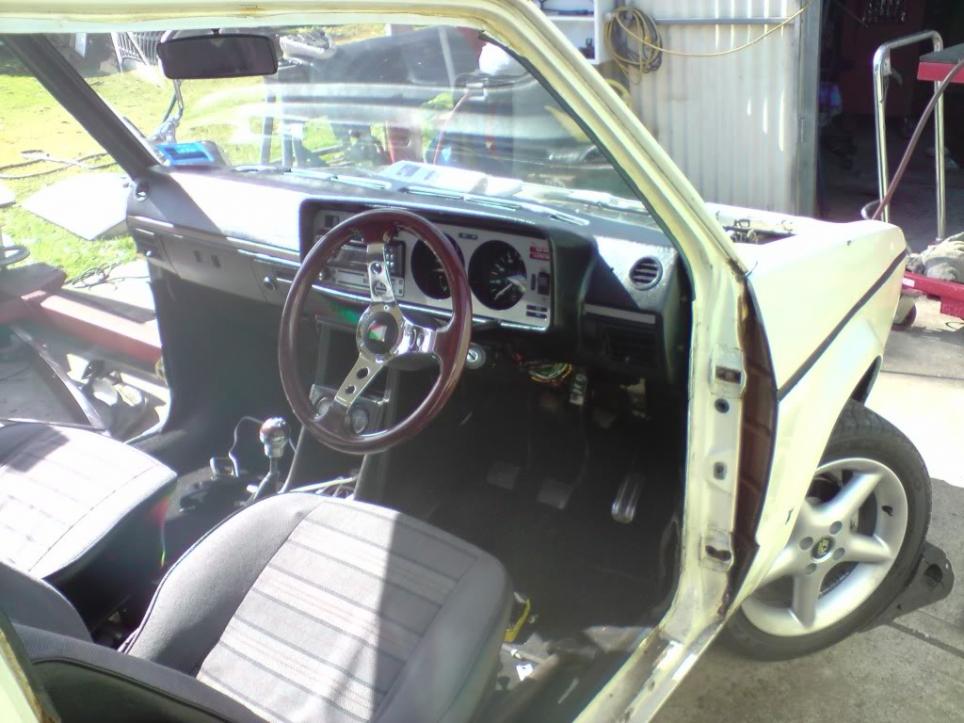

Doors all fixed up with my new customizable LED lights

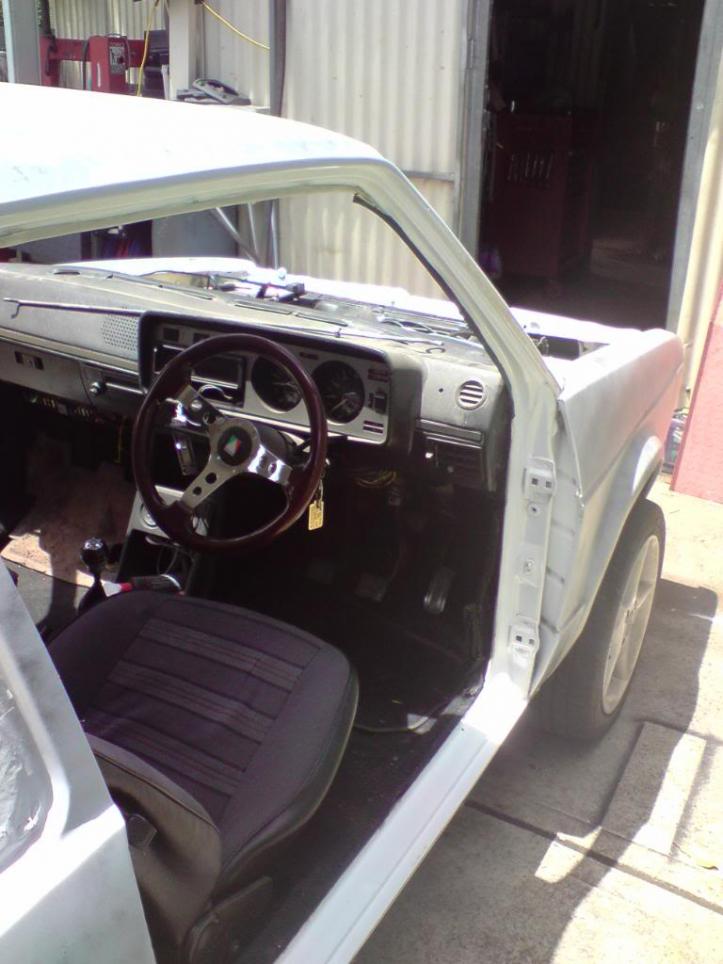

Finally looking like a car again
One of my favourite photos!
Lights were tricky to wire up, because it was pretty dodgy, going to have to tidy up the wiring one of these days

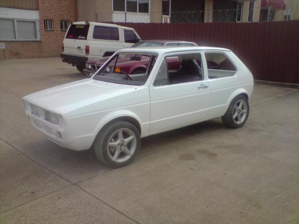

And there you have it! its almost there! i will update soon with the windows in, and also going to change back to the original carbie, getting sick of the sidedraft delortos.
Also needed to do in put in a reconditioned servo and new master cylinder, lower it (again lol), tune it up, service it, tint windows, exhausts and then REGO! really not all that much and cant wait till its finished!
