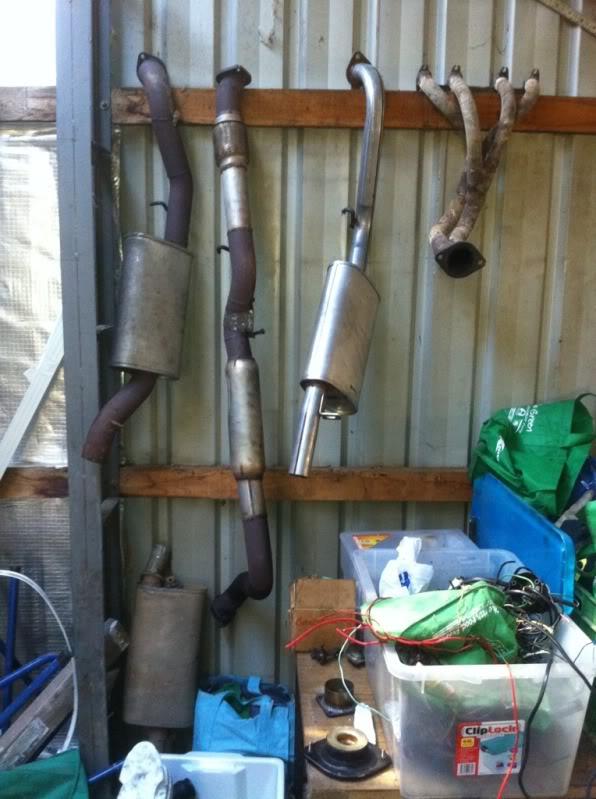

Last week the exhaust pipe broke just in front of the rear muffler. I liked the sound and the performance gain but Leah didnt. I decided to compromise and had a 2" pipe installed with a new 2" flexible join at the front. The car is pleasant again and really likes to rev! Big improvementBeige 79 Mk1 GLD White 76 Mk1 LS 3 door

yes indeed, i found that my old 1.5 went much better after a bigger exhaust was put on - really opened up the upper rev range. best i got it was with a genuine GTi exhaust (front half, with 2 pipes to the shifter box) and 2" from there back. was a bit noisy though

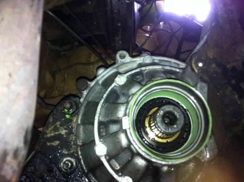

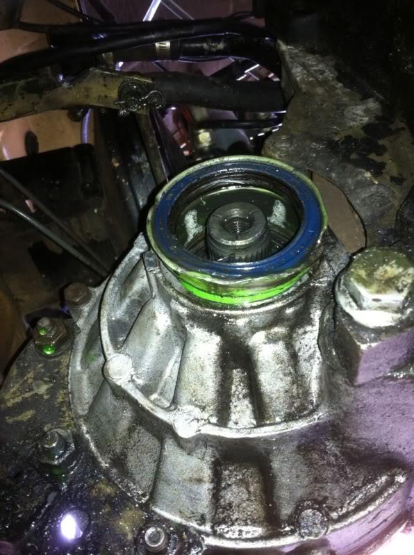

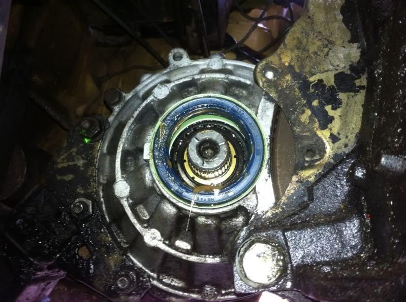

Huge gearbox oil leak.... Mangled seal carrier
New seal carrier installed
New seal installed

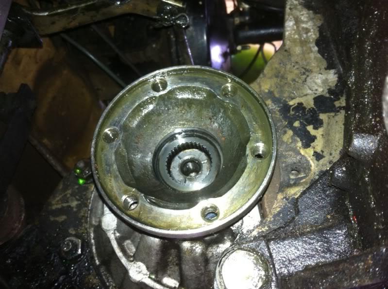

Flange going back on
