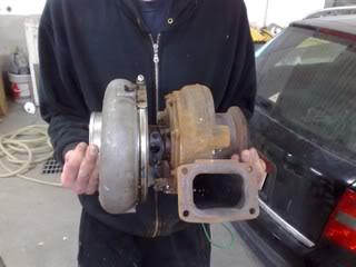

    -Twin turbo setup: I'm going to stick with the current one (gt23v-AMG) and add another vnt, gt37v to it. Luckily I have a big trunk... Things will be electronically controlled. This is the hardest part. I hope I get it right. For you that haven't ever seen a gt37v, this one is HUGE. Even HX50 is small compared to it.

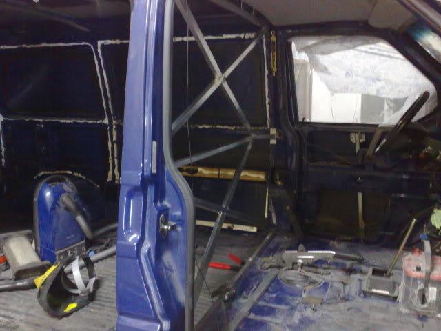

    -Weight shaving up to 200kg, but that big turbo isn't going to make it easy (as it weights about 40kg).

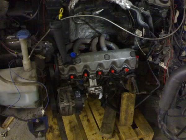

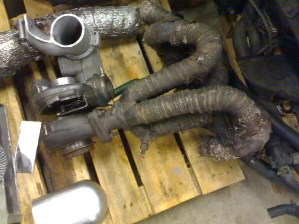

    Van:
    Old engine compartment with 350hp, 700Nm:
    In action:

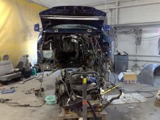

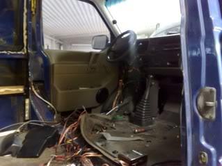

    Tearing it apart.

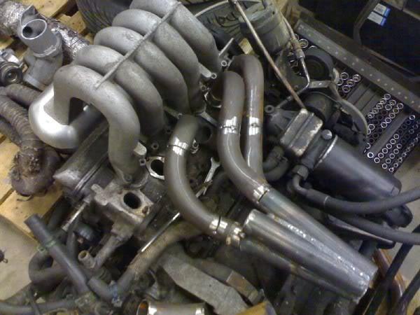

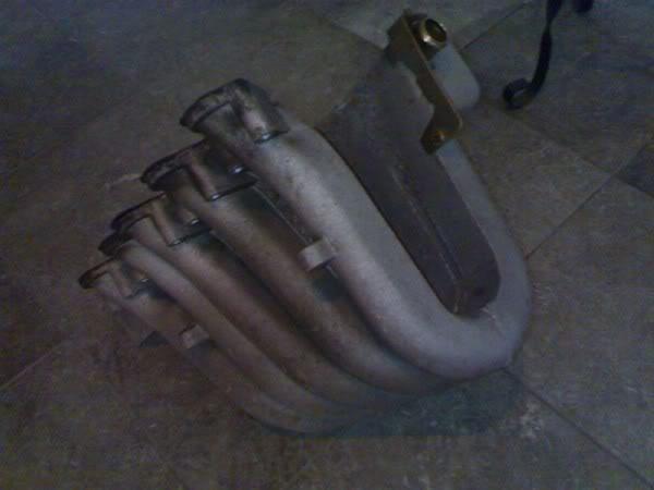

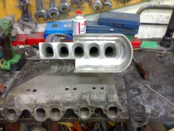

    Intake will be looking something like this (left one). Long runners are going to be taken from D24 Volvo (6syl).

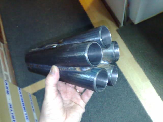

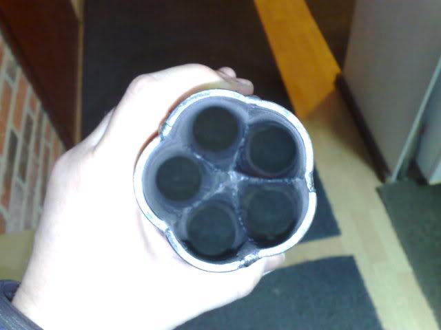

    Here's some pics of the home made collector.
    Small end.

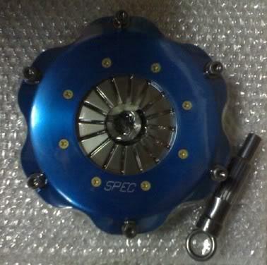

    Here's my new dual disc clutch. I'm a little afraid how it is going to behave...

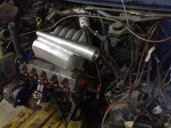

    Here's a donor for my dual plenum intake. Runners are 50cm long.

    Now things are cooking. Exhaust is ready and intake is nearly ready.

      Manifolds were test fitted today for clearances. Both seemed ok.

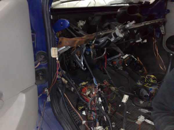

      Some ongoing electrical work.

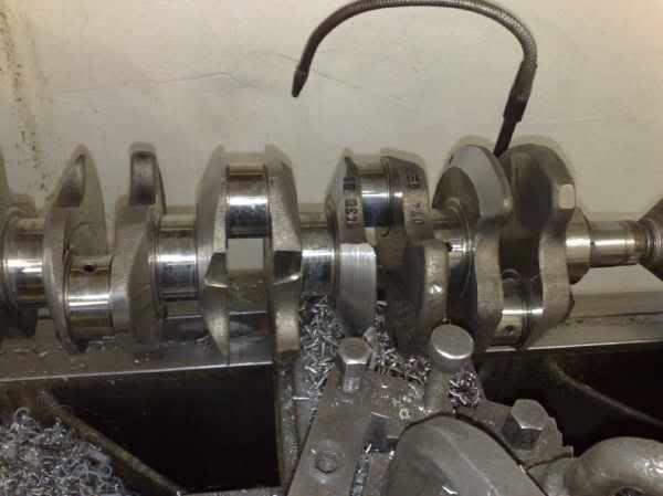

      Next one I don't recommend to anyone as lightening crankshaft is plain madness...
      Original:
      Under construction:
      PLEASE DON'T DO THIS AT HOME!

              i'm impressed with your intake plenum design - like the idea of the large plenum to feed the runners and the feed plenum for the larger one to try to distribute the inlet air into the main plenum chamber evenly - and i guess a good idea for the street - given the amount of pressure you'll be putting on the internals, you want it all to be balanced nicely across the cylinders for engine longevity.... nice work.
              that GT37 is HUGE. pointless remark i know, but mate, thats just plain BIG. i guess this kind of build could only really happen with a van, 'cos i reckon a turbo that big in a golf would just have to go somewhere inside the cabin - get lost passengers!

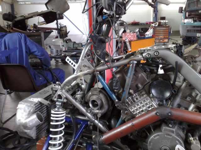

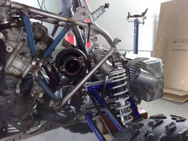

                          We already know that vnts work with gas engines as my friend has been using gt17v with his previous ATV engines with succes. Here's my friends latest ATV with Aprilia V-2 1000cc and gt22v. Goal 240bhp.
                          Dual plenum intake is under construction. You can see it above IC, on the table.
                          And the other side.

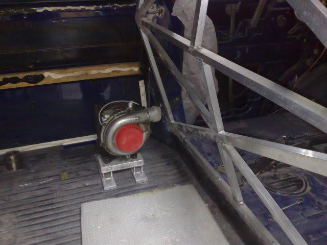

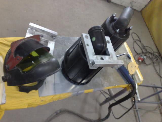

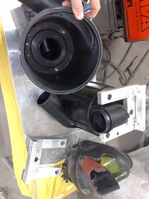

                              Here's my new dual airbox setup from Fiat Ducato under construction. Two 3" airducts will feed those from a roof scoop and boxes will be fitted into the trunk divider wall. This way I can use big paper filters instead of free-flow crap and have enough flow for far more than needed.
                              It's not going to look this spacy after I'm done. I'm going to need my trunk with second turbo, all the plumbing, heat shields, wastegates, WAIC, scavenge pumps...
