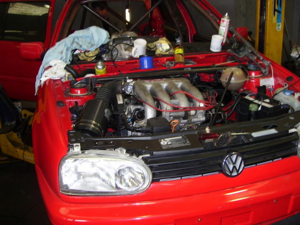

    Was visiting Muller Muller today and found this Mk3 with cage, very serious brakes and an ABF engine.
    This nutter Morris is in charge of it.
    Plans are for some rallying, maybe the Dutton and Targa.
    It looked pretty serious and progressing quickly.
    Watch out for it in a forest near you soon

                    Hey Golf Loon good to meet you at Mullers. I actually remembered that I joined this site last year. Thanks for posting the pics and I will forward more once the project is complete which I expect will be in 3 weeks time fingers crossed. This project is now into its 6 month!! so cant wait to start testing it. So far work done and bits to be installed..........
                    Car completely stripped.
                    2.0 16v ABF motor from Seat.
                    Schrik Cams.
                    Head polished and ported.
                    Motec M400 injection system.
                    Custom extractor with 4-2-1 exhaust system.
                    Standard close ratio box
                    Super Pro Poly bushes all round car.
                    VR6 c/arms, C/member, B/carriers
                    AP 330mm 13" brake system.
                    Bilstein PSS9 Suspension Kit
                    Weld in Roll Cage.
                    Hydraulic Handbrake.
                    OMP WRC seats.
                    Sparco 6 point harness.
                    4KGMech Fire Bomb (plumbed) + 2 x 1KG extinguishers
                    Battery cut off
                    Sparco R368 steering wheel
                    Sparco quick release hub
                    Terratrip 202
                    Cheers............Maurice
