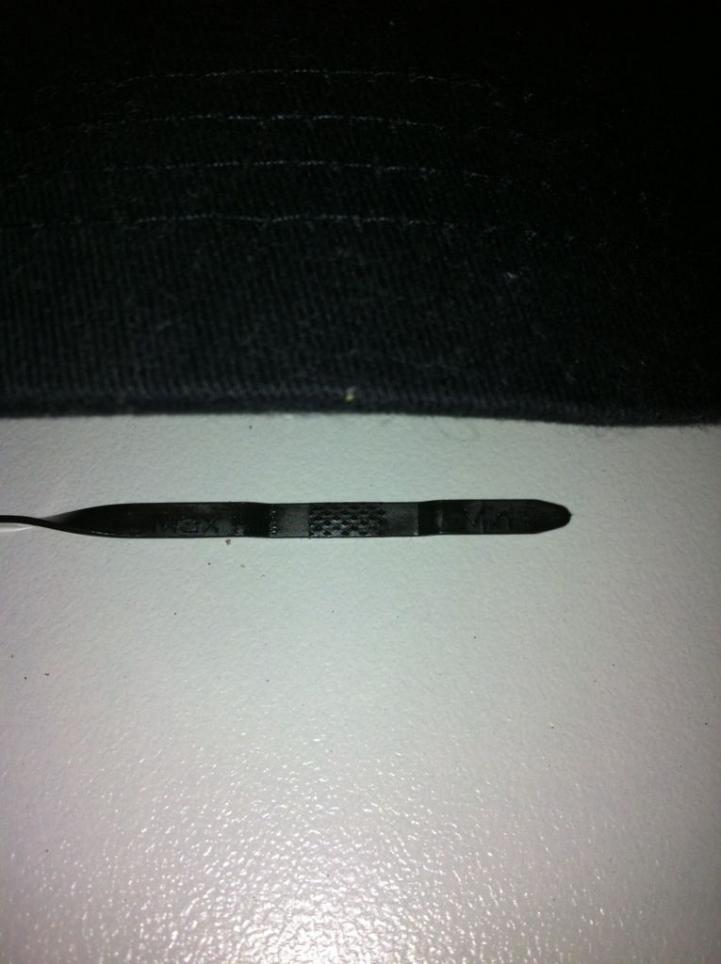

          Here are two pics detailing the levels. Basically, the oil level should be in the 'dipped' area. Top kink is max, lower kink is min. Hashed/chequer plate area is 'comfort zone'......
            Good advice but it doesnt say WHEN to do it to achieve posted instructions only HOW to do it.
