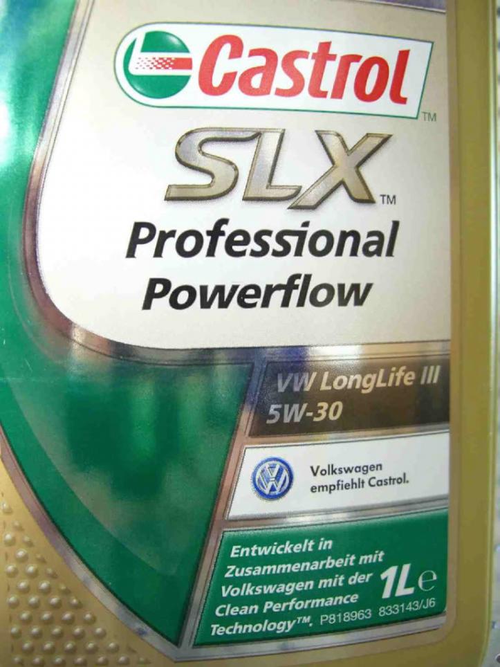

    The oil the dealers use is Castrol SLX Professional Powerflow. It retails for around $80 if you can still find it. My local VW dealer had it in their spare parts store and I bought it from there once but last time I was there they didnt have any so they recommended I use Castrol Sport Edge 5- 30w which I have been using ever since.
    I know they use this oil because it said so on the receipt when I got my car serviced. The dealer charge around $100 in their service for the oil.
    Or yu can go to a Nissan dealer and ask for oil for 2.5L TDi Navara Automatic with DPF and they should give you Shell Helix with VW507.00 Specs. Check the label on the back of the container before you buy it.
