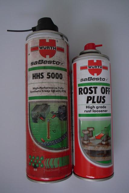

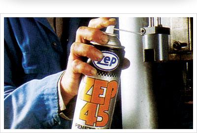

As for application, getting a good chemical resistant spray bottle and have at it.
Or buy one of these bad boys.
