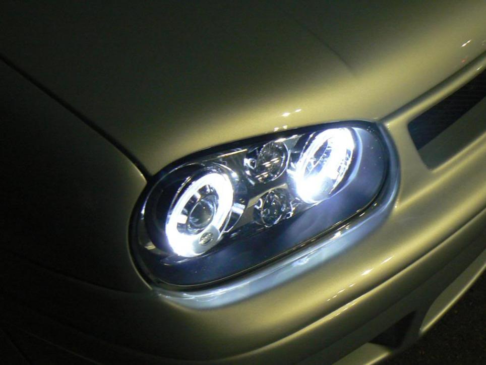

          ok,i get ya...maybe whitest then as atm there is a visible difference between the very white angel eyes and the globes which are yellowy white
