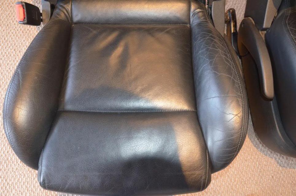

    How do I know if my leather needs work? Is your leather stiff/cardboard like, with crack forming and an overall shine?

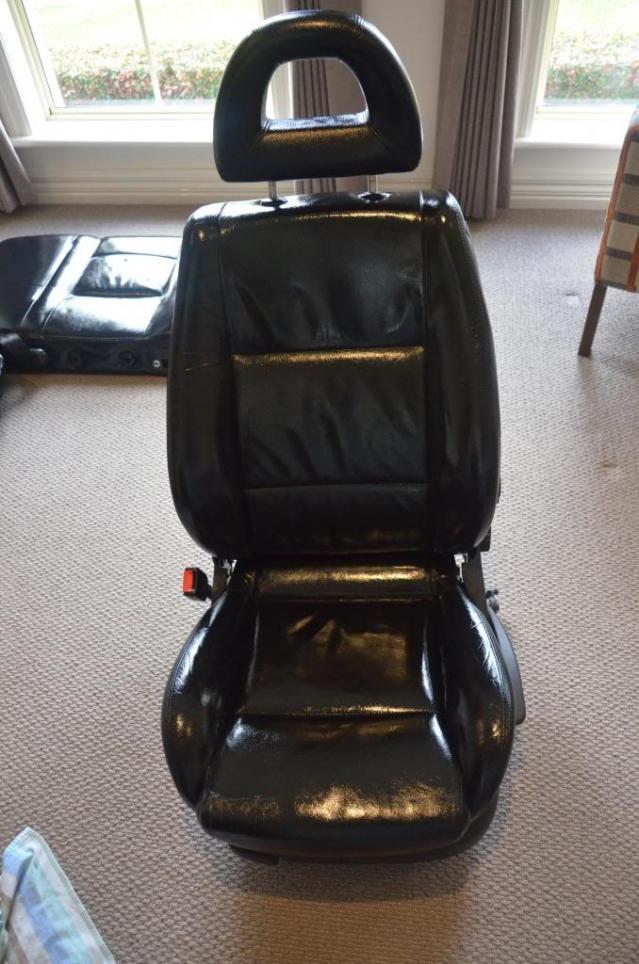

    For best results, use your hand to apply a generous amount of this oil into the seat, the more you work it, the deeper the oil penetrates (giggity). The higher the wear area, the more you should massage it in. If seats are in the car still, put all the windows up and park in the sun, for best results wait for 12 hours before cleaning off. I had the seats out and this worked best for me as I could do it in the comfort of my lounge room. For cardboard/stiff feeling leather, reapply the rejuvenator oil every 12 hours to the seats until they stop absorbing the oil. For my seats, I applied about 5 coats of the oil, each time I put less on as some sections still had not absorbed the previous layer of oil.
    Step 5: Removal of the oil
    Same process as step 3, but you'll be surprised at how much dirt now comes out after the pore's have re opened, if you have the $$$ buy some leatherique pristene clean, but duragloss leather shampoo is still an excellent product. Make sure this seat has no dirt coming out whatsoever at this stage. You should be left with a soft, supple leather.

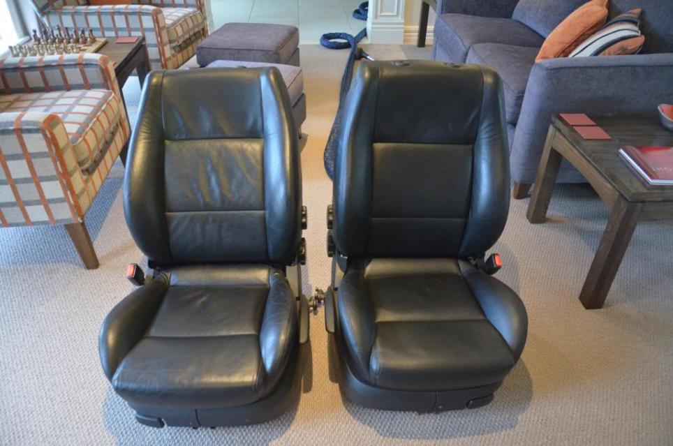

    A before and after shot
