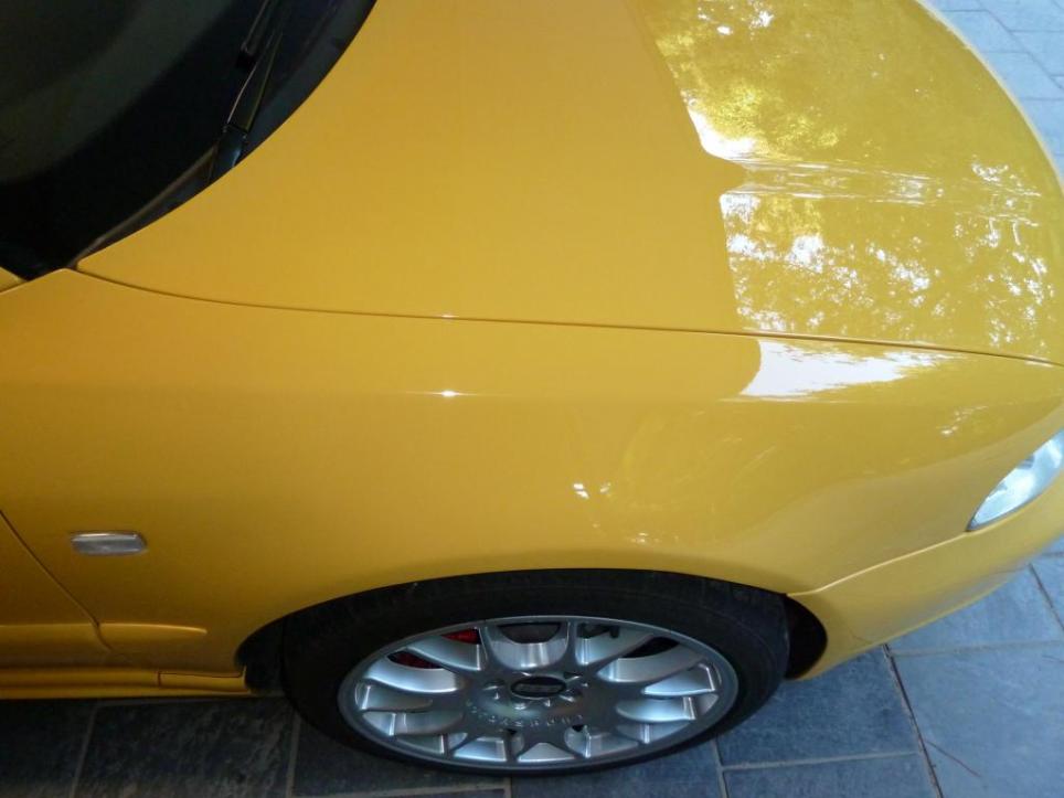

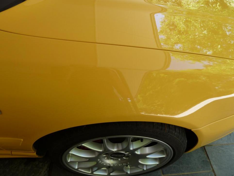

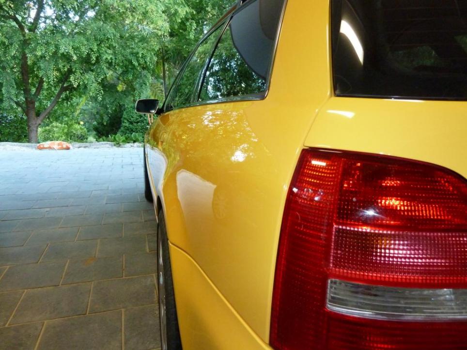

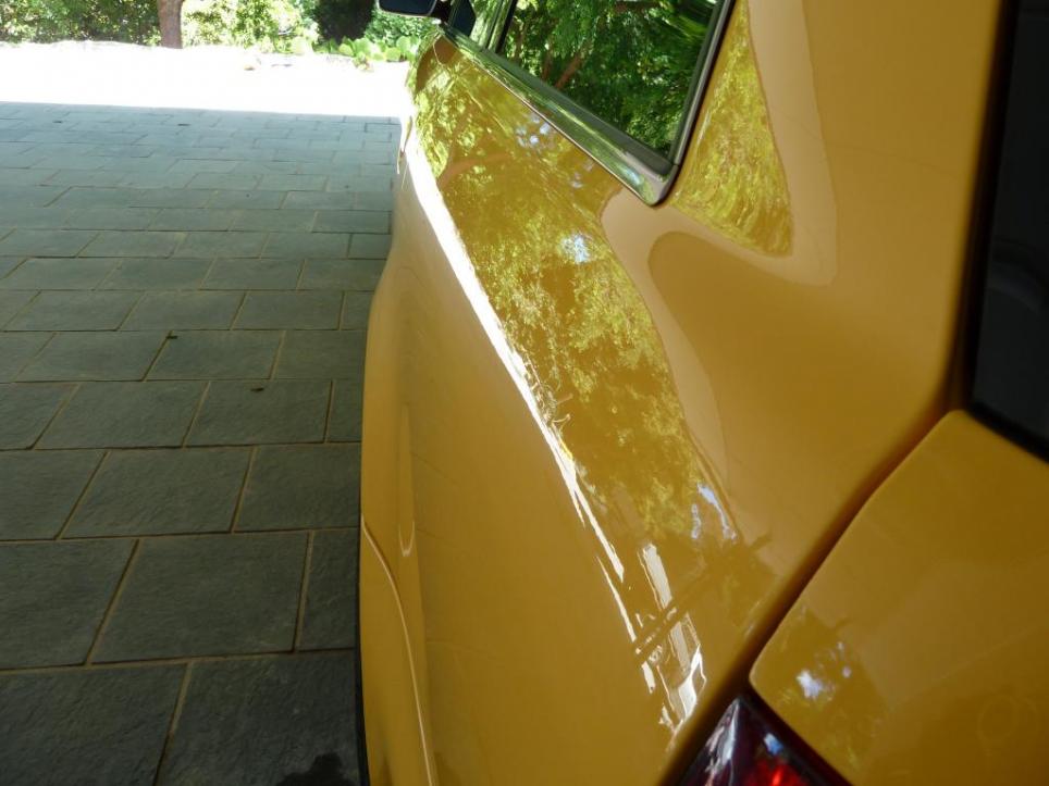

            Its a bit hard to see much in the pics, but I think it looks much better
            2 coats of Z5+ZFX, 1 coat of Z2+ZFX, wiped down with Z6
            before
            after
            before
            after
